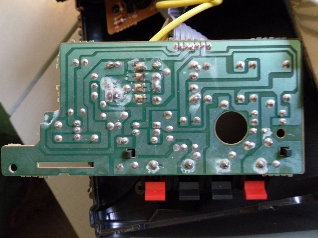

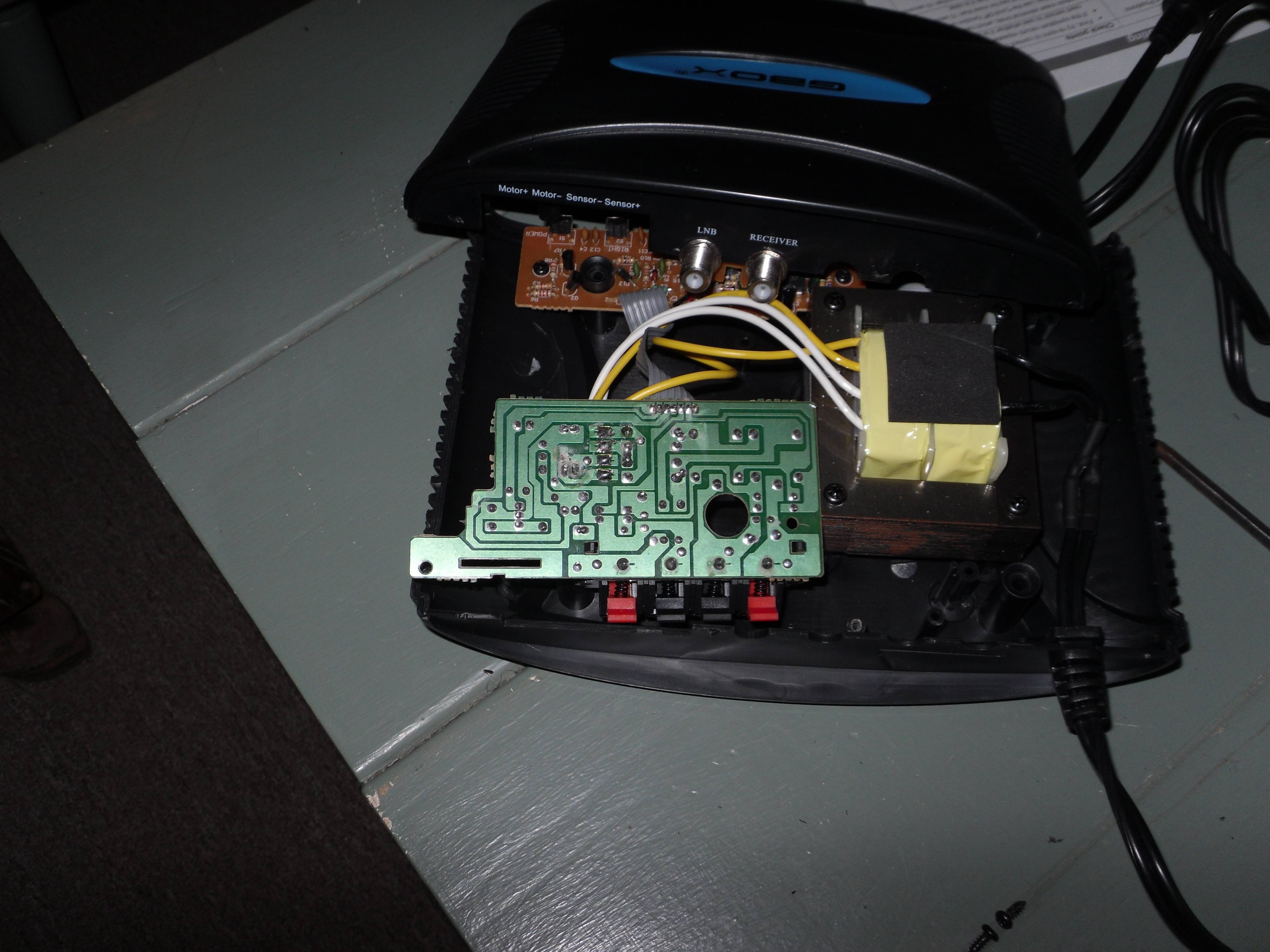

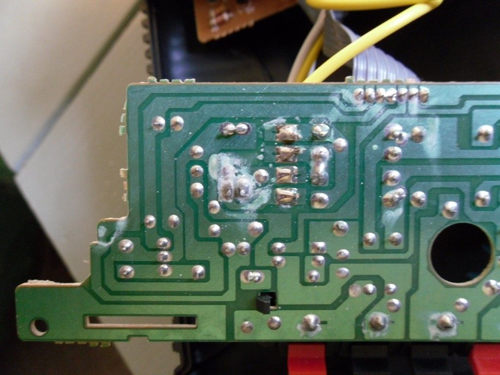

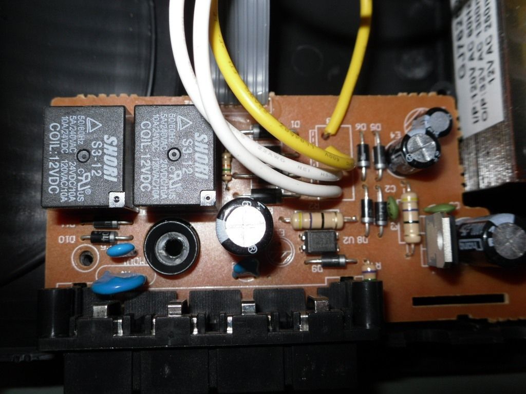

Bought a refurb Gbox in early May for my BV...and never got around to hooking it up...well this week I did...and....it won't count. Bargain bin stuff has a 15 day return...so being out of luck on that I decided to crack the case....yikes...I think I see why they returned it...should there be discoloration all over the board like that?

Just looks like some left over flux. Sometimes some of the conponents have heavier leeds and require them to be touched up with a soldering iron if they don't get soldered properly, or the factory has people soldering some of the parts on by hand. A little flux remover should remove the left over flux. That little bit of leftover flux should not stop it from working. You need to look for any leeds that are loose and not properly soldered.
I opened mine up in May because I was getting the e2 error. Mine looked the
same as your. I never found what I was looking for, something is making my
pulse signal voltage run at 20volts and not the 5volts it should be. I stopped
the E2 buy flattening out the motor and pulse wires with pliers.

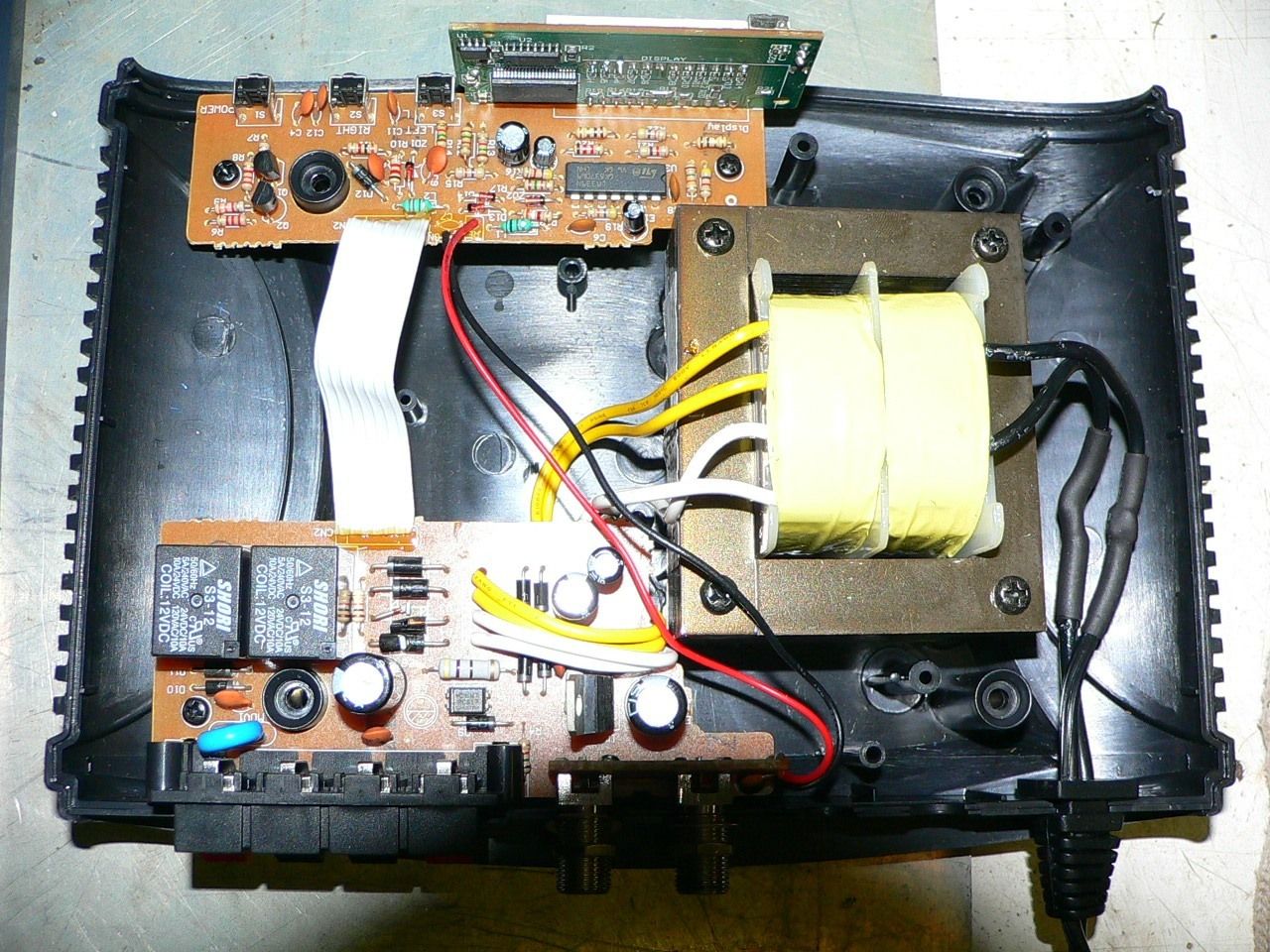

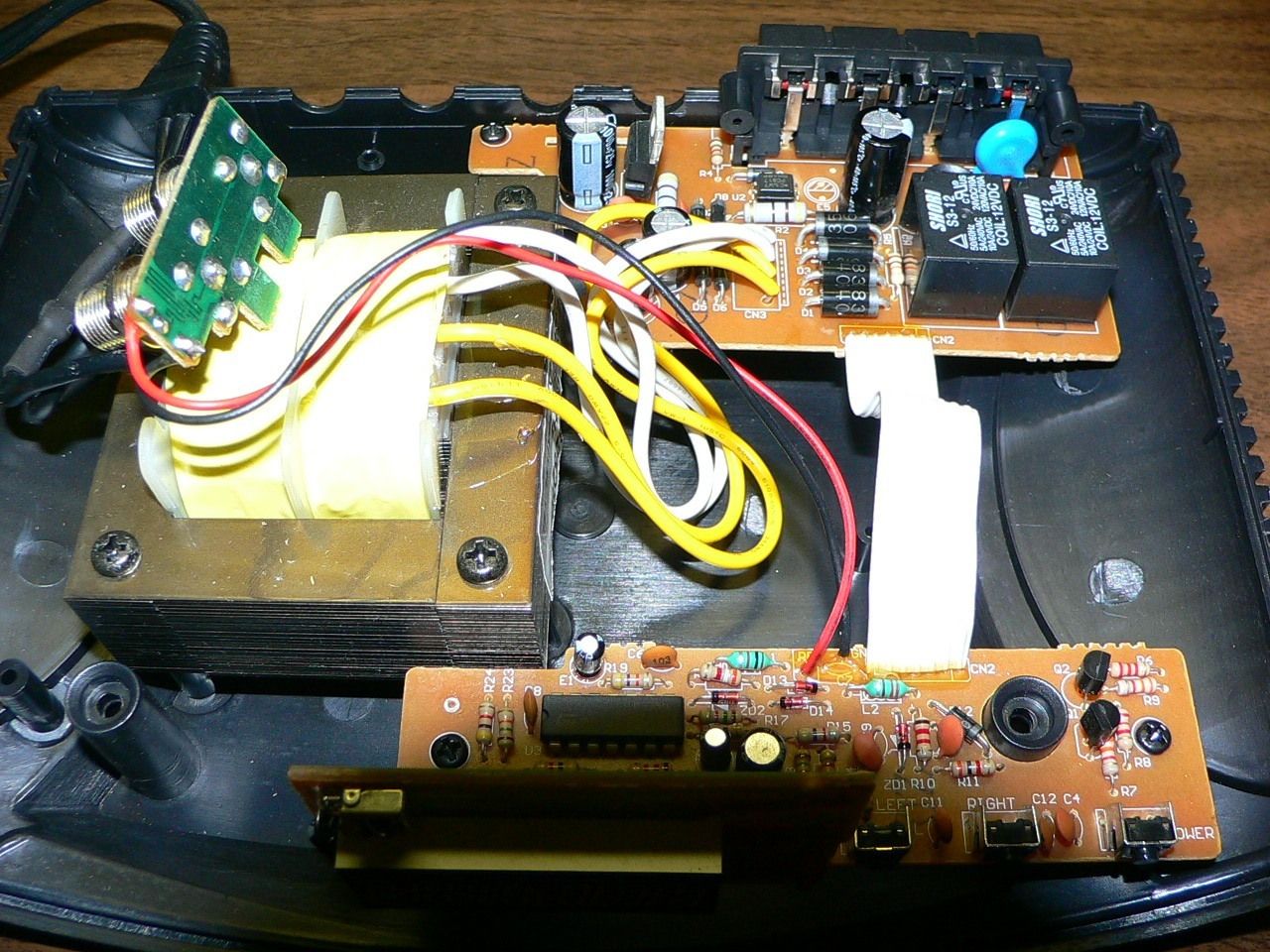

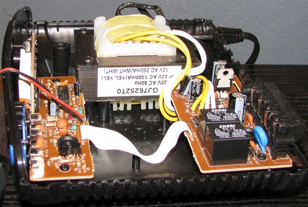

stogie, I didn't get any pics of the underside of my PC boards but here's some of the top side of my G-Box guts, before and after replacing the regulator diodes (aka "fuses") ;).

I have worked in electronics for over 20 yrs now in a high tech electronic production plant as a Techncian and from what i can see from the pics is that some parts had been touched up and the board wasnt cleaned correctly.We have a strong policy about good soldering and all boards must be clean with no solder flux showing or connections in time will start to become unreliable and start breaking down.PS!Most of my FTA setups have been from Sadoun and he will try to make things right if something goes wrong.
