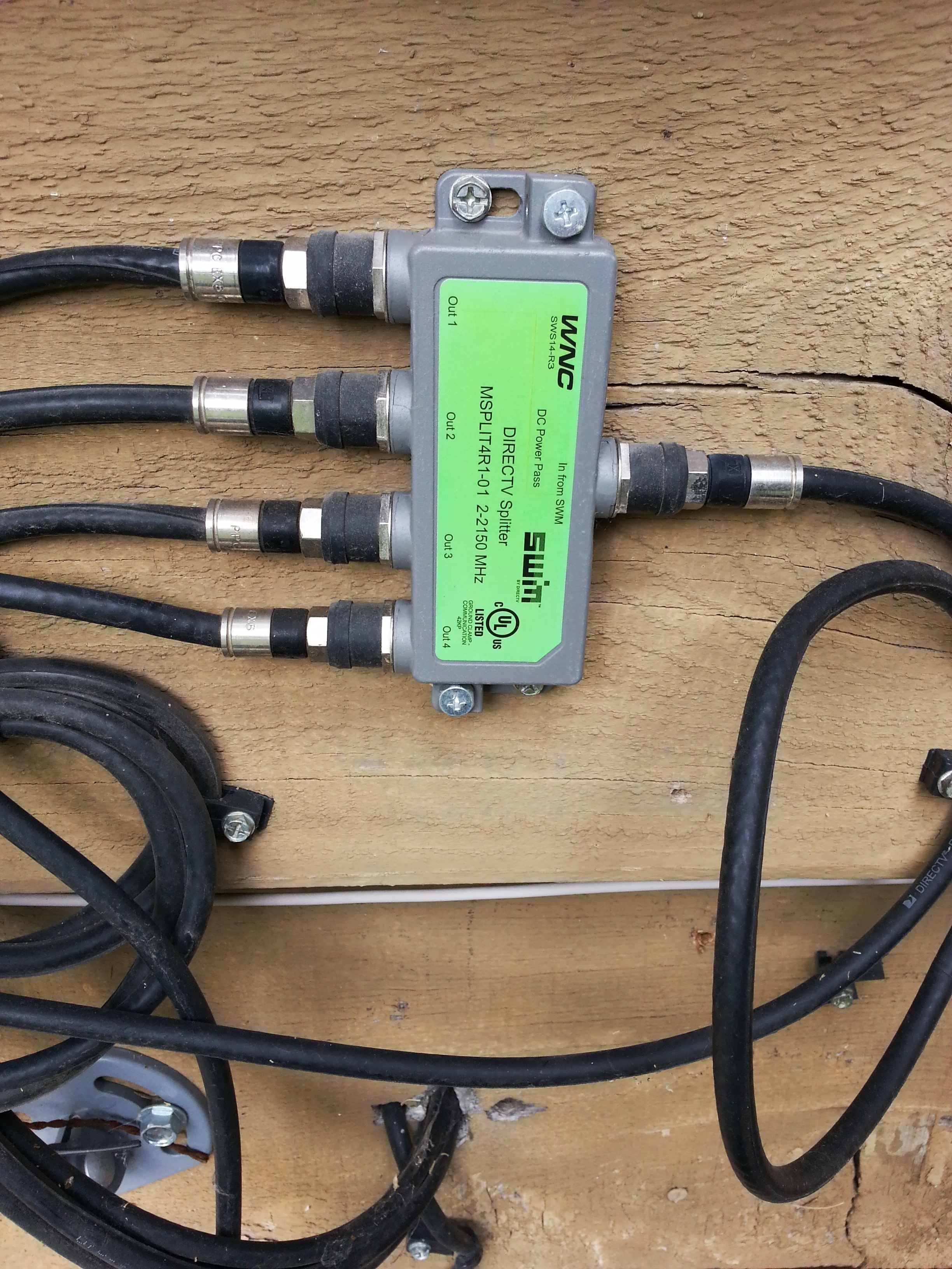

Ok, sorry for the confusion guys. The pic below shows the device I was referring to that is mounted on the outside of the house. One cable from the actual dish goes into this, and then the 4 going out of it and into the house go to each of the DVR's. Hope this makes more sense.
Thanks for the update CEV. This means you do have a swm lnb. Assuming you are keeping the 4 dvrs, you will need a new lnb. You will also need three new cables from the dish to a swm16 multiswitch. Then there will be one new line to the Genie and one to the setup in the picture you just posted.
I'll be keeping 3 of the DVR's and the Genie will be replacing the 4th. So sounds like more cables will need to go through the exterior wall of the house?
I don't think so. Three of the four dvrs will connect the same as they are now, except the splitter will connect to the swm16 instead of straight to the lnb. The Genie will connect with the now unused cable from the deleted dvr, straight to the swm16. The installer may need to extend the cable for the Genie, but that should be it.
