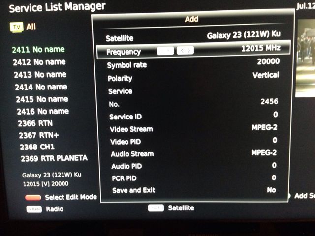

Yes, you may manually add a TV or Radio service via PIDs. Love where it is located. In the channel list edit screen! No that makes too much sense! :D
