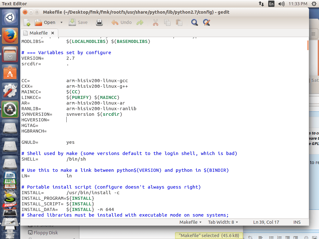

The source code is on the receiver, [most of it] but that is only a part of what is needed to compile correctly. Here is a portion of the makefile from off of the receiver, but you also need access to other things, SVN, toolchains, etc. I do have the original source code for the receiver too. Not Eugene's, the one from the manufacturer.
Makefile-2015-10-24 23:33:58.png
The arm-hisiv200-Linux is a bit of a pita to me and without access to the proper toolchain and such that built what is in the receiver, it limits you severely in what you can do. I scrapped Eugene's firmware and have been building up one of my own, but it isn't 100% yet. I am by no means a expert on satellite stuff, the opposite, so a lot has been a learning experience for me. I do have a working editor, the receiver works good and when I get it in my head that I don't like something, I change it. The Hi3712 SOC does simplify things a lot.

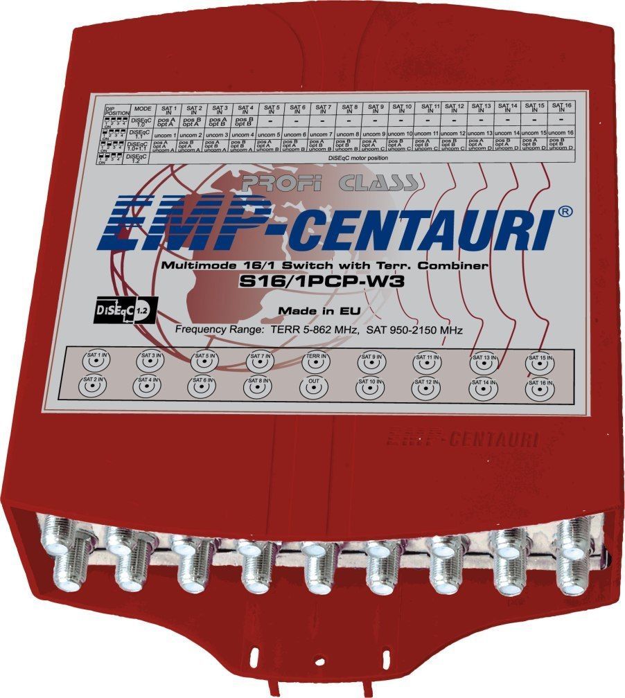

Does anybody know if this is compatible with the HDVR3500 and if it will work in the USA?
16x1 Satellite DiSEqC switch S16/1PCP-W3

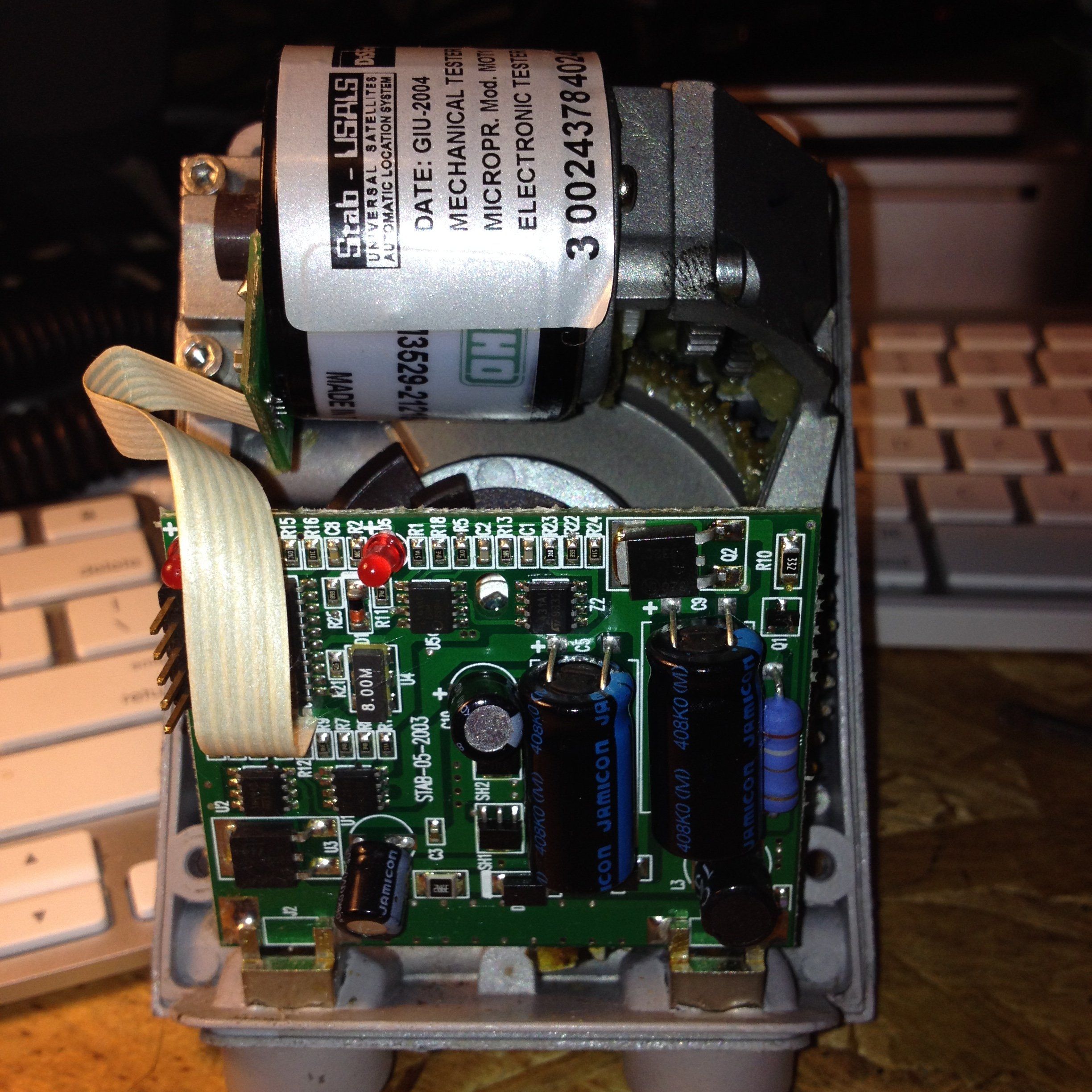

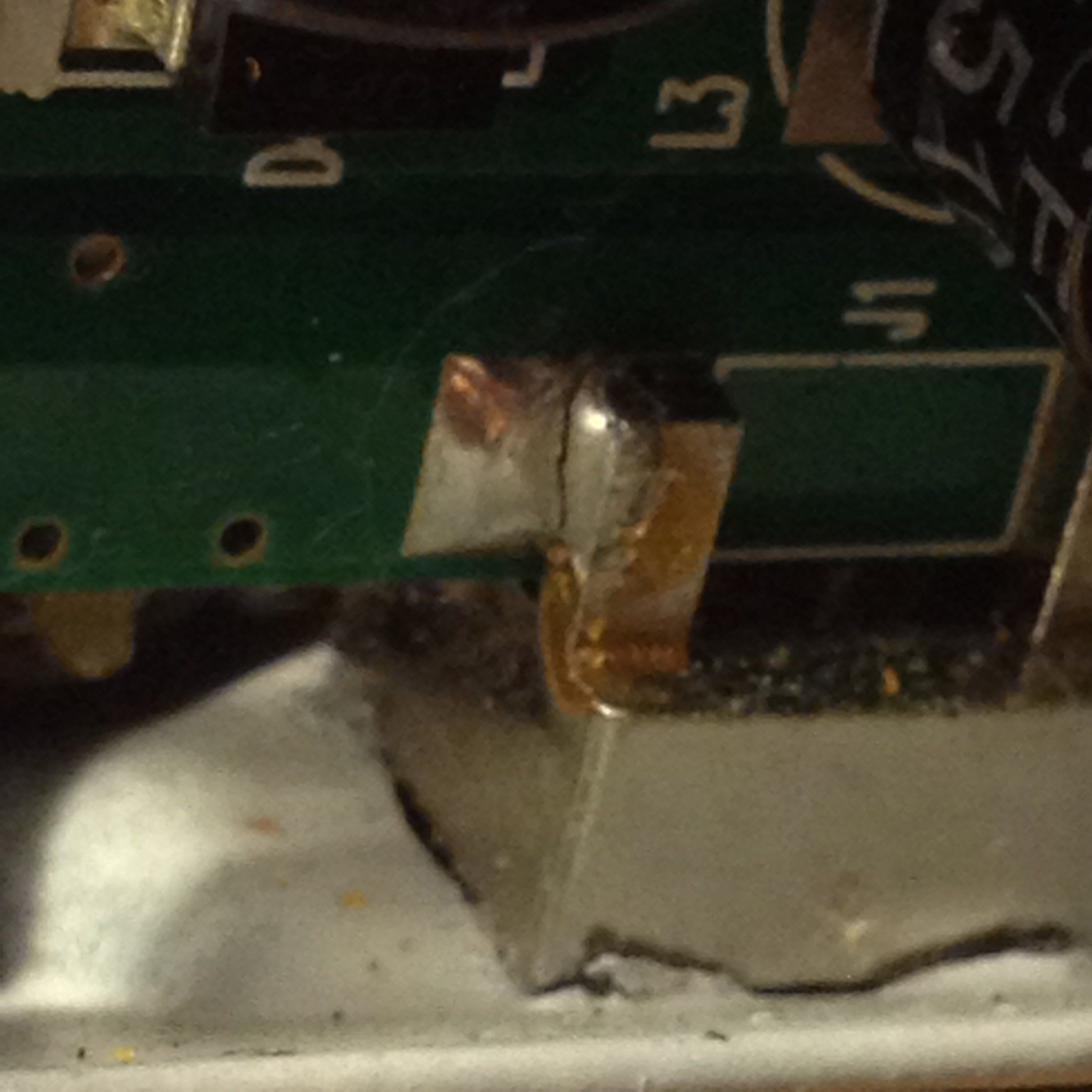

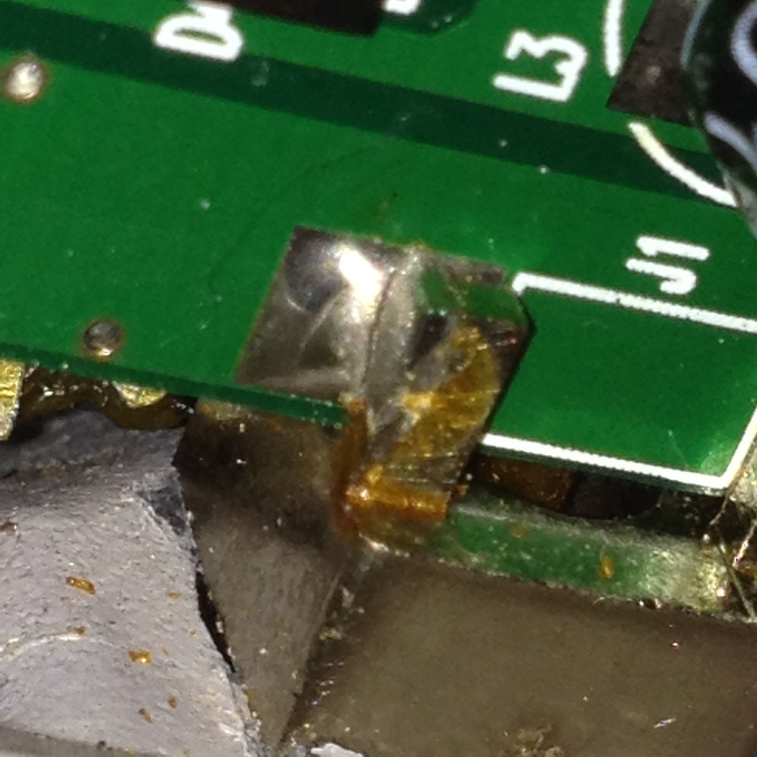

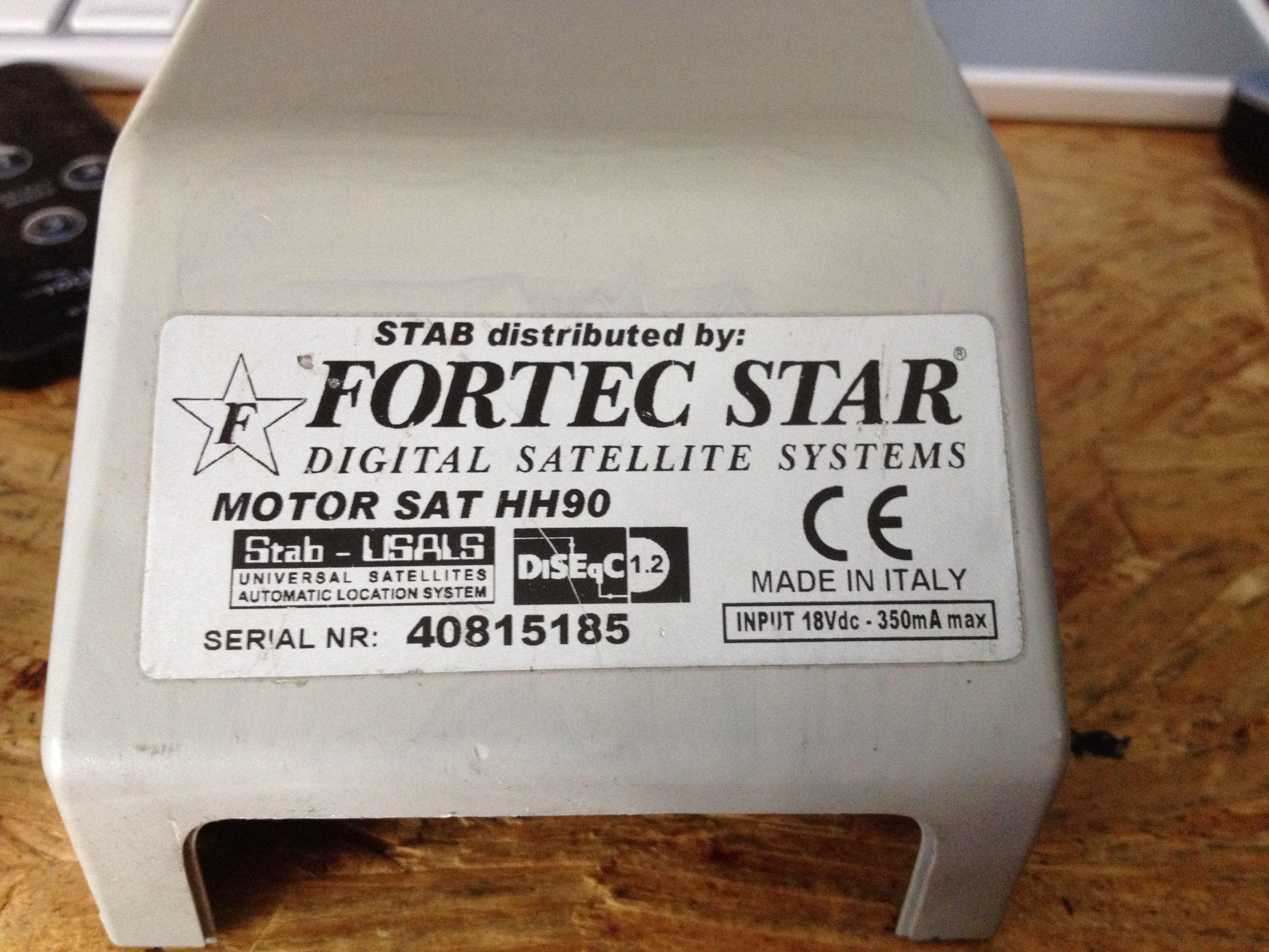

OK, after several attempts to get my motor working again, I have given up. I've reset the receiver, re-loaded the firmware, re-loaded my last known working backup. I swapped the power supply, with the one from the MicroHD, which had the same specs, and all it will do is either go all the way East or all the way West and stop. Does not move at all with DiSEqC 1.2. It's an old Fortec Star model, and doesn't have any buttons or a way that I could find to reset at the motor itself, so I'm assuming the motor is basically dead. No problem with power to the LNBFs, I have 6 connected with an 8x1 DiSEqC 1.1 switch at the moment.
I'm wondering if this receiver can support 2 or more 8x1 switches, and do I use a 22K switch to switch between them, if only using 2, or can I use a DiSEqC 1.0 4x1 switch, and use port 1 & port 2 for each, with the possibility of adding another 8x1 in the future. If so, I'm assuming I'd choose the DiSEqC 1.0/1.1 mode, and set the ports accordingly. Of course I noticed it has A, B, C, D for DiSEqC 1.0 instead of 1, 2, 3, 4 like my DiSEqC 4x1 is labeled. Am I on the right track here?
I think I may have found the problem with my motor. I noticed a hairline crack in the solder on the jack coming from the LNB, so I'm going to try and re-solder both jacks, and see what happens... Looks like it's a 2004 model, so it's lived a long life...
