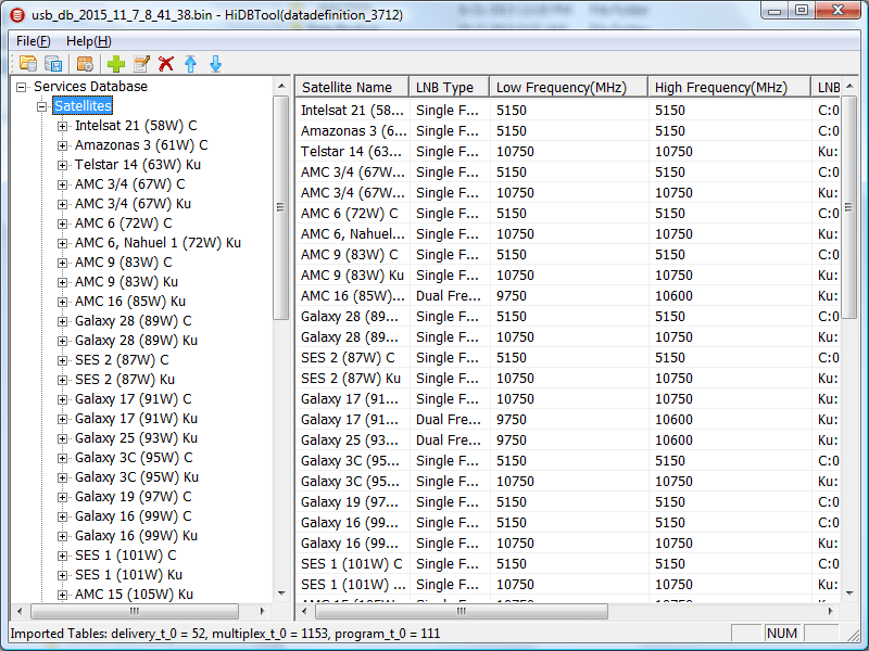

This is what is on my USB Key after editing from the computer editor and I can't get anything loaded into the 3500 using USB data transfer Manager in the Menu. Please help. Thanks.
Do you just remove USB sticks and external hard drivers USB's? Or is there a way to safety remove these in the menu somewhere? Thanks.
Just remove it. It is recommended not to remove if the file is playing or if the recording is on. The file played or recorded may get corrupted.
Please use external drive. Export from channel manager to the external drive and use Menu > Manager > Data Download from USB storage - and select the external drive.
If Windows computer is on the network, you can map your HDVR3500 from Windows Explorer and save the file directly to internal drive.
