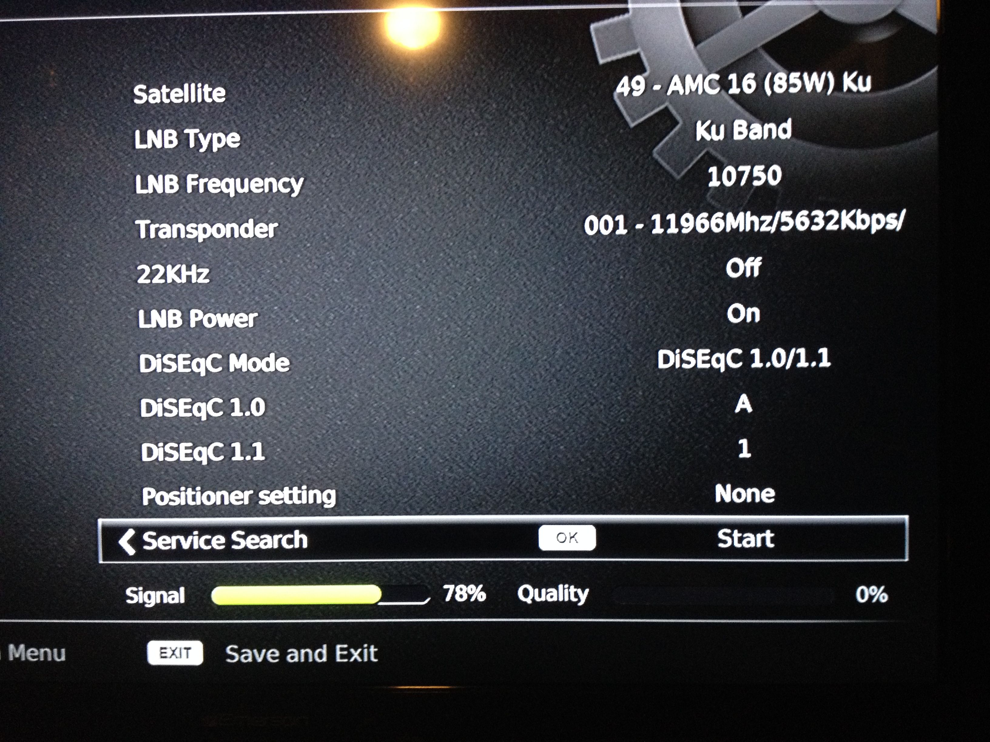

I'm assuming this is the settings I need to do cascading, DiSEqC mode 1.0/1.1, with the first 8x1 DiSEqC switch on Port A (or 1 as shown on my 4x1 DiSEqC switch), and the second 8x1 DiSEqC switch on Port B (or 2 as shown on my 4x1 DiSEqC switch), and set the 1.1 ports to match my 8x1 DiSEqC switches. Off this weekend, so time to play with the setup some more. Thanks for your help SatelliteAV:thumbup
You can use 22Khz switch and two 8x1 switches. You can also use 16x1 switch that we discussed. I will do additional post on the 16x1 DiSeqC switch.
I wasn't able to use a 22k switch, would not work properly, maybe related to a similar issue as someone else reported with 22k switches? But using a 4x1 with an 8x1 on ports A & B (or 1 & 2) works, with the settings in the receiver as DiSEqC mode 1.0/1.1. But I would be interested in just using a 16x1 switch instead...
