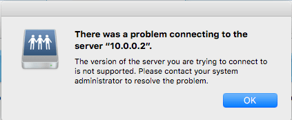

I'm on 10.10, none of the searches I tried worked out. Luckily I was already running vagrant for web development work. I downloaded a testing snap shot of Windows XP, spun it up and I can connect that way for now.

Yes I know mac supports SMB, my comment said "evidently the box doesn't support SMB". The satellite box doesn't seem to support it. It just comes back with an error that it's the wrong version trying to connect to the box. So it is connecting and communicating but fails to make a connection.
I am not exclusively Mac, but for the record all my current workstations are OSX. So we are planning to address that. Also, we are working on enabling additional protocols on the receiver, hopefully that will help. I will post an update here. But for now, Happy New Lunar Year!

The latest is 10.11, and so far it will not connect, I have the same problem as a Mac user... the only way I could connect was to install VirtualBox, then I installed Windows XP, and was able to connect that way...
