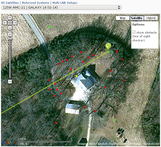

I also made a quick image using the map at DishPointer and an image editor.
http://www.rabbitears.info/screencaps/1-temp/Sat.png
(I'll be deleting this at some point.)
Indicated by the line on the map is 125W, lowest in the sky. The yellow dot is where the dish was in my pictures that I posted a few months ago, which is very near to where the coax needs to end. The red dots represent some of the nearest oak trees which are quite tall, except I think in one place I marked a shorter cedar tree by accident. (The nearest red dot due south of the green icon with the line to 125W.) It does not represent all of the oak trees in the forested areas. The green dots represent three places that look at least somewhat feasible. Each of them would likely require 200 feet of coax or more, I believe. The one behind the house I strongly suspect would need more than 200 feet. To get a frame of reference, I recall that there is about 180 feet of wire connecting the southern-most corner of the house to the corner of the barn, which you can see the shadow of and is just off-screen at the bottom.
I'm worried that the place indicated with the line might be looking into some of the trees, even though it seems like the best location as far as convenience goes.
What do you guys think?
- Trip
Satellites near true south won't be as much of an issue with line of sight, since they're higher in the sky. I would be concerned with the birds at the far ends of the arc. These are lower, and therefore the trees may interfere. Can't tell too much from the satellite photo, could you post point of view pics from the ground where your dish would be mounted?
It won't help you right now, but twice a year, spring and fall, the sun tracks your satellite arc. You can stand in spots where you are considering locating your dish and by using the time info on the website (which I do not have the link to) you can see the location of each visible sat in the arc, and can tell if you have clear line of sight to it.
As you have already seen, Dishpointer is a great tool, but if you don't know the height of your potential obstacles, it still leaves some guesswork.
I'll be getting home Friday and will take some pictures then. Just figured I'd try to get a jump on it with the satellite image.
I'm mostly worried about 125, which as you suggest, will be lowest in the sky. That's why I included the line for that one on the map.
I know that the more coax I use, the worse my loss will be, so I'm trying to figure out which one will be nearest while still working. I don't even know how much coax I can get away with before the reception degrades too severely.
Unfortunately, I don't know the exact heights of the trees, and I suspect that the most convenient placement will be looking through trees anyway. I'll likely need to get a protractor and stand at that point to see how high up I'm actually looking.
- Trip

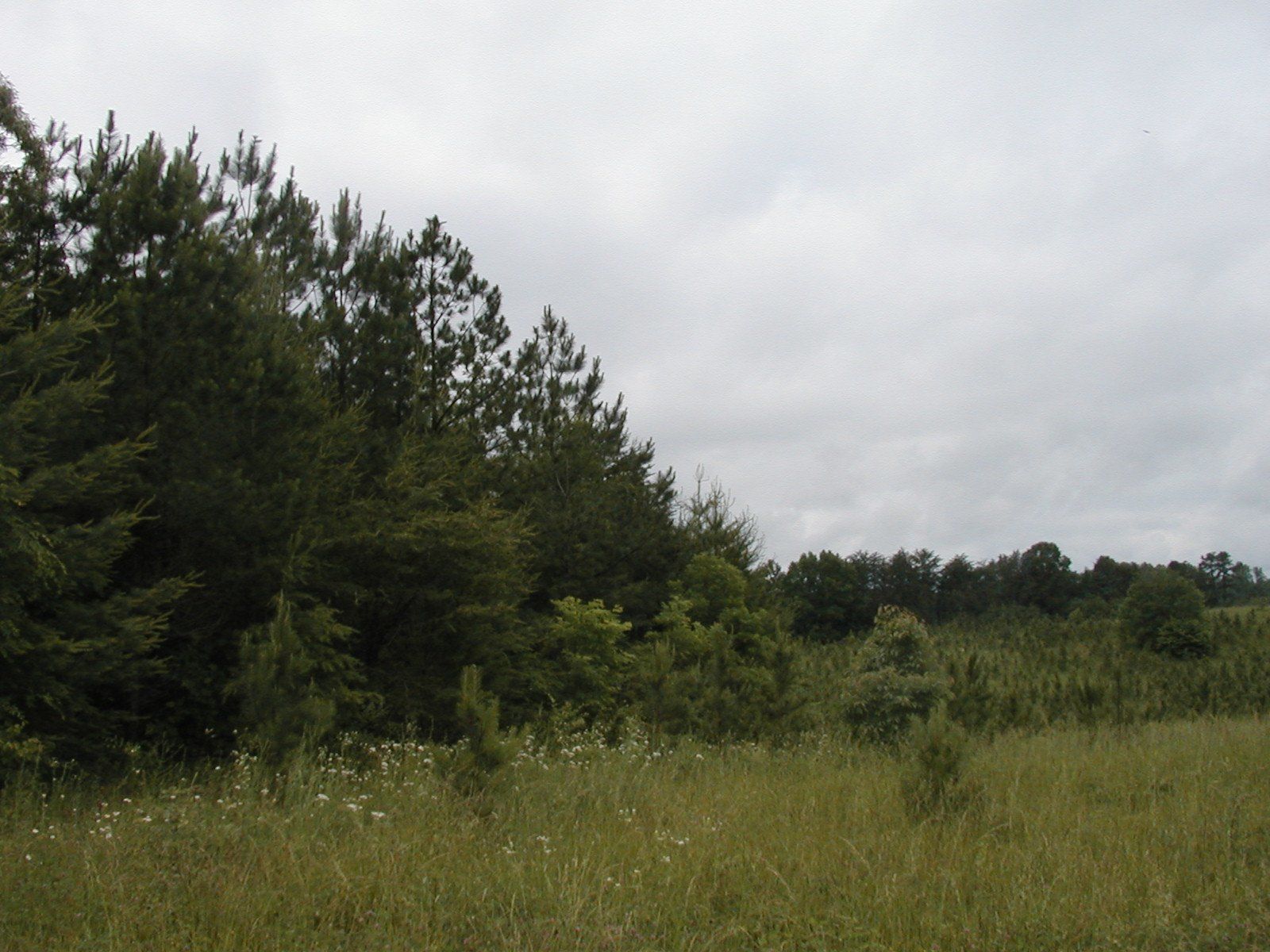

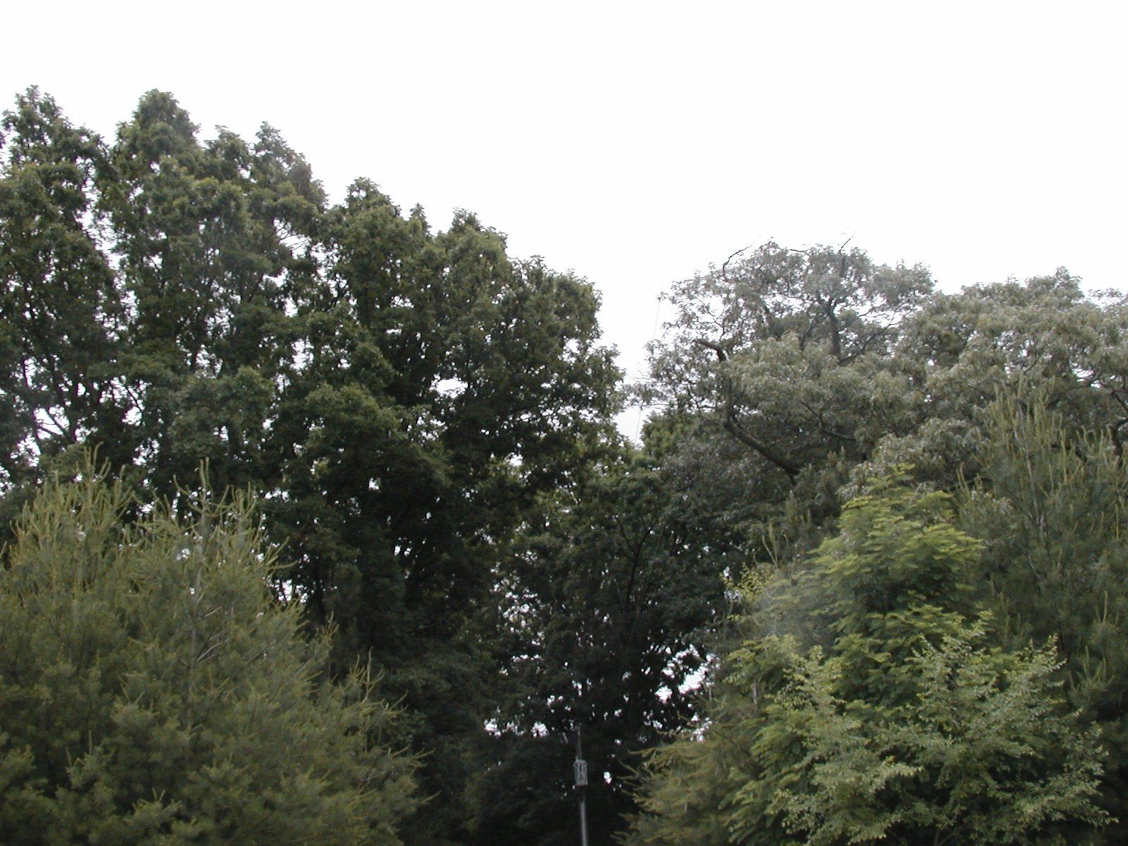

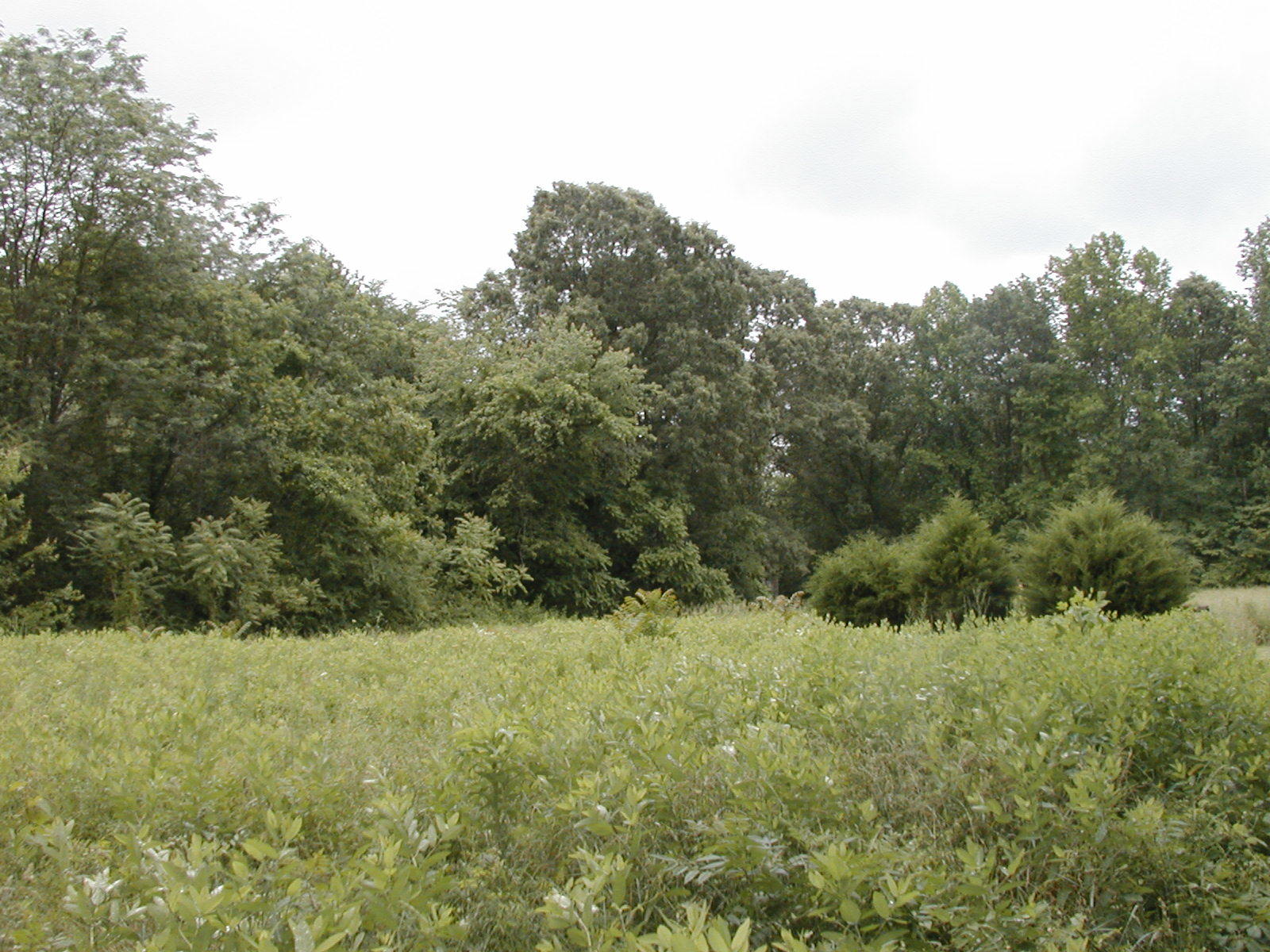

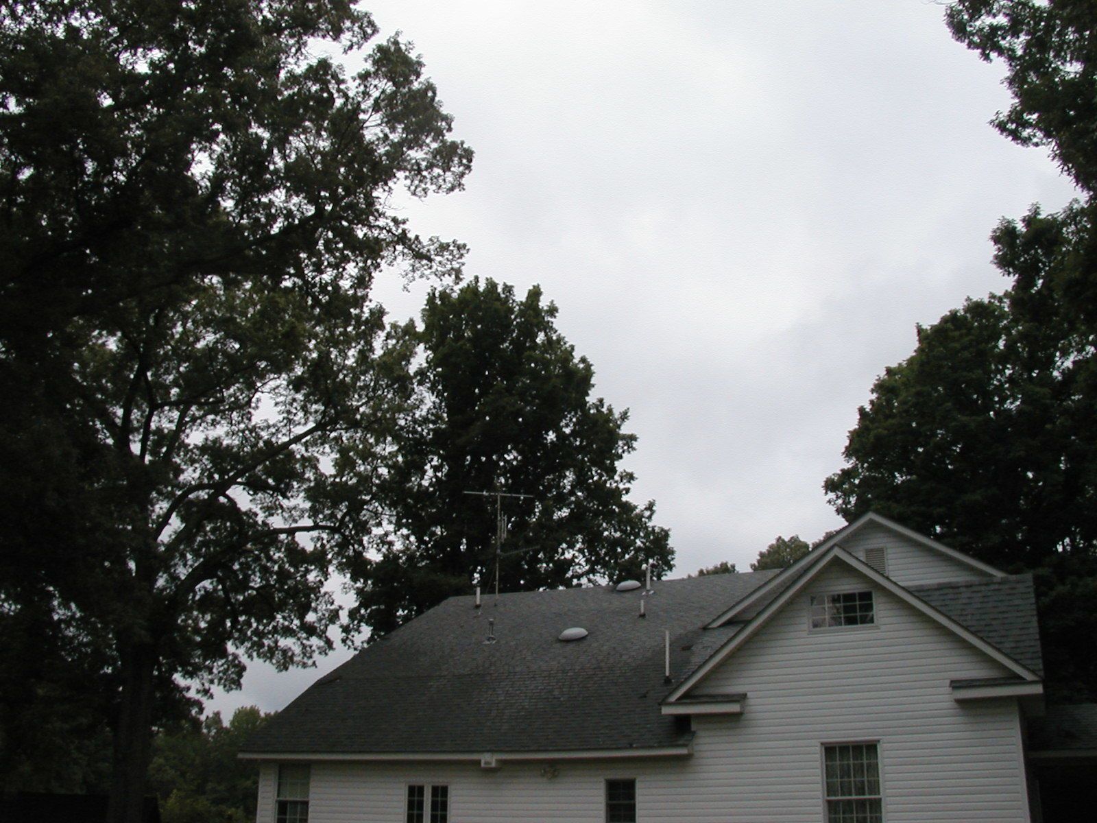

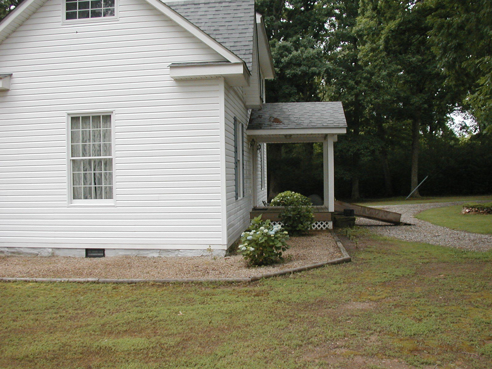

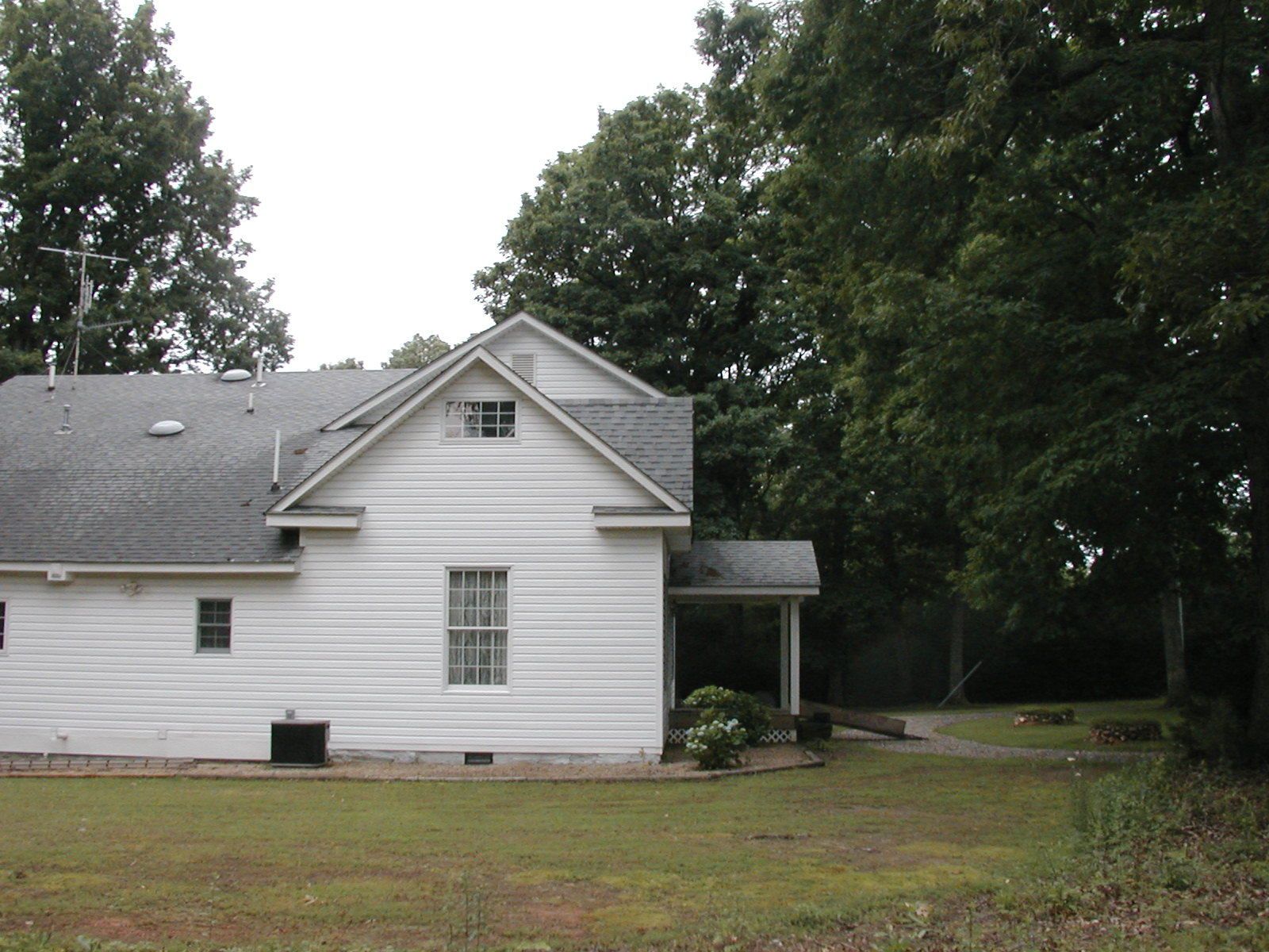

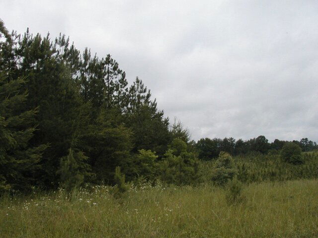

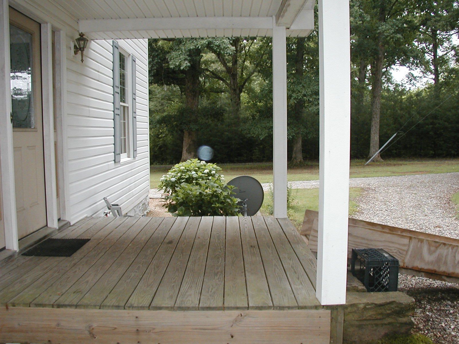

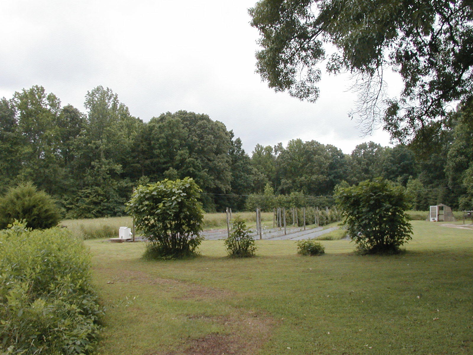

Okay, so I went and took a few pics. You'll find them attached.
5 is my current tree-blocked setup aimed at 97W, to give a frame of reference. 6 backs away to transition out while keeping the frame of reference, and 7 and 8 are standing at the spot in question. I suspect I'd be okay on 97W but I'm not sure how far east or west I'd be able to see. I don't think it's wide enough, regardless. I measured and I believe 100 feet of coax would get me from my bedroom out to the dish placement. On a nice day, I might break out an extension cord and see what I can see from there with the current setup.
9 and 10 are in the driveway in front of the house, near one of my other spots. 9 looks more west, 10 more south. The only problem is that I'd have to run a significantly longer coax, otherwise it looks like it could be workable. I'm not anxious to do this one though.
11 and 12 are from way behind the house. 200 feet of coax minimum. 11 is looking more south, 12 more west. Sadly, next to the right-most fig tree in 12 is a VERY nice view of the whole sky where I'm sure it would work, but I'd never be able to put it there because of how far it is, plus it would mean the addition of yet another obstacle for the riding mower.
Unfortunately, without any frame of reference, these pictures probably don't help much. I might just have to do the old guess and check method of finding a decent location.
- Trip

I've forgotten, do you have your motor already? If so, you could do what I did to survey locations before I chose a permanent place for my dish: fasten the wall mount (you have a wall mount, right?) to a plank (you may have to put it together upside-down / backwards), put the motor on the wall mount, and then use stones or wood pieces to shim up the plank til the mount is level. It should get you close enough to let you check out most if not all of the arc, assuming that your receiver has a decent USALS implementation. (I never used diseqc 1.2, so I can't help you there. All I know is, if the pole is plumb and if the angle scales on your dish and motor are good enough to let you find one satellite, I never had any huge problems setting up USALS on something other than the southmost satellite. If your signal drops as you get away from the one you aligned with and you KNOW you're not looking at a tree, adjust the dish elevation til you get locked on, then go back to where you started and see if you still have it there. If you've lost it, it means that something isn't level.)
trip, JImS has a good idea there. I was going to suggest a mobile mount in a bucket or something placed in your possible locations , take a tv and receiver out in the yard, to test which satellites you can find, without the motor for now. Once you get the hang of manually locating the sats, it wouldn't take long to check which ones you can "see". From pic 11,12 I think that would be a workable location, but looks can be deceiving. Remember the dish is receving at an angle that is higher than it 'appears' to be aimed. Congratulations on graduation!!
