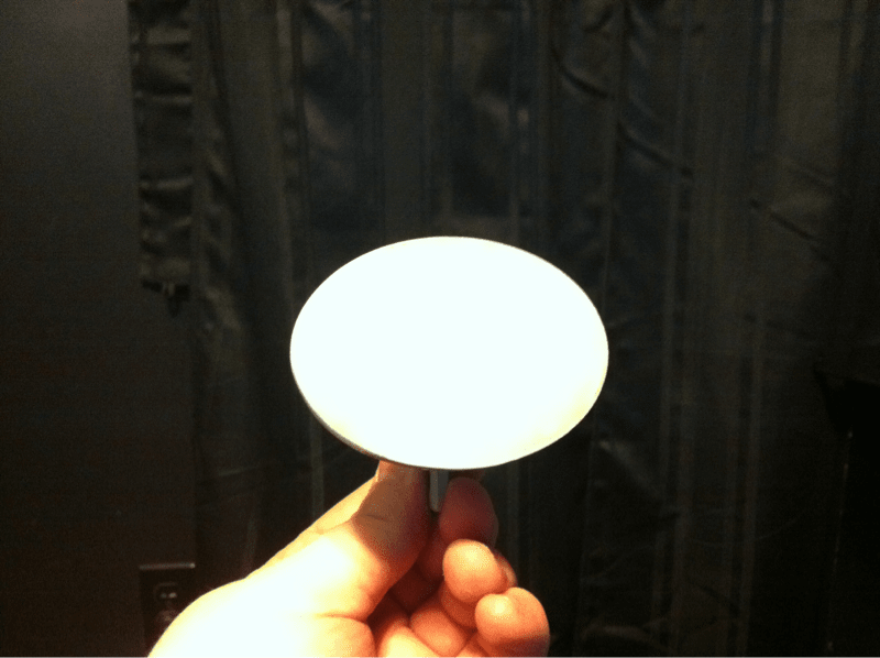

PS: you say the dish is elliptical... look directly into the feedhorn...
Is it round? Elliptical? Could you post a picture?

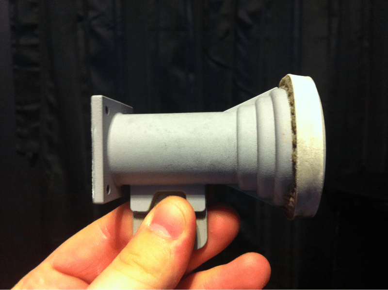

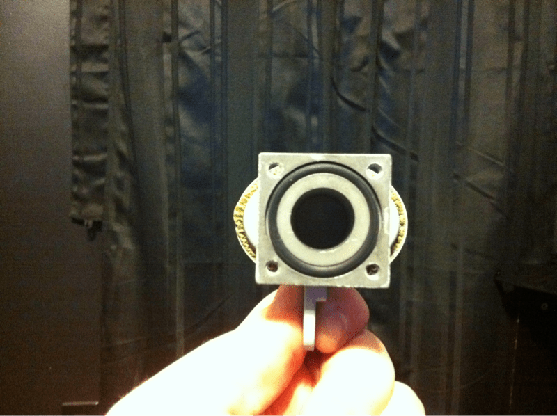

Cause, if the feed is round, then it treats the dish as round.
1. a round feedhorn will get by, at slightly reduced efficiency, so...
- you could mount any dual or quad output LNBF and try it.
2. you can remove the feed and mount it to another LNB
- Invacom LNBs are generally quite expensive (over $70) but would have two outputs
- a recycled FSS LNB from a DishNet SuperDish could be used, but it's bandstacked

I further inspected the Hughes lnb and it is elliptical but inside the feed it's circular. So my question is does it make the feed a elliptical or circular? If it is circular I'll just get me a dual output lnb and slap that baby on there... Lol

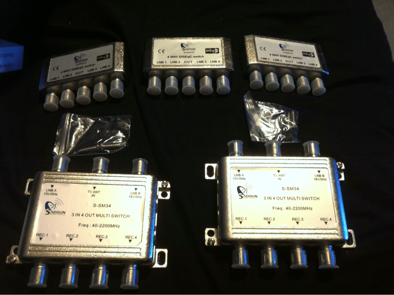

I do love it! Lol but it's not over yet. Still waiting on my switches from sadoun but so far so good! Thanks for the compliments guys. Haha, makes me feel like my first rodeo was a full ride. :up

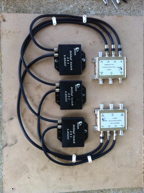

Switches are in and on the board, now to venture under the house and get it up and running... Whoohoo spider time!
