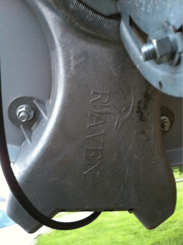

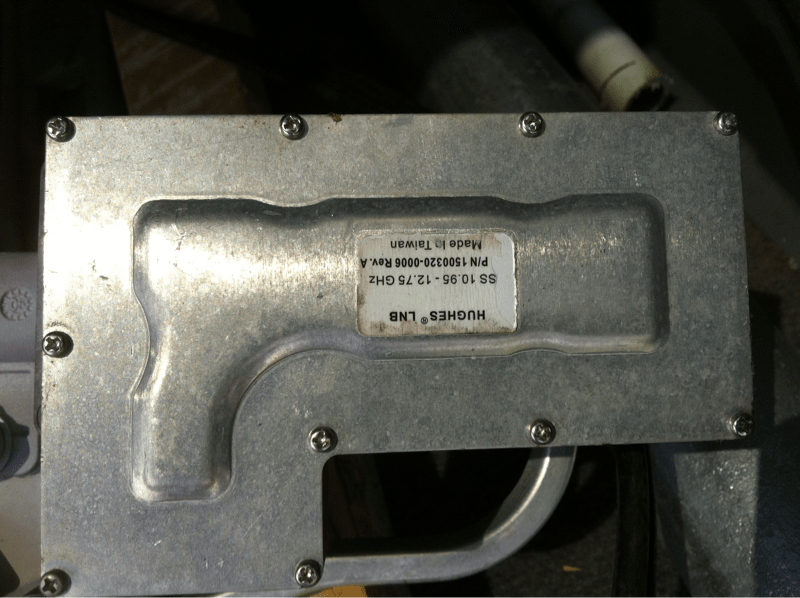

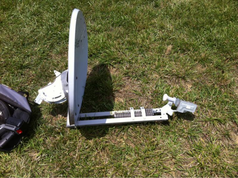

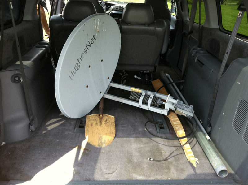

Got one dish so far! Couple more to look still... 1 for 2 this far... Pics! ( postin on my iPhone) can't figure out how to rotate the lnb pic.

Nice find.
It looks like the Hughesnet dish I have pointed at T12 15w. I am using the stock lnb works fine. Still has the transmit amp on it (not used for FTA)
Was gonna be my next question... Is if that was necessary to remove to function... Guess not tho. Thanks!

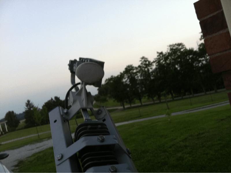

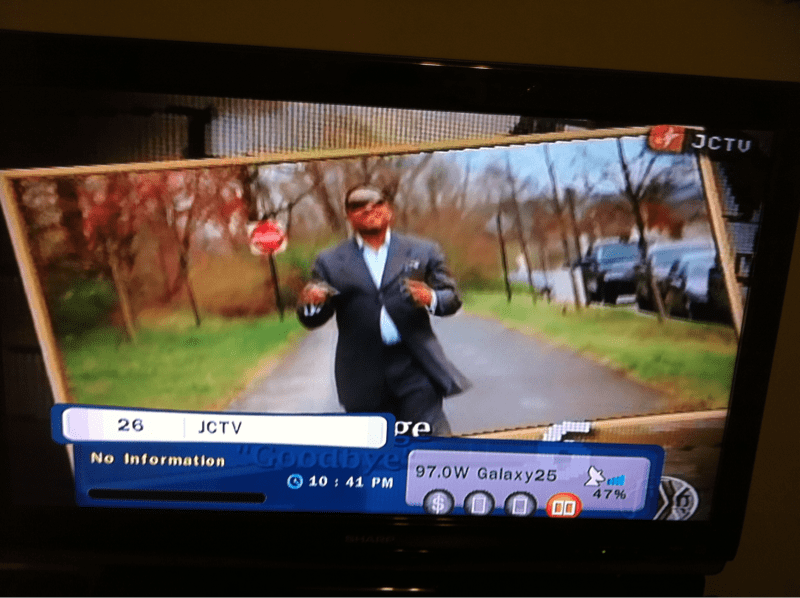

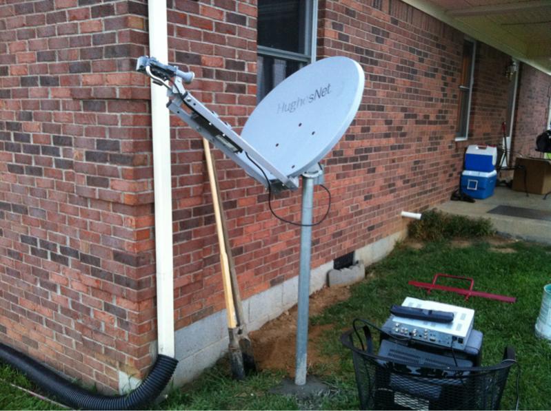

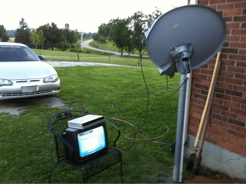

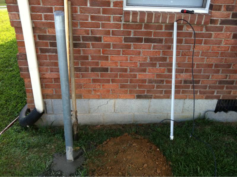

Here it is... Set in the ground and the first one aimed at 97w... What ya think?

That would be correct! And that included a trip to lowes for some concrete lol. :D
