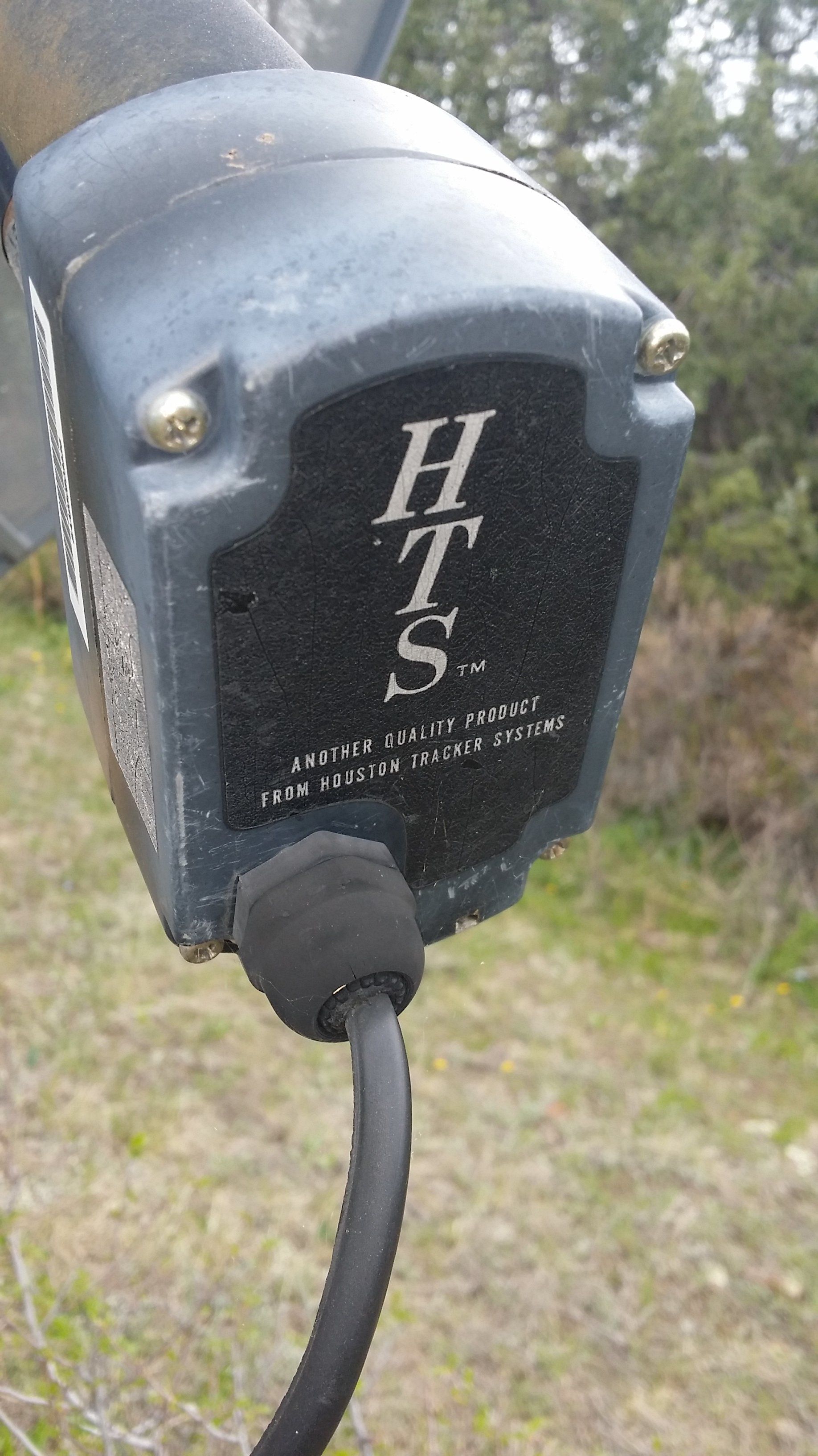

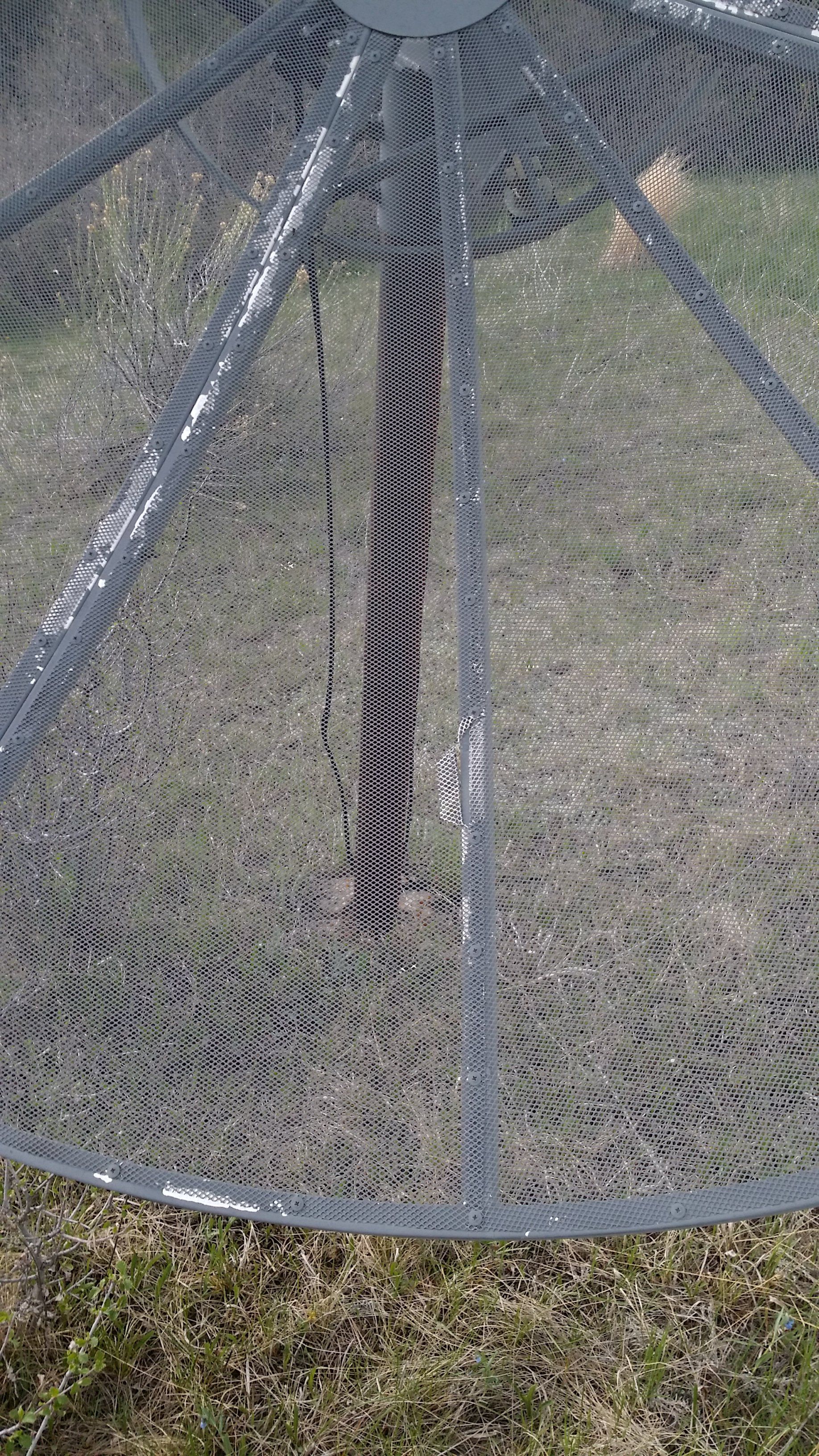

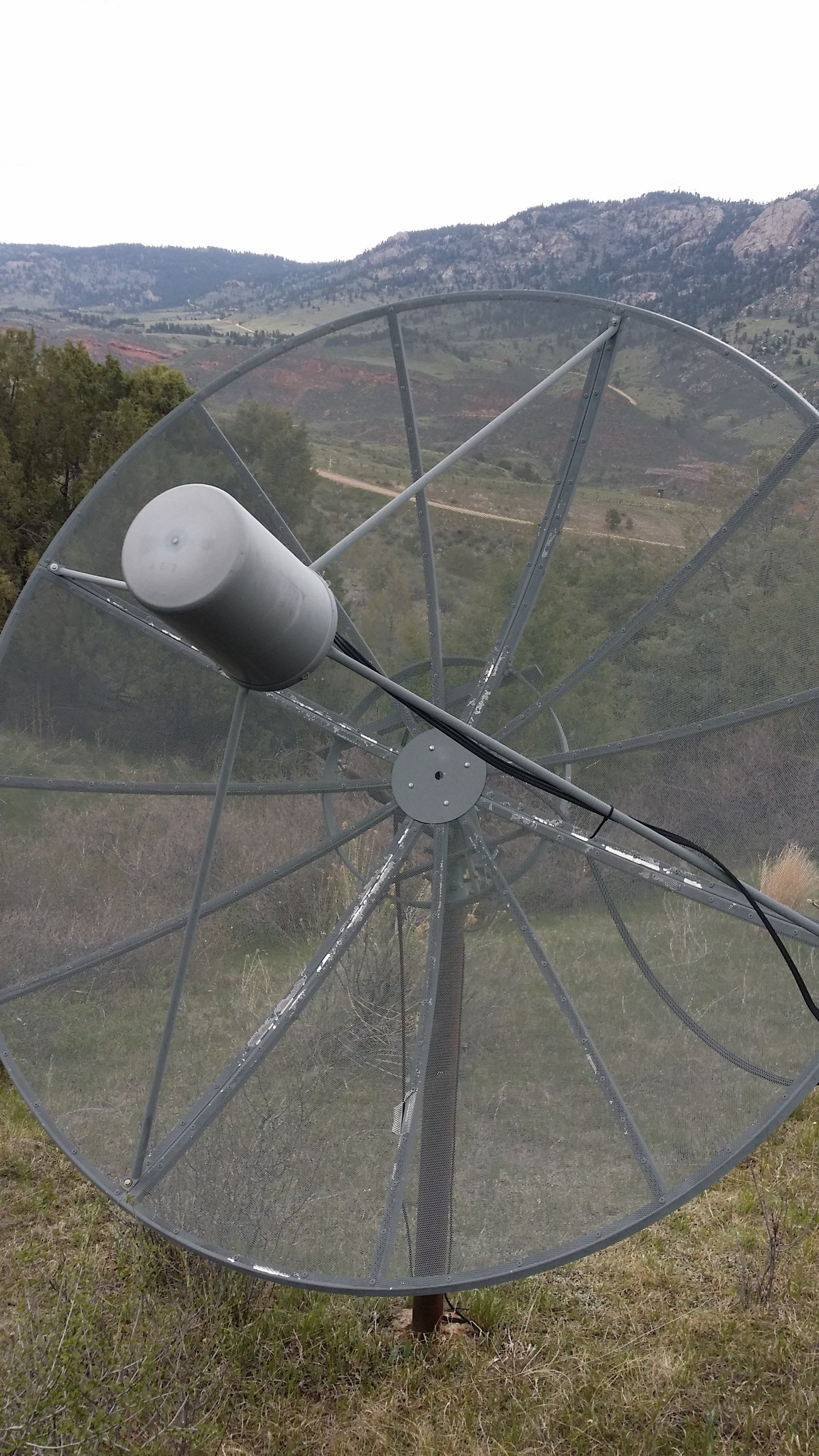

I found this yesterday. Looks like its in ok shape. the mesh is bent in one spot that can be bent back and a few dings from hail.
Let me know if you think its worth taking down.
Also found a fiberglass today a block away from my house.
I have room to set up a sat farm.
:welcome
Welcome to Satellite Guys!
I would get that dish.
What is the diameter?
Sort of looks like a 10 footer.
Is it a freebie?
If not how much are they asking?
That one little tear is no big deal.
Reactions: hank123
Free. Dude wants its gone. I may grab it Monday.
I contract for DirecTV so I run into cool stuff all the time people want to get rid of. We have a load of C band dishes in Colorado.
I think it is a 10 foot dish.

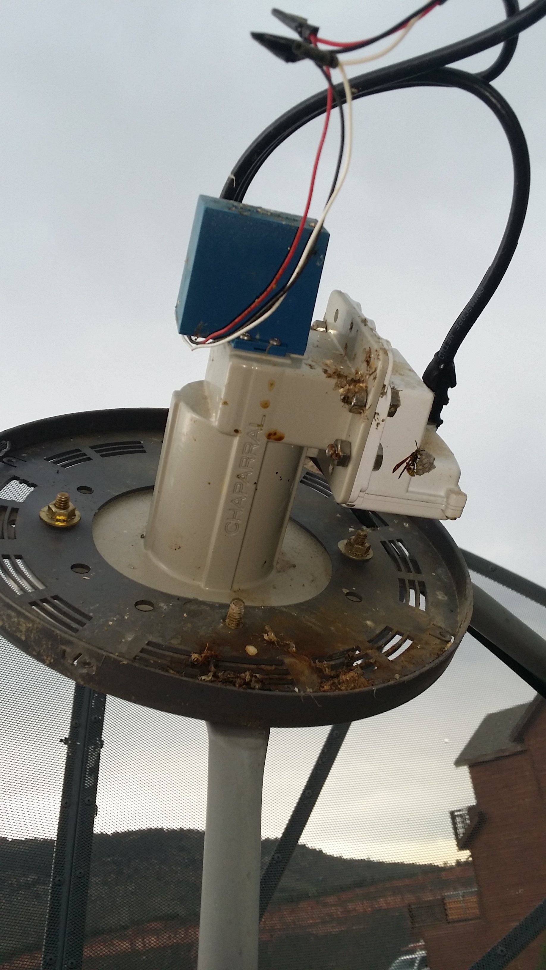

Hey, nice haul(s) C band ROCKS! You may want to replace that feed/lnb combination with a LNBF so you don't need another piece of equipment running the polarity servo. and a GBox to move the dish - OR get the Titanium Satellite ASC-1 which cane move the dish (with an actuator) AND operate the servo (all via the sat receivers remote)

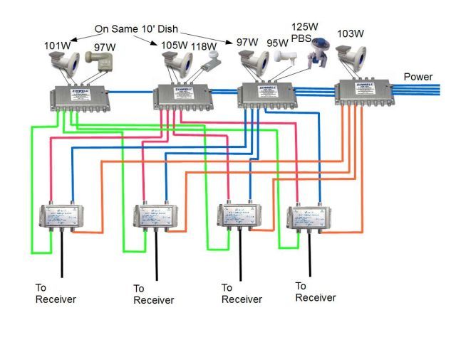

Am I able to use a 6x8 switch or a 4x8 powered switch? I plan on feeding 3 TVs in the house. I can fish dual cables to each location.
Give me an idea of what switch to look out for. As I said I come across all kinds of odd stuff.
I use these:
http://gotcband.com/collections/muli-switch/products/zinwell-sam-4803
And 4 port diseqc switches
My setup looks like this:
Old Picture with only 3 multiswitches installed.
To do multiple receivers, you pretty much have to use dual port LNBfs. One will be used for H polarities and the other for V. This way some TVs can watch H polarities on the same LNB while other TVs can watch V. As you can see there is an exception whereas on a sat all you care about is recieving a single polarity, like 125W or 95W CCTV channels show in the diagram.
Diseqc is used to select each Multiswitch and 22Khz tone is used to select the LNB ports on each Multiswitch. All my dishes, 2 c band and 4 Ku dishes are all stationary. I did this because of the multi-reciever setup and the wife did not want motors as she wanted all channels available at all TVs at all times.

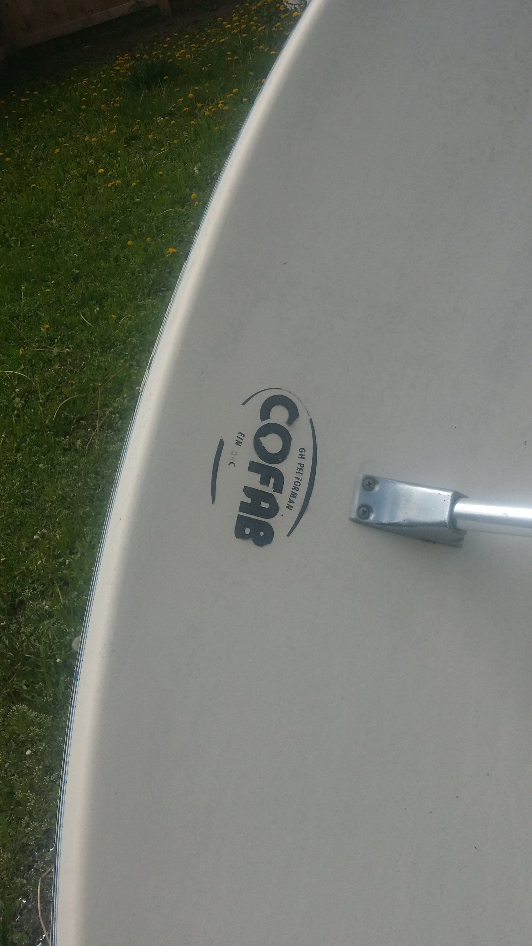

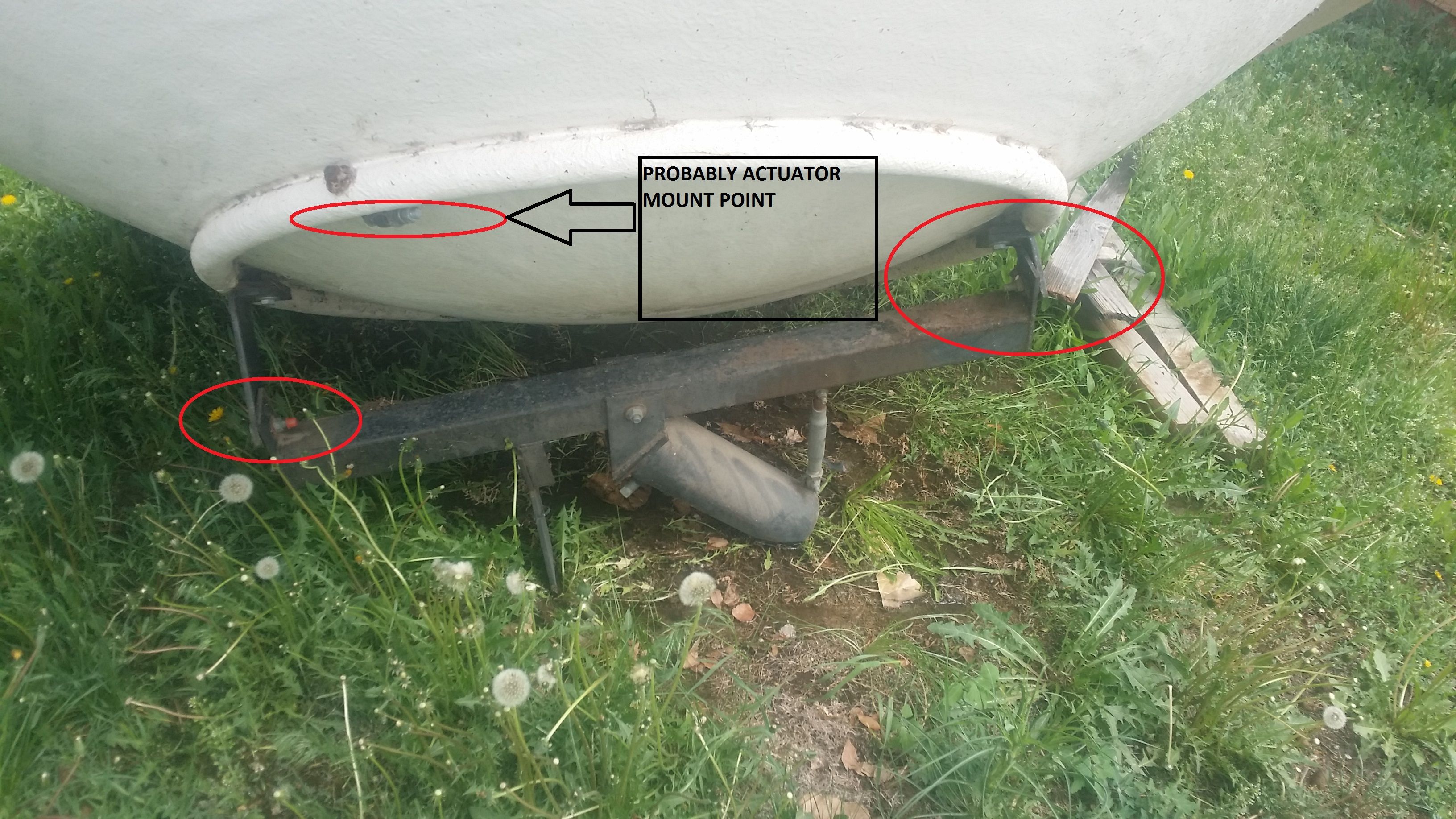

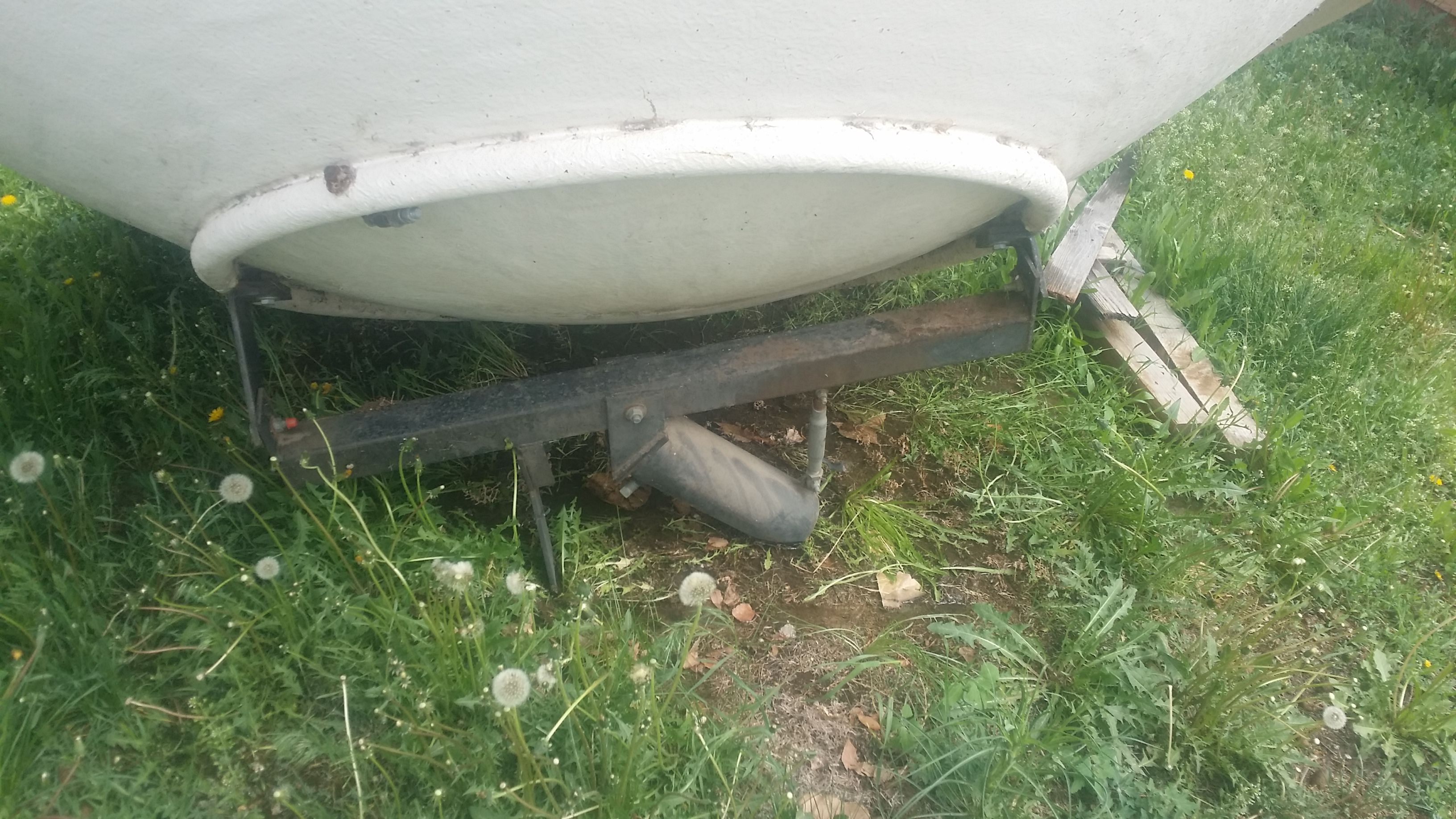

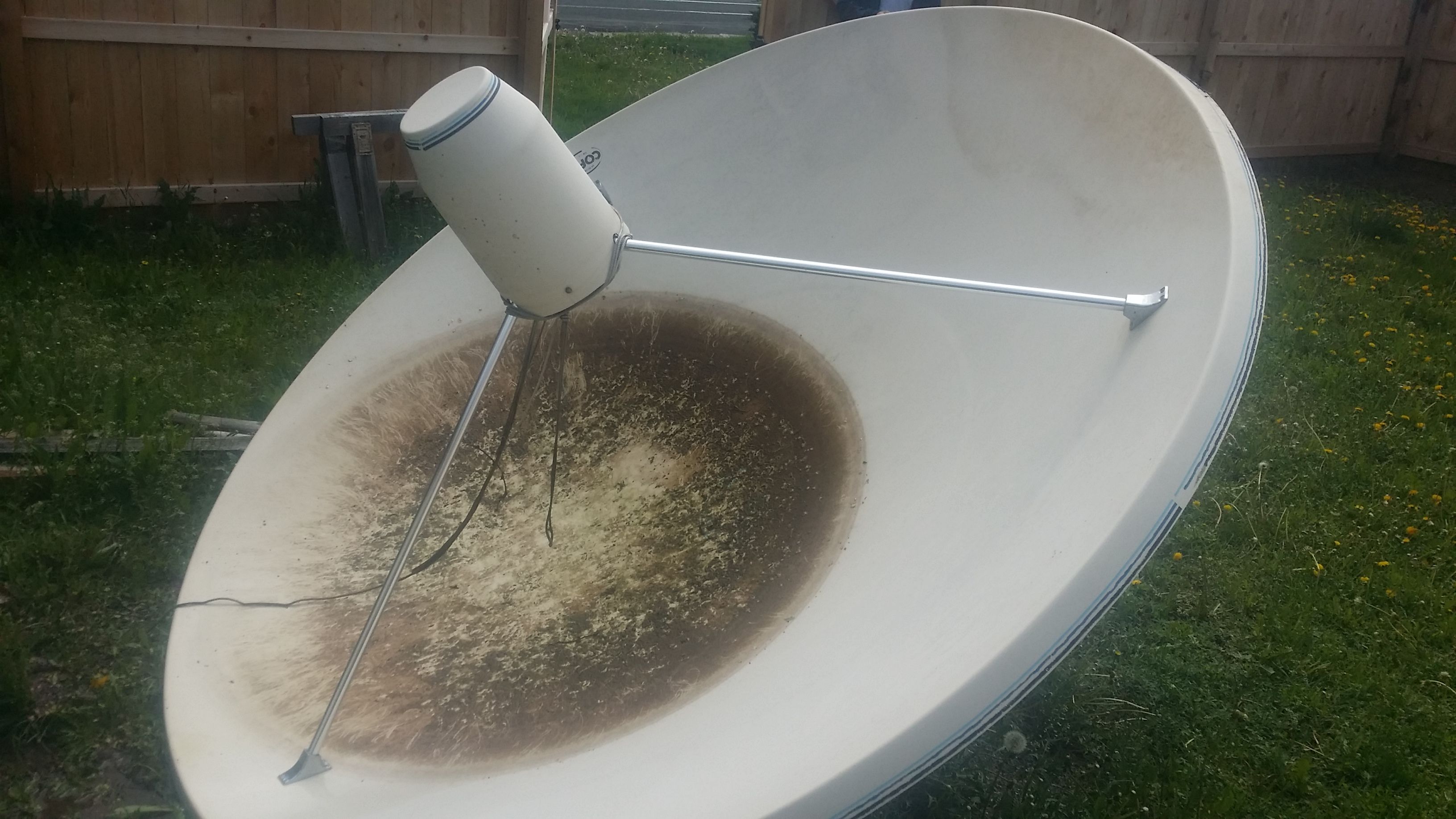

Got the 8 foot fiberglass today. Looks like a fixed mount. In the center I see a little ding but over all she looks in good shape!
What LNB should I get for her and where should I fix her to?
Welcome to the site Hank!!!!
I would get the Titanium C1-PLL. You can either get it from my store or direct from Titanium Satellite.
Where to aim it is a matter of preference and what you like. Also as things come and go in this hobby you will likely find your self moving it over time. :)

Got the 8 foot fiberglass today. Looks like a fixed mount. View attachment 116545

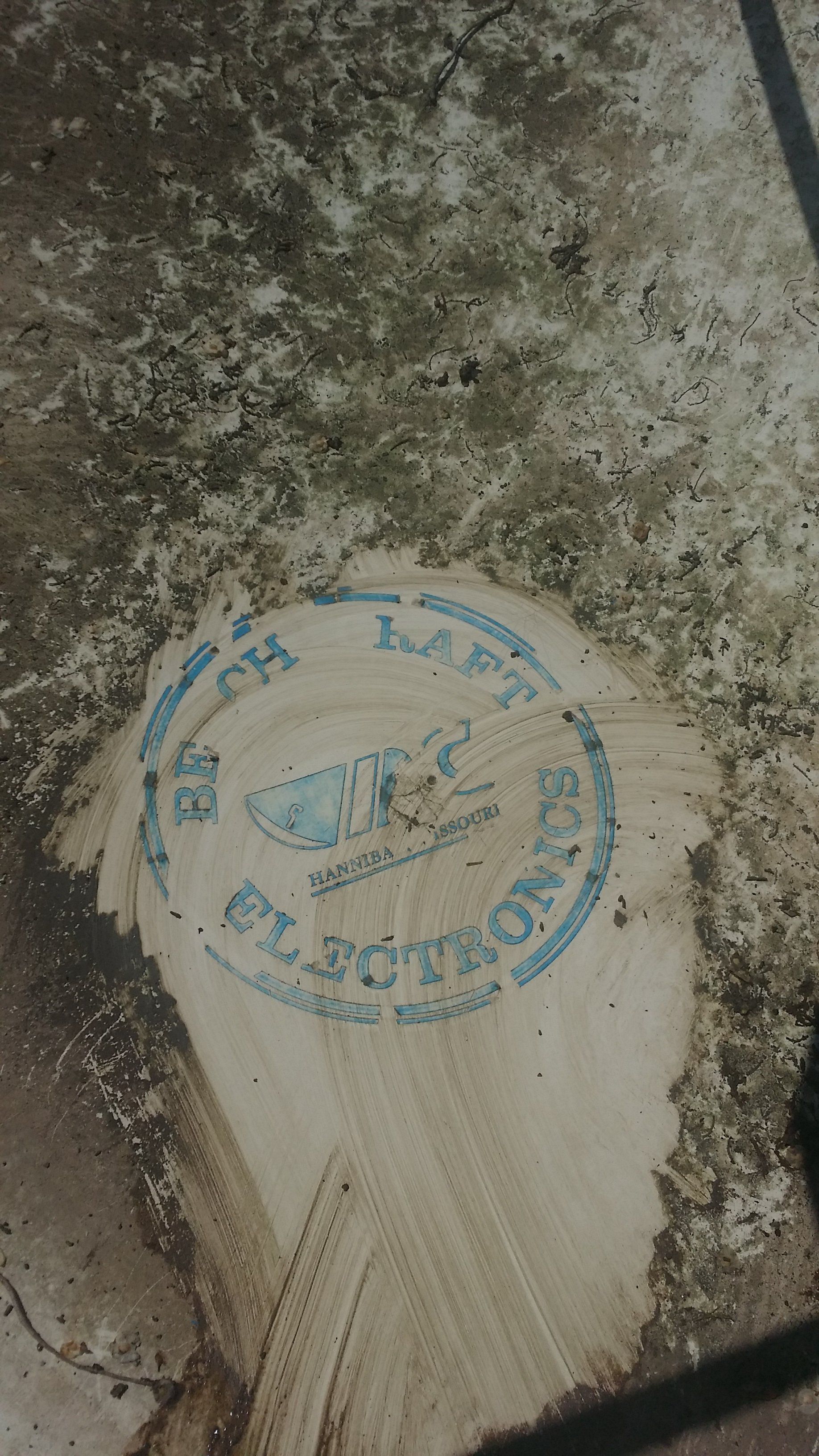

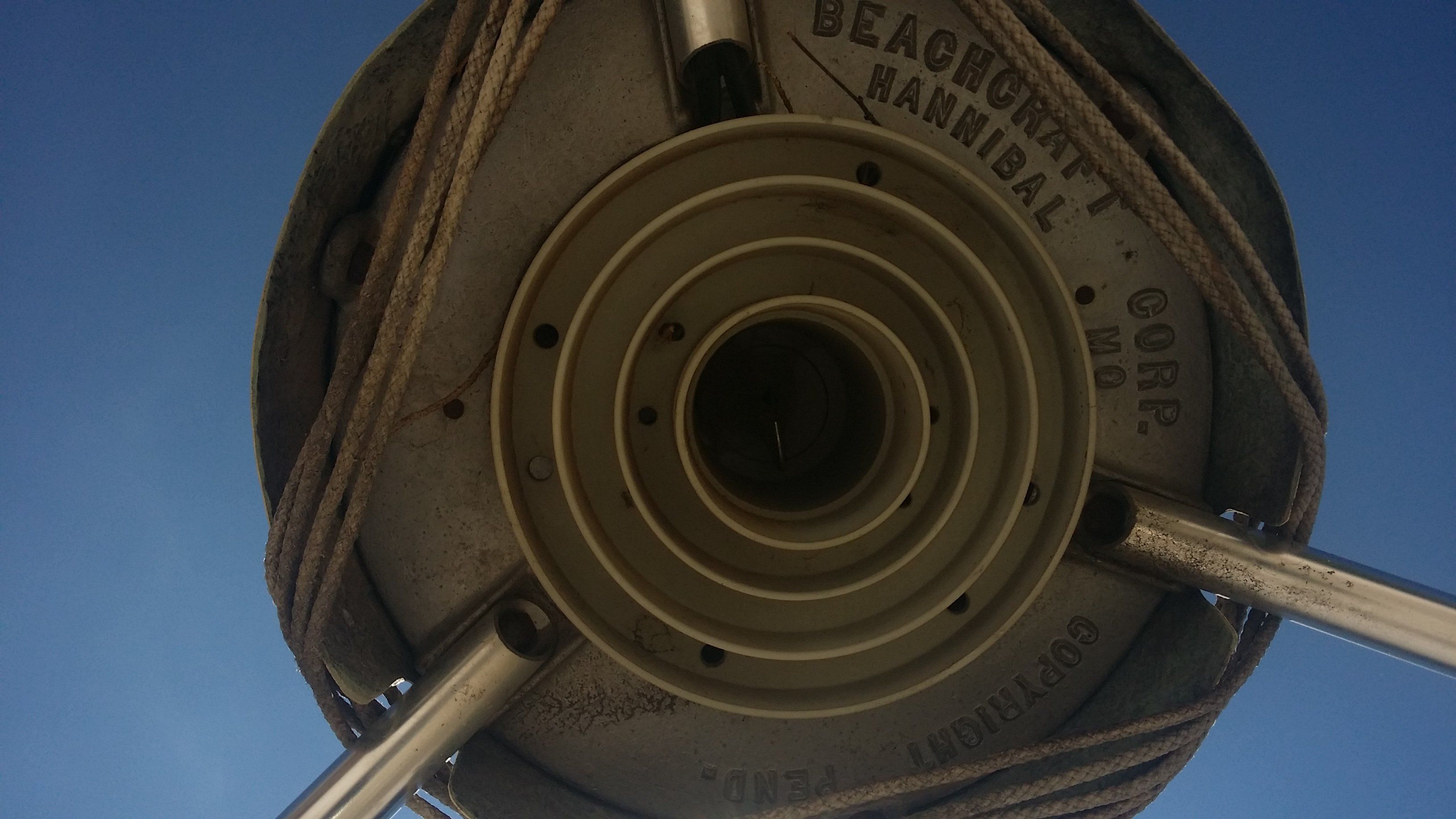

welcome hank123 :) C-band rules! Why do you think its a fixed mount. Judging by your pic it looks like the dish pivots which would make it a polar mount. beechcraft.jpg
I agree with FatAir. set up the 10 foot for the American sats and the 8 foot for the atlantic sats. (upgrade the 8 foot to a 10 later).
