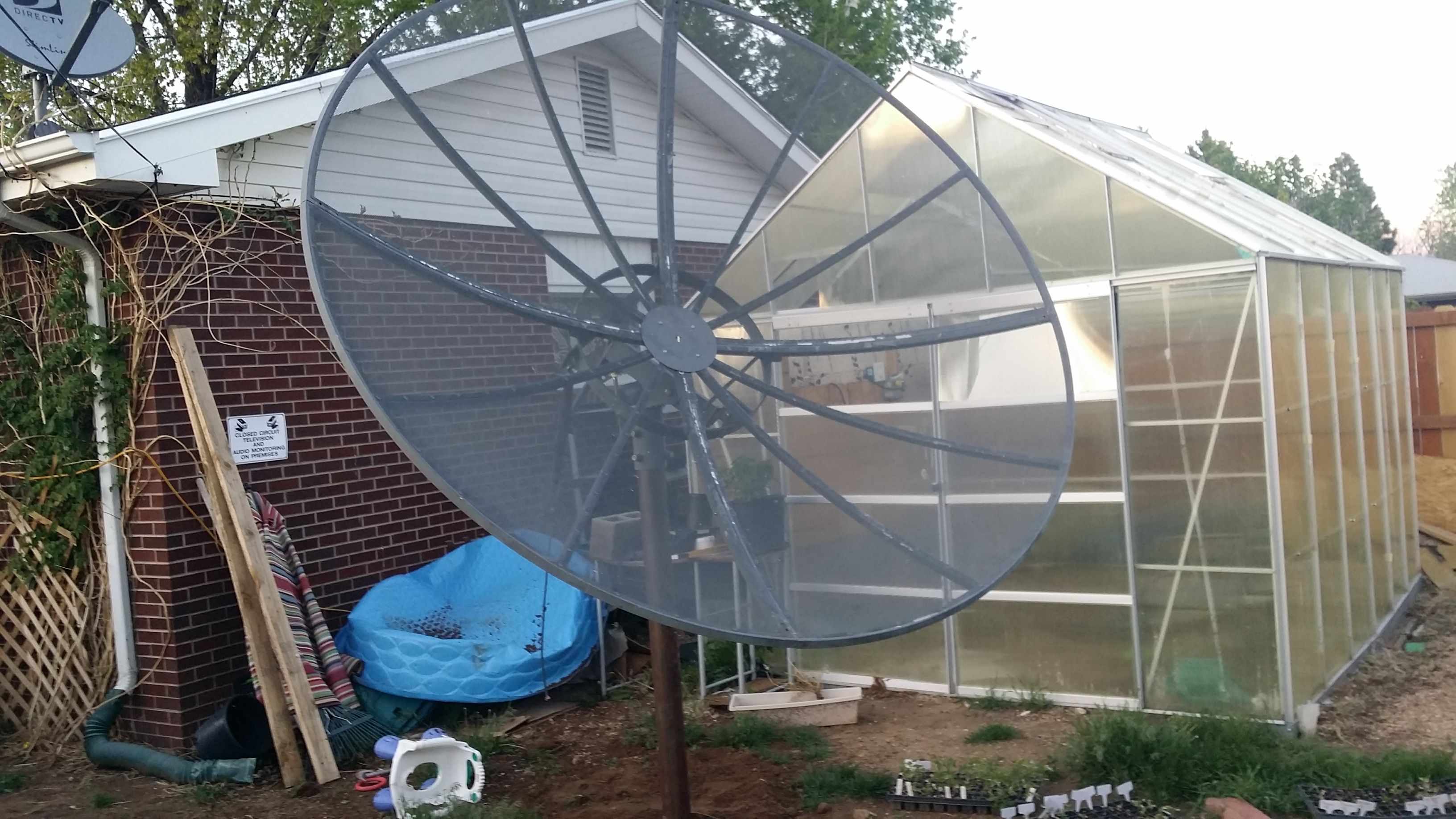

I was able to take apart (and it was easy) and get down the mountain the mesh dish today.
Have it almost all back together. Best part was I was able to get the old poll mount out of the ground by hand!

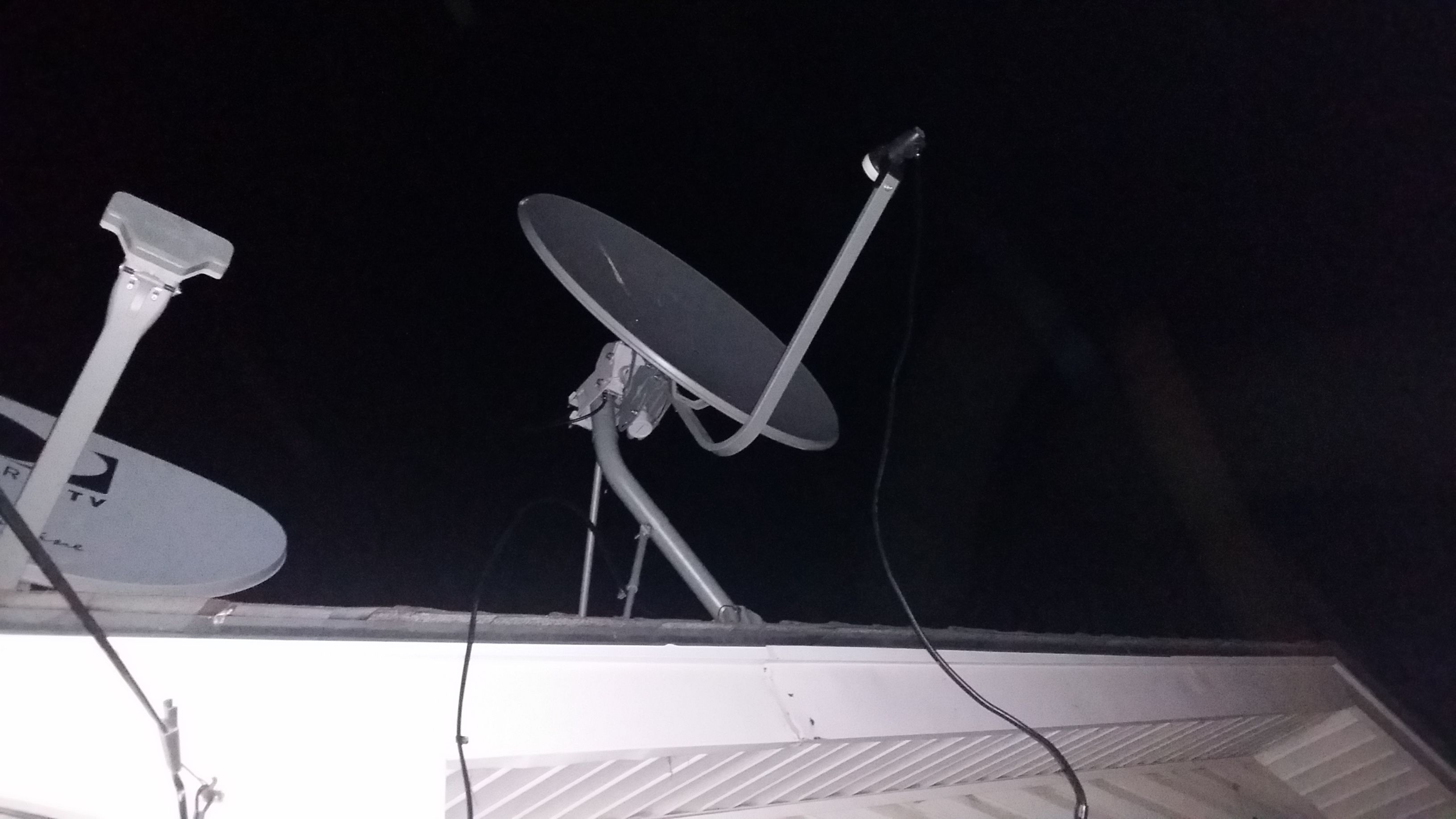

I did get my KU dish mounted today. Not tuned yet.

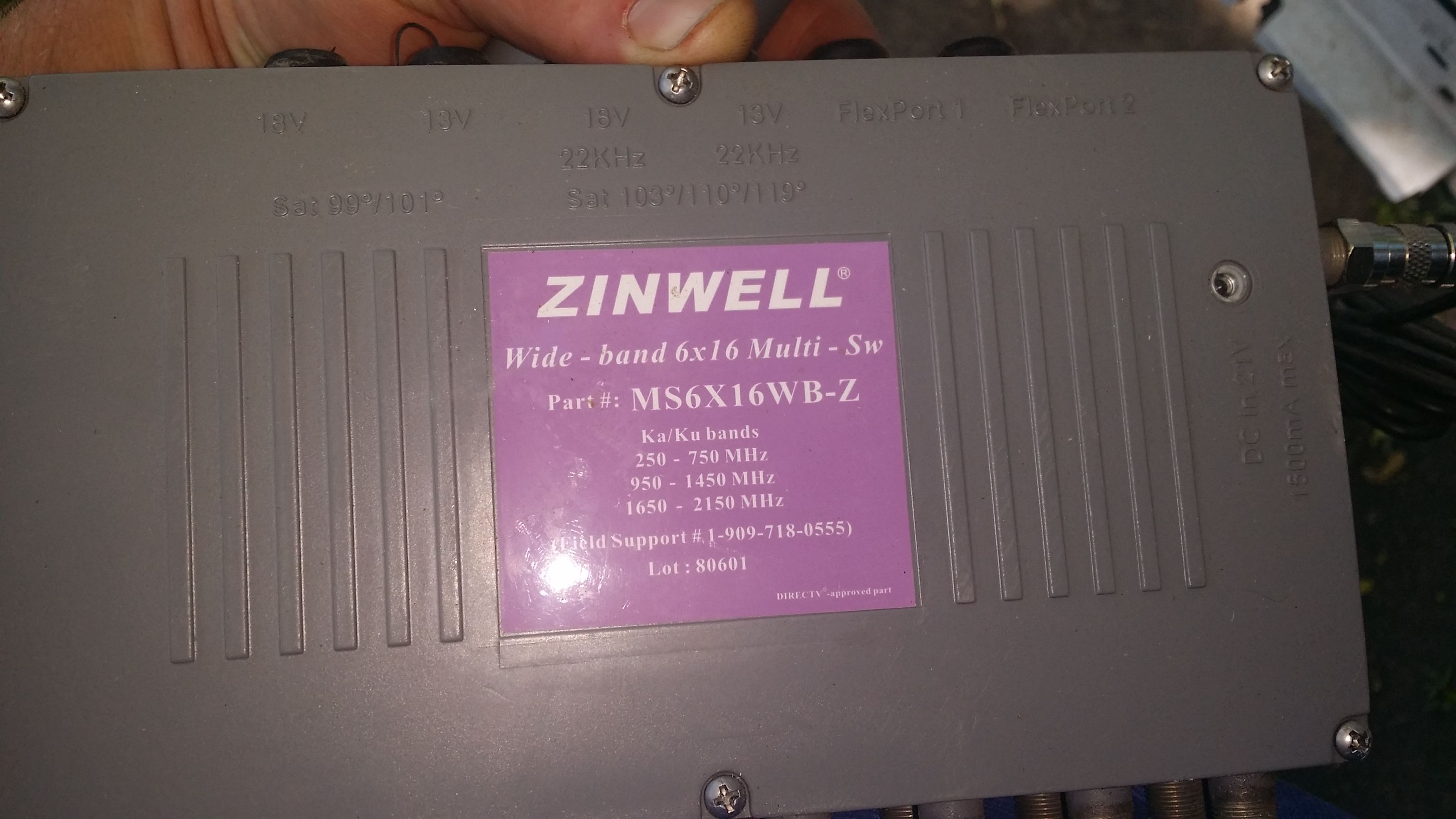

I also picked up a 6x16 switch. Would this thing work or should i stay with the 4x8?
Thanks again all
And the other question solid copper or can I run copper clad?
I have both.
Use a powered multi-switch that supports the approximate number of receivers that will be connected. No need for the additional loss or open unused ports.
I've never used a flex port switch for FTA, but the flex port inputs (250-950MHz ) are not compatible with FTA LNBs and receivers.
