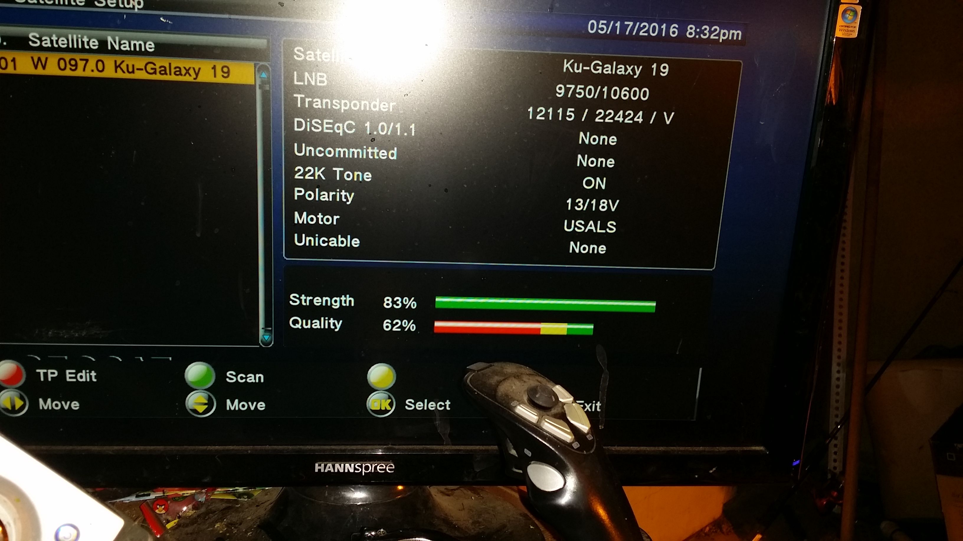

That is a good signal! You should be able to hook back to your receiver and blind scan in a bunch of channels.
Reactions: hank123
So I did a blind scan have a crap load of channels. Something I found I have to set the LNB on the receiver to 9750/10600.
Now If I go to a different sat, dish says its moving but I am not seeing anything, nor do I think the dish is moving.
When you do a blind scan you'll get a lot of channels, I think around 200+. You can tune to a weak channel and then verrrry carefully move the dish (or just the lnb) to try to peak the signal. Just moving a millimeter or two can make a difference.
Reactions: hank123
The motor is moving the dish or so it says it is. Not sure what I am doing wrong but its not moving to other dishes.
