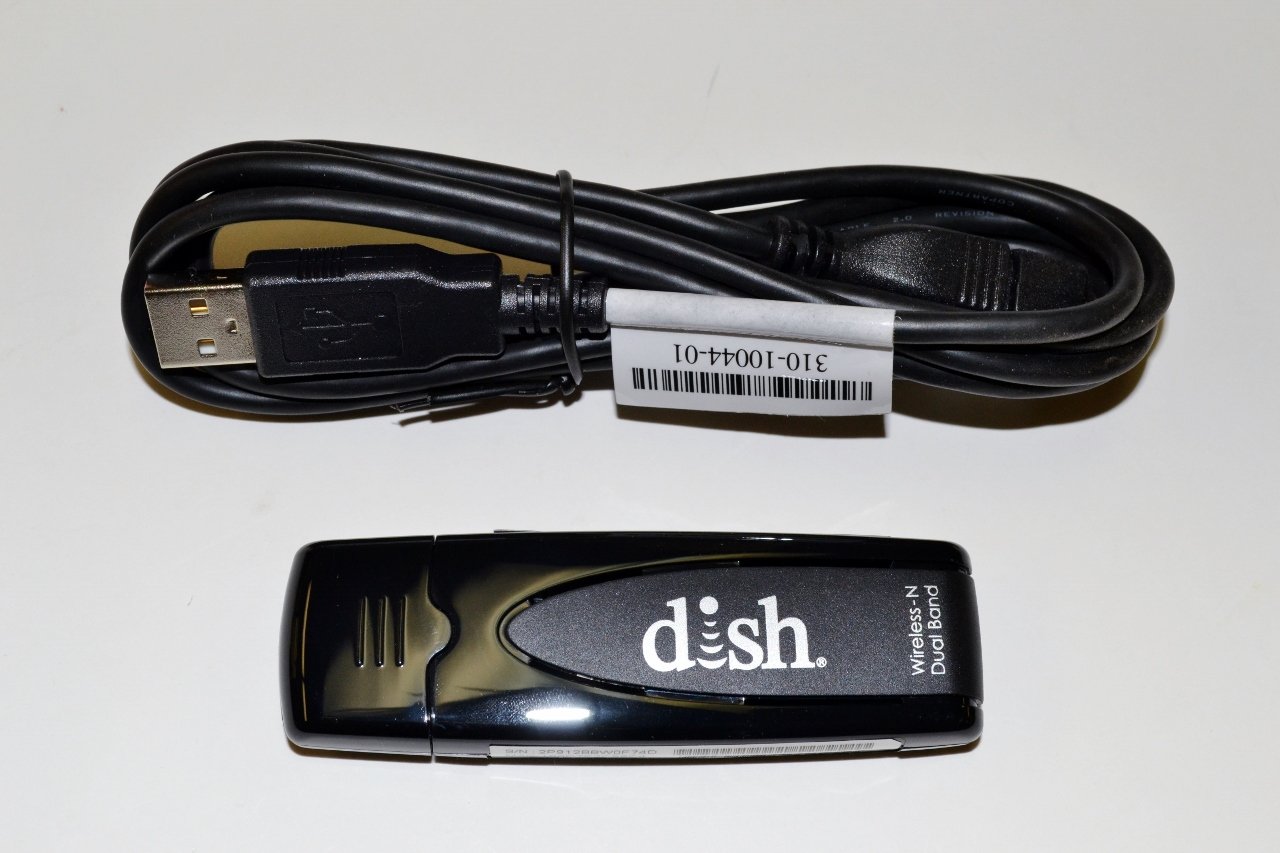

Slap a wifi adapter in the joey,log it into your network and you can move it around without any wires at all. (assuming you are internet connected and have wifi)
This is an unsupported (by dish) method but seems to work well if your network can handle it.

Yes what he said ^^. This will accomplish what you want for no extra monthly fee.

Its a specific adapter that's available at the dish store or eBay amazon ect...
[h=1]Dish Network 179048 Wifi Adapter Kit Dual Band 802.11N with cable[/h]
