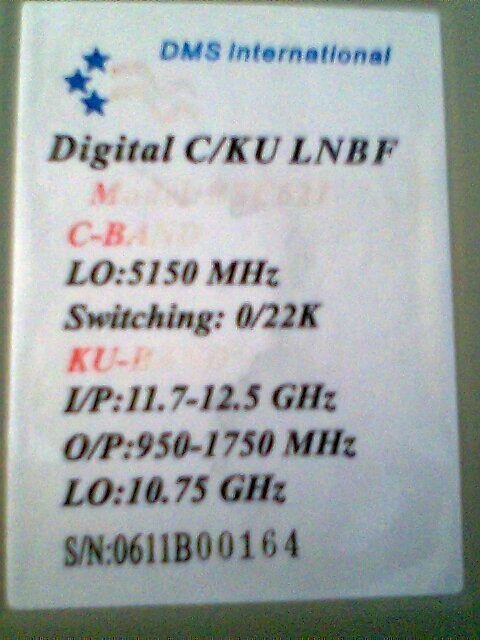

Here's a cell phone shot of the LNB label...
Ok...
Then for all the C band I use L.O. 5.150 / 22KHz OFF, right?
