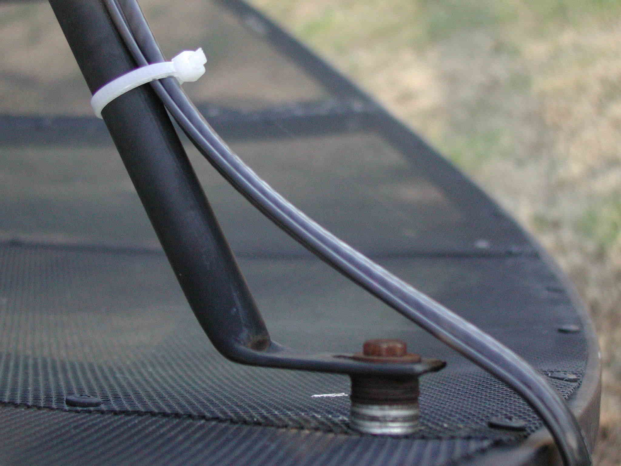

Anyway, I couldn't adjust the scaler out far enough to keep the F/D correct and get the FL right, so, I started digging around for washers whereever I could find them.
I stacked them between the dish and the feed supports. Raised the feed supports about 5/8" off the dish.

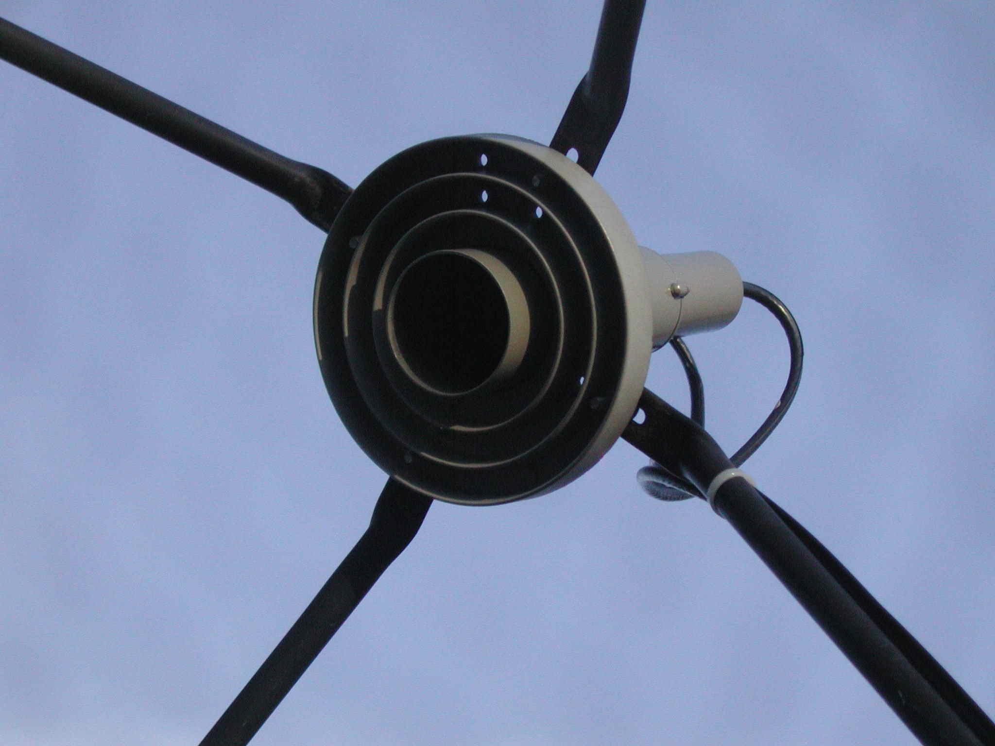

Another thing, I ditched the scalar that came with the 621. The feed fit so loose in that scalar that it was nearly impossible to get it to stay correct. I used the scalar from the 2nd 10ft dish I have - a channel master C only feed. I had to smooth out the ribs inside the scalar to allow the 621 to slide into it. Now there is hardly any 'wiggle room' for the 621 to move when you tighten it down. I had it bolted in and adjusted in under 15 minutes. Laser tells me I'm dead center.
OH - one thing I've noted about the 621 (at least mine) - the end of the feedhorn is not perfectly square. I couldn't level across the face of it, I had to line up along the side of it.

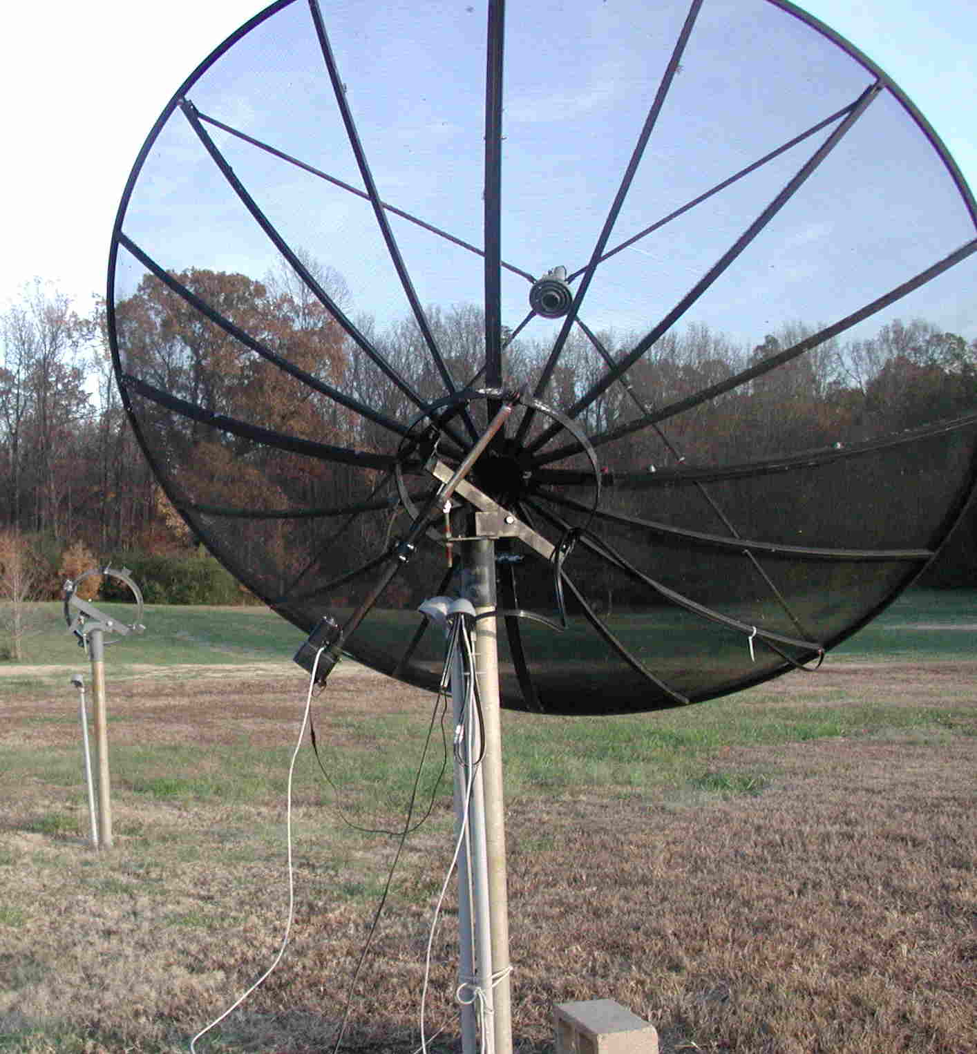

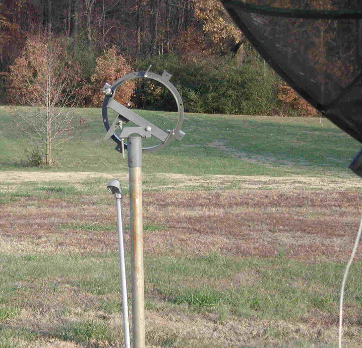

Snapped a few pics. Not much to look at - just a basic, beat-up, 10ft mesh. Also shot one of the mount for the 8ft... I'm debating now as to whether I want to mount the 8ft or the 2nd 10ft next... I'm torn...
