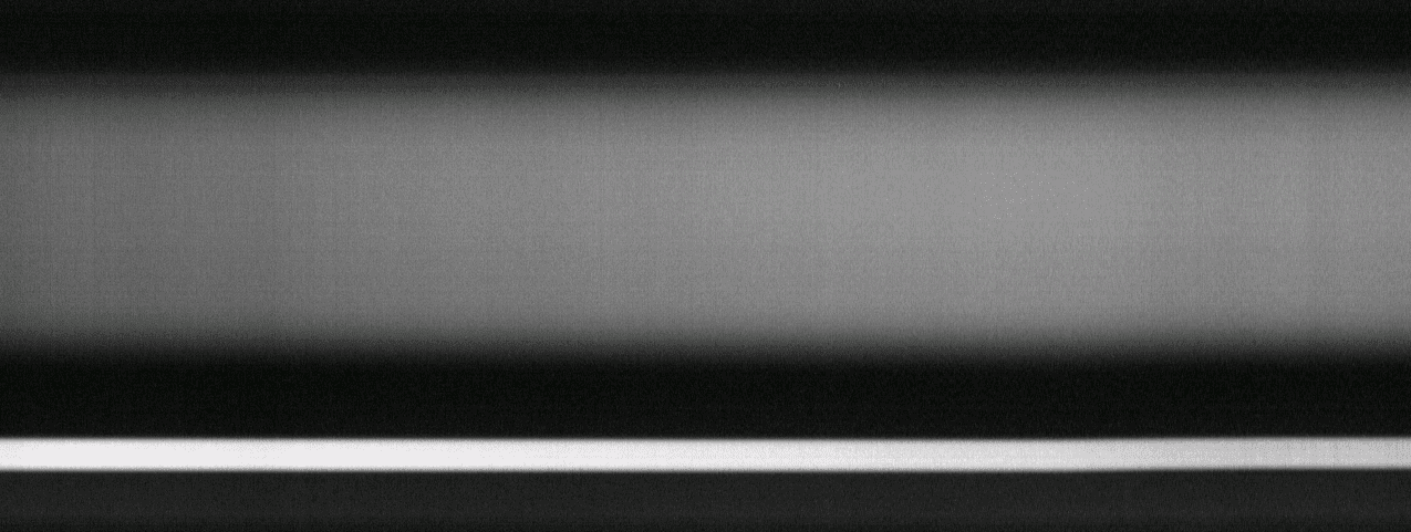

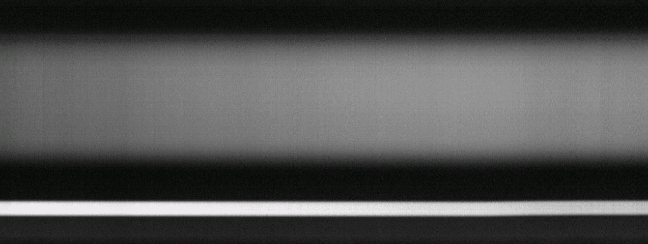

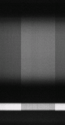

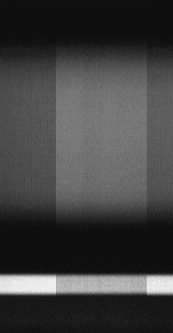

Attached is a skyscan from the BLSA. It sampled every 30 seconds from 11:25pm to 10:00am. Mid point is about 4:45am. All times PDT.
Just to emphasize the difference between the ~midnight sample and ~9am I copied the right side next to the left. The brighter the image, the more power. So the bright white line across the bottom is RTPi and it appears to have lost a little power in the daytime, opposite the effect we're seeing on this TP.
