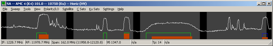

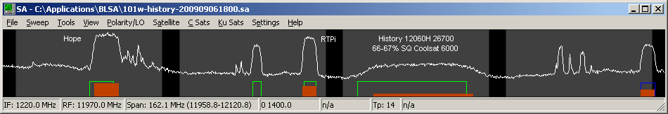

BLSA attached. I'll leave it skyscanning overnight if I can remember to not use the dish for something else. ;)

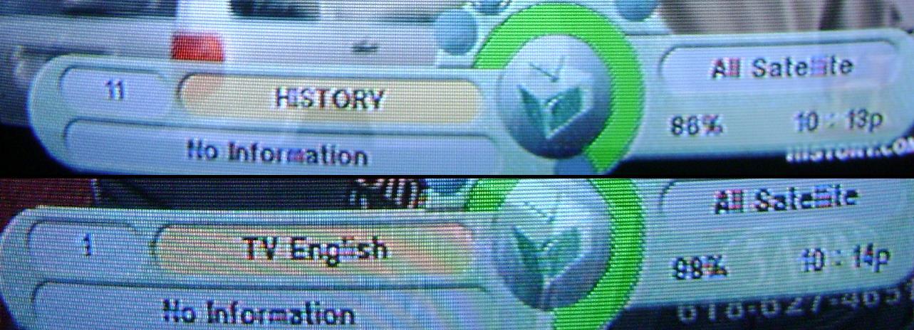

10:27PM EST NY.
86-88% Q Coolsat 5000.
