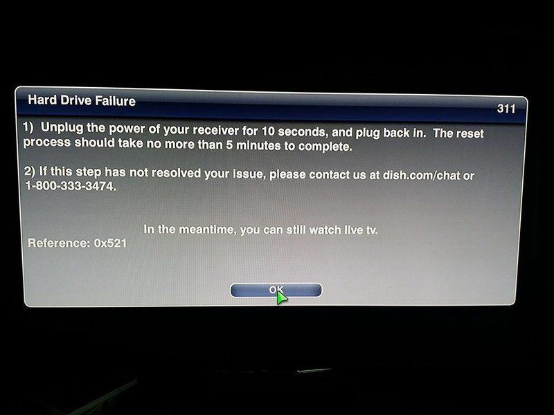

This evening we turn the tv on and find the Hard Drive Failure graphic on the screen WTF?

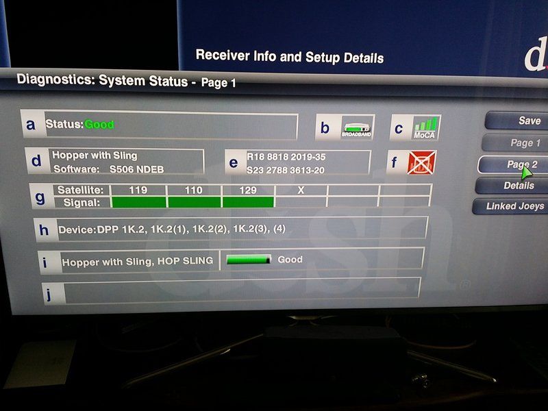

Ran the diagnostics,system status and the HDD is Red? I'm not running an EHD.
How do I get this receiver replaced without sitting on the phone with offshore tech support?
DIRT. Looks like Zach is online now. Send him a message. Include your account or phone number, Dish PIN, explanation, above photo and shipping address and it will probably be a simple reply the new Hopper is on it's way.
