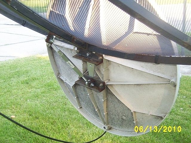

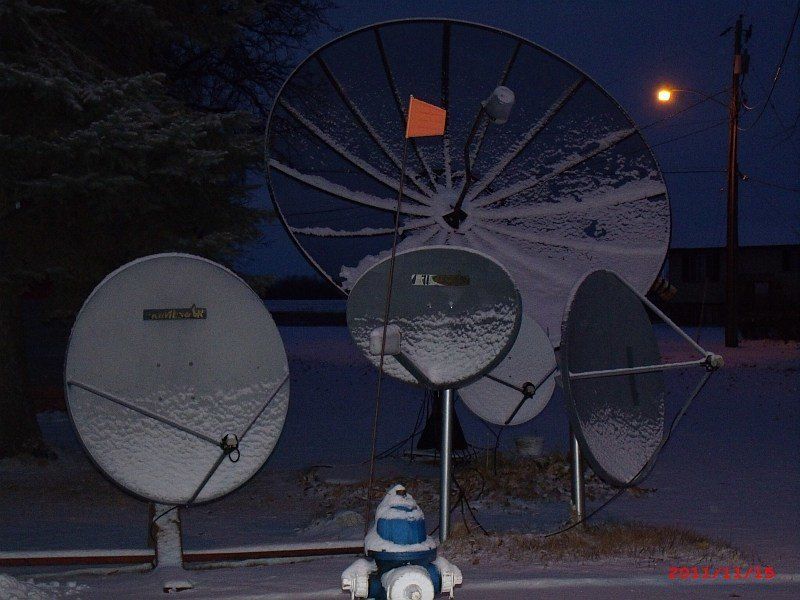

And, ya know, it 'was' only going to be temporary(until I got a motor) but it works so well I'm not going to change a thing. Here's the rest of the 'family'.

Thanks for the pictures and comment.
I had something like that in mind.
Pictuere #2, the thing that looks like a shock absorber, is this an manual adjuster or something else ?
