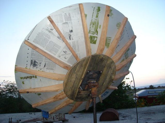

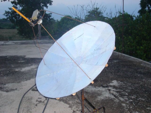

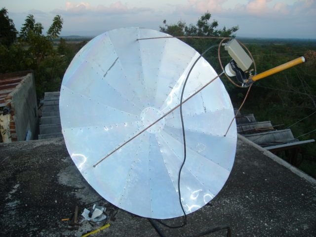

Can you post some pictures of your dish from different angles?
Antenna photos
Anole:
My dish is home made:o. I construct it myselft with some help and always you know (hide) i going to post to you some pictures with a circular LNB please don't take that into consideration couse you will see underground in a side of the dish other LNBF and is linear and my satfinder too. Another thing is that the mechanism of the lnb that you see is to adjust manually the focal point and tune even more the antenna. Another think no motor or switches on my system. The focal point is correct. I got to say that i going to chage my mount by a fix mastil i dont trust in my tripode.
Lockly i do everything you say and im glad in repeat all this steps as you say again.
For me is funny couse i have a lot of things and i cant do this work (5 LNBs, 2 pci cards, satfinder, 2 antennas, line amplifier) hehehe im so dump ... incredable.
Here are the pictures

Nice pictures!! Amazing ingenuity.... that must have taken a while to construct? Very Good Job! So, how Big is it? 6'? 8'?

Since , according to your pictures , you do not have a motor , do not worry about declination . Just the total angle of the dish . Lay a straight edge across the dish , vertically and measure that angle .
The angle will be slightly different for each satellite .

My dish is 1.20 m (or 120 cm) prime focus with a focal ratio of f0.6 (125mm deep). ;)
I made it in 3 or 4 days because where i live the materials are difficult but i imagine that in your country is in 1 day :D
