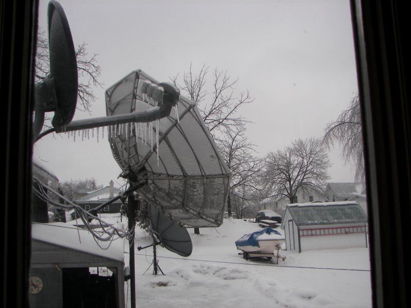

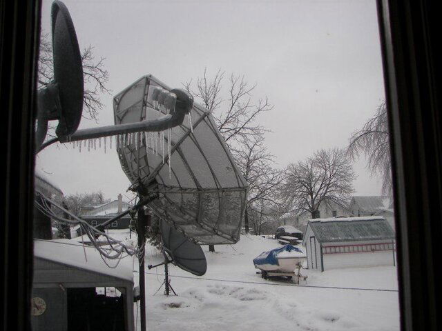

A few years ago we had this;

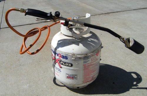

I used this to deal with it;
