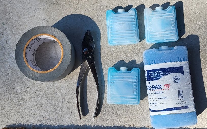

It would be interesting to see if ice packs make a difference in your case. I guess it's easy enough to try if you can easily reach the LNBF....
I remembered I have some "fake" ice packs. These are plastic containers that contain liquid which you can put in the freezer to freeze. They keep something cold until they melt then you put them back in the freezer to refreeze. I can easily duct tape a couple to my LNBF, replace the feed cover if it fits and see if I get any interesting results.

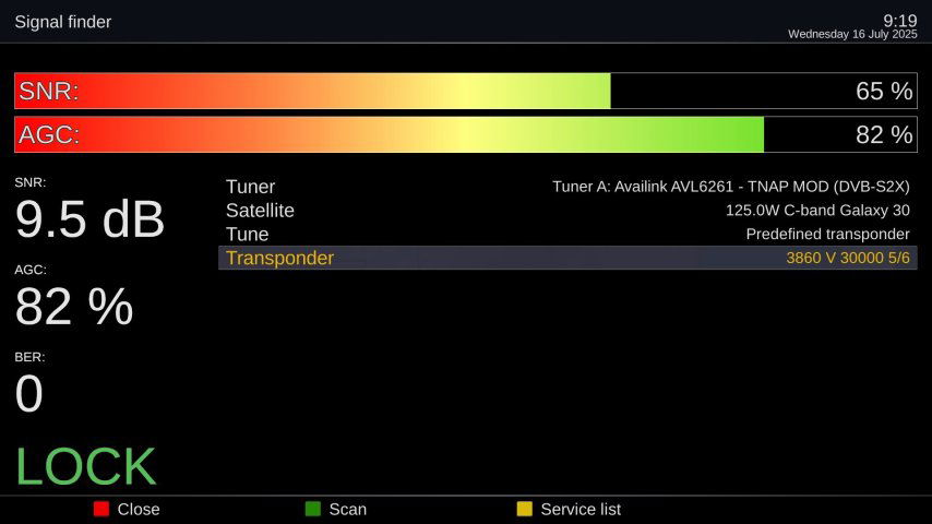

Starting data:
Time: 9:20 am
Temperature: 21 C (70 F)
Forecasted high: 25 C @ 3:00 pm (77 F)

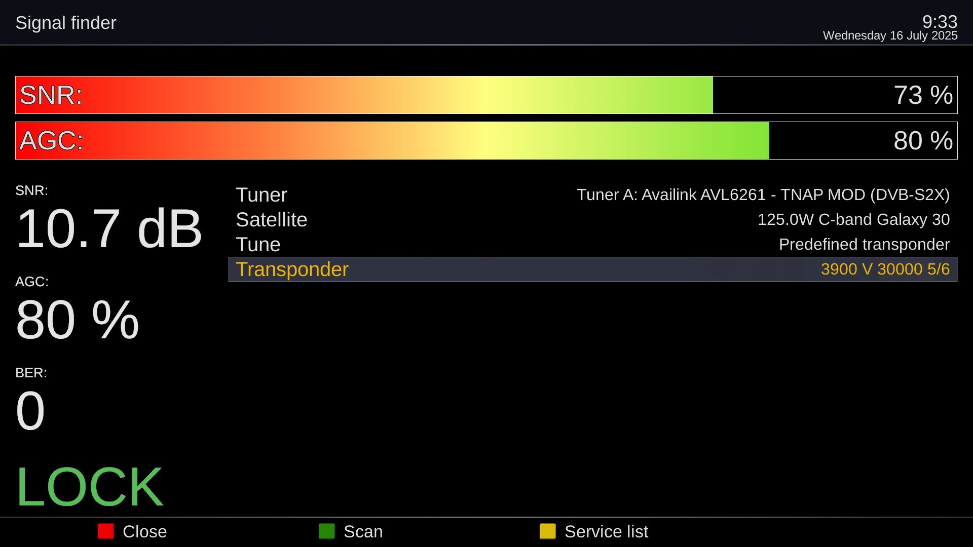

Test tps at start:
125W 3860 V 30000: SNR 9.5 dB
125W 3900 V 30000: SNR 10.7 dB
Added 10:34 am & 22 C (71.6 F):
3860: 9.1 to 9.3 dB (varying but remaining locked)
3900: 10.3 to 10.6 dB (varying, locked)
Note: C/N minimum lock for these tps is 9.4 dB. 3860 is remaining solidly locked until the measured value drops occasionally below 9.0 dB. 3900 remains locked always since it is well above 9.4 dB.
Test tools:

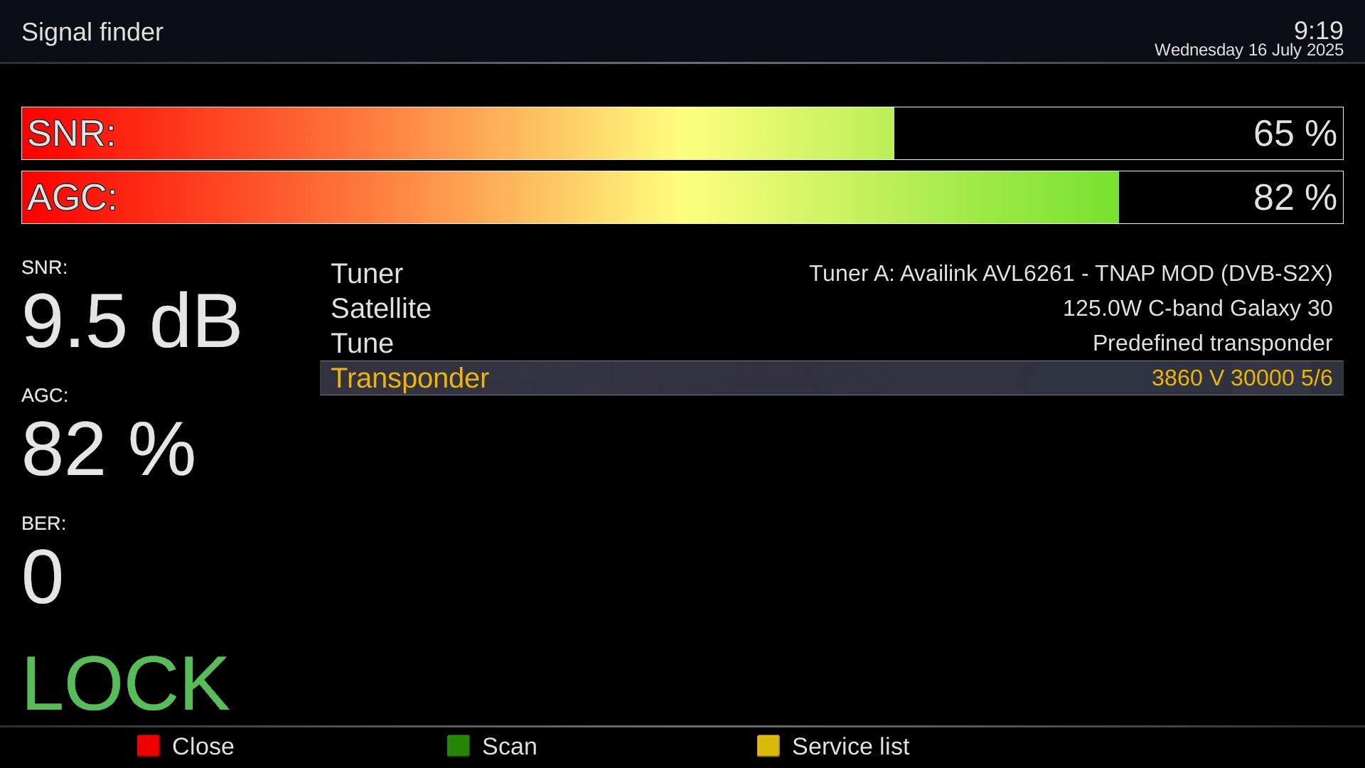

Starting SNR:
