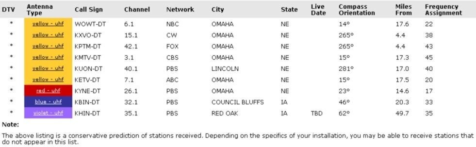

Hi, I live in a hilly area with a lot of large trees. Any suggestions for a good indoor HD antenna. Will this one work mounted in the attic? (Terk HDTVa Indoor Amplified High-Definition Antenna) Do I need the amplified version?

It might work OK but some reports say it is not as good an antenna as the non-amplified version. The "best" indoor antenna is usually thought to be the Silver Sensor (Zenith or Philips, again the non-amplified version is the best one for many people). The Terk HDTVi seems to be a clone of the SS, but with the addition of "rabbit ears" for VHF. You don't have any VHF digital stations, so UHF-only is fine. Antenna selection is an art not a science, indoor antenna selection is worse - all you can do is try what is available. You shoul get the yellow stations, you may get the red ones, you probably won't get the blue ones. I assume KXVO-DT and KPTM-DT are broadcasting low power since they are very close to you but are still "blue" stations, they may by now be on full power or will be soon, you can check the local reception forum for Omaha, http://www.avsforum.com/avs-vb/showthread.php?t=144464&page=142&pp=30, for the latest news.
Your stations are in different directions so you may not get them without adjusting the antenna betwen stations which would be impractical if it is in the attic. Going to a better antenna will mean a directional one, which would probably need to be on a rotator....not good!!
I suggest you get a Silver Sensor or the Terk HDTVi and see what sort of reception you get, then post back here....

What heading is the antenna pointed (it is very directional and UHF only)
What is your zip code so we can look up your affiliate information.
My zip is 68059. I did a little research and I don't think my TV has an HD tuner. Bought it used. I will look into an HD tuner. Any suggetions on a good one?

Your channel tower locations are all over the place. so a directional would need to be aimed each time. Note the freq assignments, as that is the real number that you MIGHT have to manually type in. (Not 100% sure how your set works)

EDIT: Added the antenna web pic
