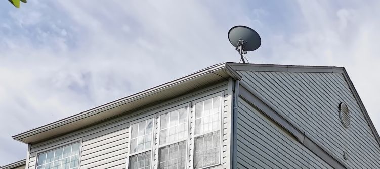

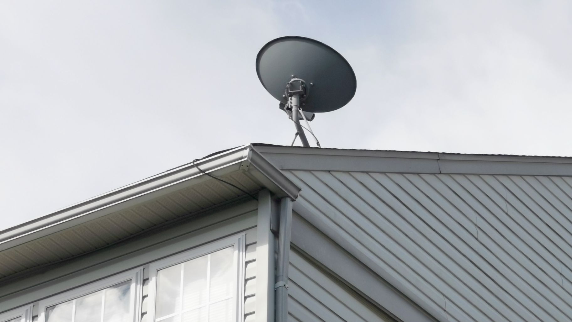

I live in a Three story town house. My dish was previously installed on my roof but was removed while my roof was replaced. The HOA says it can no longer go on the roof. (Pole is also not acceptable) My house faces South West and the dish cannot go on the front of my house.
If I recall, it is bad to install on vinyl siding.
I checked the angle and I need 36.5deg elevation (62.4deg skew) which looks to be alot more than the angle of my roof.
I have the installer coming in a week. I'd like to be prepared with potential solutions to recommend on the spot in case I run into issues. Also, ideally something that wont cost me extra. I am already on the very fine edge of cancelling and switching to comcast. If this install doesnt work out, I think that will be the last straw for me.
Photos with old dish installed:

The HOA contracted the roofing to be done. So my dish has already been removed.
I dont have a fence and they wouldnt allow it on there. I don't have enough yard so that my house wouldnt be blocking the signal anyways.
(the back of my house is on the left, the side of my house is on the right)
I'd love to put it on the back, but the vinyl siding goes all the way up so I don't see where it would be able to get installed.
The only place I can see is perhaps on the fascia but I thought I read somewhere that they dont like to do that either. I'm also not sure they could get the dish up high enough.

They don't want it attached to the roof. They did not say it could not be attached to the house. They don't want it on the front of the house.
They won't allow a pole in the ground. Someone mentioned a fence but I dont have a fence and I dont believe they allow mounting to a fence if I recall.
From reading the forum, it seems that one should not install on vinyl. I am just looking to see what the best method is in my situation to recommend to the installer. My preference is to put it on the back of the house, but it is all vinyl. On the side, it looks like there is fascia that can be used. Also, it would be ideal to have a solution that does not involve me spending more money.

If it does go back in the same place it would look nicer than it did before by using a stub mount with no support rods.

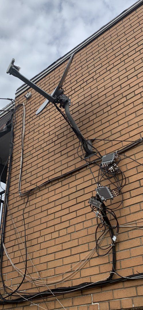

While your calling Solid Signal, ask them what they recommend to fix this mess that one of their Techs installed at a local Motel.
YES, Solid Signal installed a dish this way and left the switches hanging like this.
