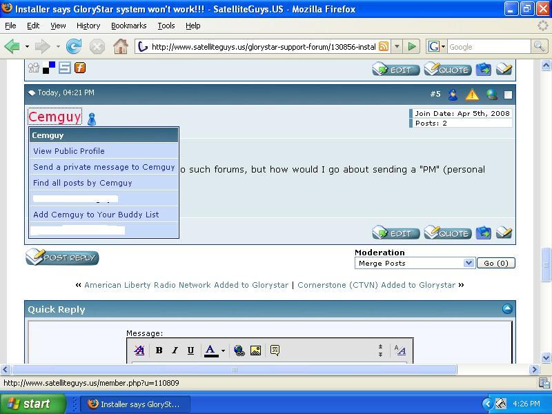

Please bear with me as I'm new to such forums, but how would I go about sending a "PM" (personal message?) to Glorystar1?
Thanks
normally just click on someones name and there is an option to send a Private Message. I posted a pic on what happens when I click on your name (I erased a couple things as mods only see those)
But here is a quick link to send one to Glorystar1
http://www.satelliteguys.us/private.php?do=newpm&u=71152
