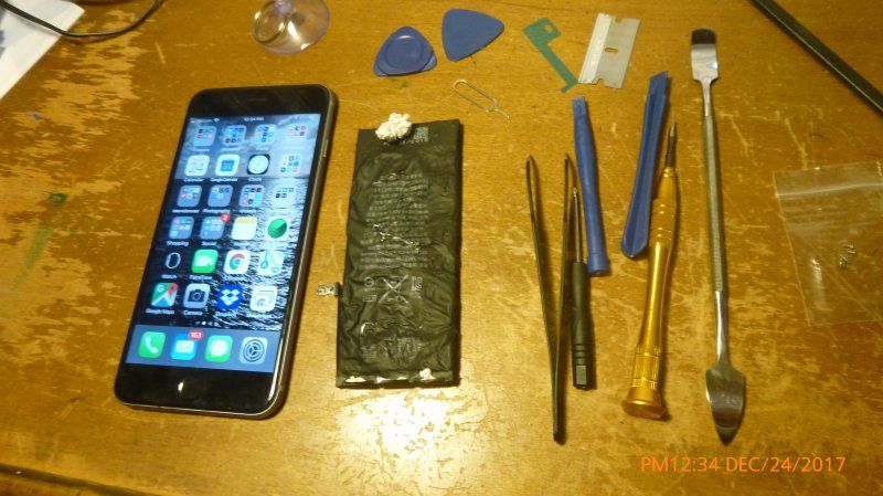

The new battery kit arrived at noon and I was eager to get started.
Getting the iphone open was the easy part. A little more difficulty getting the tiny micro screws out was tedious, especially for my 70 year old hands. Just have to be slow and careful. A good trick I learned long ago is to put some double stick carpet tape down and drop the screws on it so they don't roll around and get lost on my desk. I was planning to keep the screen connected while removing the battery but once into it I decided that was a very bad idea so I removed the metal cover from the connections and saw there were more connections with 3 layers of fragile ribbon cables easily pried up with a small plastic tool. Once that was removed and put aside I could manhandle the battery removal with less care. It was really stuck in there with the mfg, glue. I used my LSI soldering heat gun on low temp to warm up from the iphone back which softened the glue enough but it still was very sticky and difficult but began to give way. Took 20 minutes of careful prying. About half way through I was beginning to get nervous that I was not going to be successful. As I continued to pry the battery out it was getting permanently ruined. I was glad I let the battery run down to well below 10% before doing this because at one point the battery sparked and smoke shot out from between the battery and the case. It quickly went out and never got real hot. By the time I got the Li PO battery out I had bent it up quite a bit to almost L shape! Pretty scary. So be forewarned if you try this, be sure to have the existing battery completely discharged before doing the swap.
Putting the new one back is just a matter of taking time to properly seat off the tiny ribbon cables and be sure to mark the tiny screws as they are different length ones for the same cover. While it may be just the kit I ordered, the small ribbon cable on the batter needs to be bent unto a small u bend like your original to fit. This was a little tricky not to tear it.
When I did the final assembly, I turned the phone on with a long push of the power button and the apple symbol came right up. In a couple seconds I entered my finger print and it showed the home screen. The replacement battery was 53% charged. :)
$25 and 45 minutes to finish.
