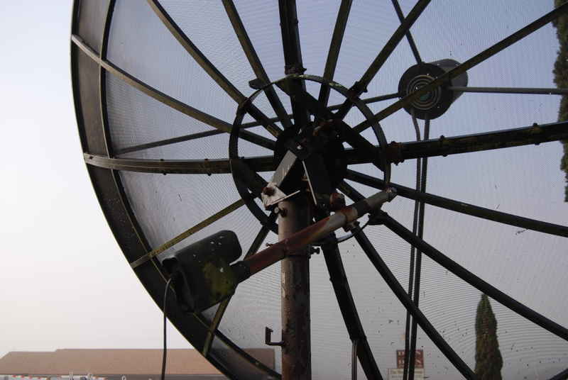

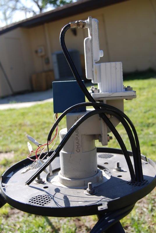

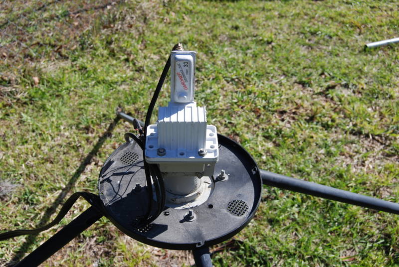

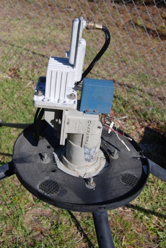

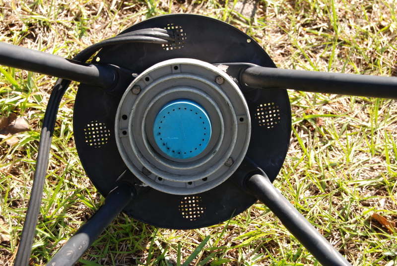

Feedhorn Photo's
Hey Guys,
Heres some images of my feedhorn on the 10' dish.
I think it is just a C-Band as there is only one cable wire hook up to it.
Thanks,
Tom :D

Tom. Looking At the pictures. it's C-band Only which is good too. cause W5 has the same channels on it as KU. gets. which ku can get somewhat alittle more. but most people just have cband. hope u get ur dish back from the shop soon and get this thing put up cant wait to see it up on the pole :hungry: take care man have a good night

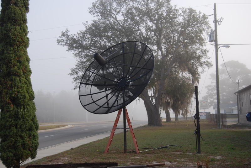

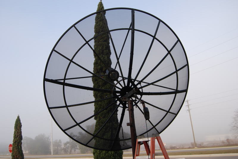

Hi everyone,
When I first started this thread it started out just featuring the support poles. After thinking it over I felt it needed to be all about the putting up the satellite dishes from start to end. Even though sme of the images at the beginning of this thread are ahead of some of the photo's I have already taken, I think it will be ok. At lease it will provide some before and after shots that I have taken and you will see the progress from start to end.
First I found my first satellite dish at a out of business satellite shop. I inquired about getting a dish and putting it to a good use. I got it a couple of days later.
More to come shortly!
Thanks,
Tom
:D

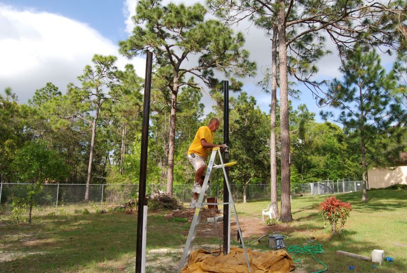

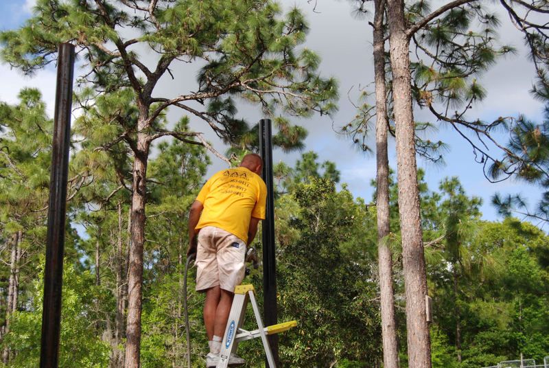

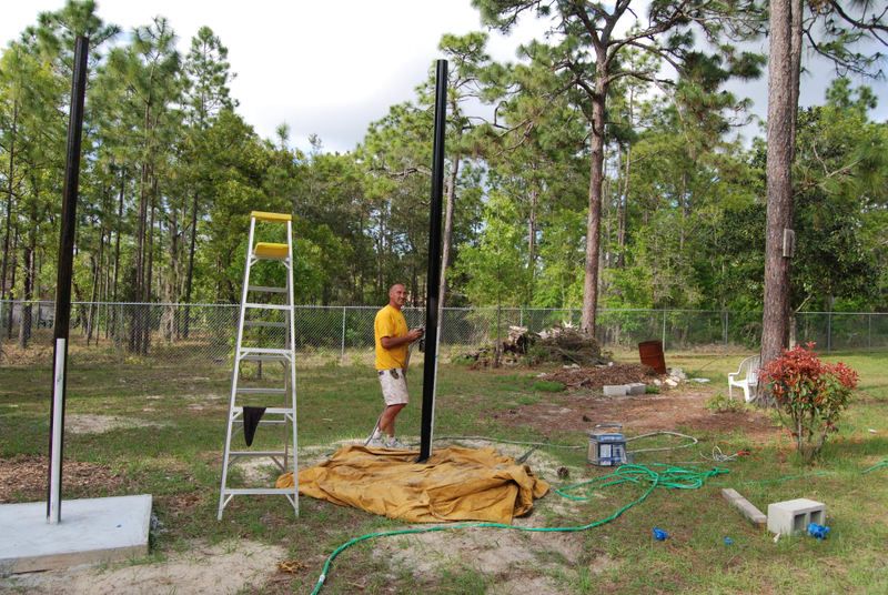

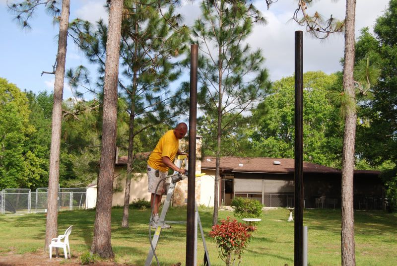

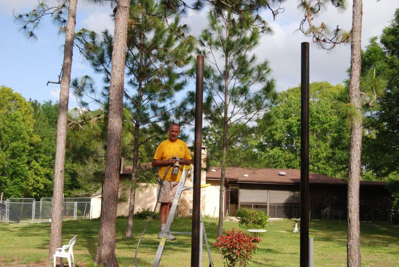

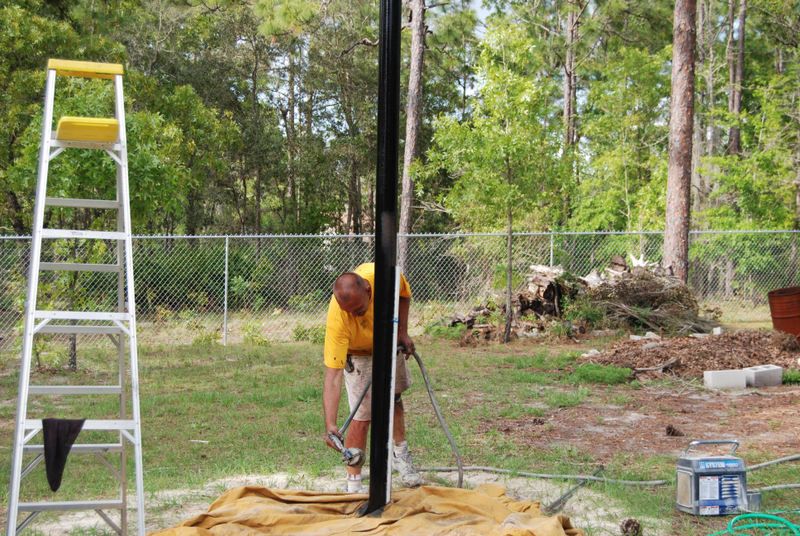

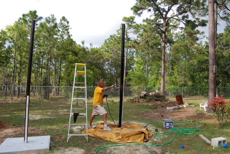

Working on support poles
Hi everyone,
At the beggining of this thread you can see that I put my support poles in for the satellite dishes in. Now you will see them being painted. Also take note that I built a 4x4 square around each pole with 2x4's and poured a foundation slab of concrete so that if I ever need to work on the dishes I will have a good standing. Also Each pole has more then enough of cement to hold it in the ground in case of any huricane I may get here. I stoped counting the 80lb. bags after 40. The 4x4 square's took an extra 10 bags each.
More to come. ;)

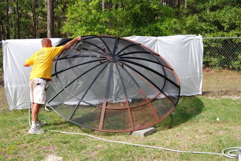

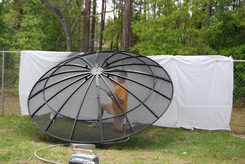

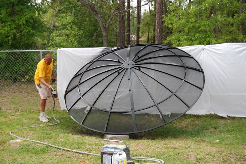

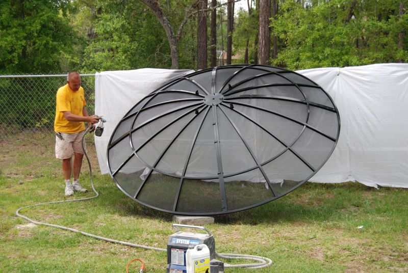

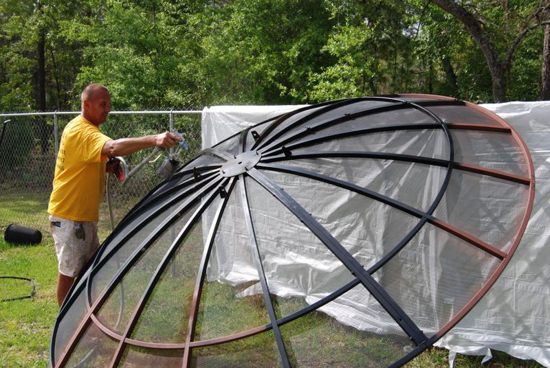

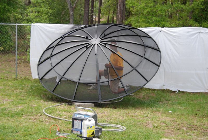

Getting Dish Painted
Hello everyone,
I did takeoff the actuator that was rusted bad and I got some "Bartenders Brand" of Rust and Lime remover. Used that and it took a lot of tyhe surface rust off. At least it's not so bad to the eye anymore and I did give it a brief test and it still works!
Now I have a friend of mine who is a painter by trade and he came over to help me paint the dish. Here's some photo's of it.
Thanks,
Tom
:D

Tom,
That is a super great job you are doing on that dish. Primer and all. Wow is all I can say.
That dish is going to look like a brand new one when you are done.
You have really took off with this hobby. Just wait til you get everything dialed in and have c and ku booming in.
Are the dishes capable of seeing over all the trees on your and your neighbor's property?
I was just curious seeing all the trees behind them.
I would fill those poles with cement too since they are high up and will flex a little. You don't want your big dish blowing off the ku satellites if it is windy.
It takes just a little movement to lose ku on a big 10' dish. Signal can go from 100 percent to nothing fast.

A nice clean paint job and new bolts
Your doing a good job on the dish.
Reminds me of some of the ones I painted. :)
They sure look a lot better after a nice clean paint job and new bolts.

Truckracer made a really good point about filling in the inside of those poles with concrete.
I have never filled any of my masts with concrete. I know others here who advocate that, but concrete expands and contracts with the temperature. Once it hardens, there will be a small space between the pole and the concrete. Make sure water never gets inside the pipe especially if in an area where it can freeze. Course you won't have that much problem with freezing. But you get my point.
If the pipe sways that much in the wind, you need a schedule 80 pipe (thicker walls), or anchor it with steel side supports welded to the pipe at least 5 foot from the top of the pipe and inserted into the ground embedded in concrete.
I think that would do more good than filling the pipe.
Well both poles are very deep in the ground. The 4" is in just under 8' feet deep and a hole the size of 3' x 3' and the 3 1/2 is buried 5' feet deep and a hole the size of 26" x 26" . Then both have a 4' x 4' square slab on top of that. They aren't going anywhere. Both of the pipes are made of heavy guage metal used in water wells. They are solid. We do get a freeze down here that is usally a few days out of the year. So maybe it would be wise to cap it? I may anchor it with steel side supports welded to the pipe like you said at a later date.
Thanks,
Tom
Your depth and concrete base is fine, but what is sticking up 10 foot with a 12 foot dish catching wind could sway an ordinary pipe as much as 1/16" at the top where the dish is. That's enough to knock out Ku signal.
If your pipe is well casing, you should be fine. You'll know soon enough. :)
