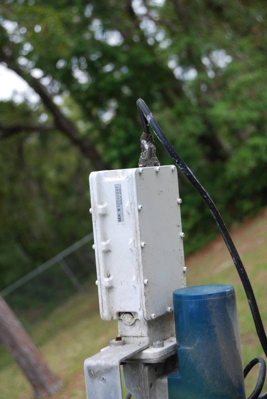

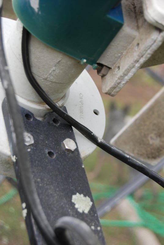

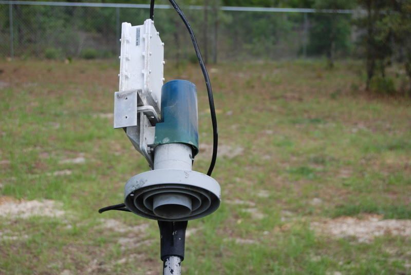

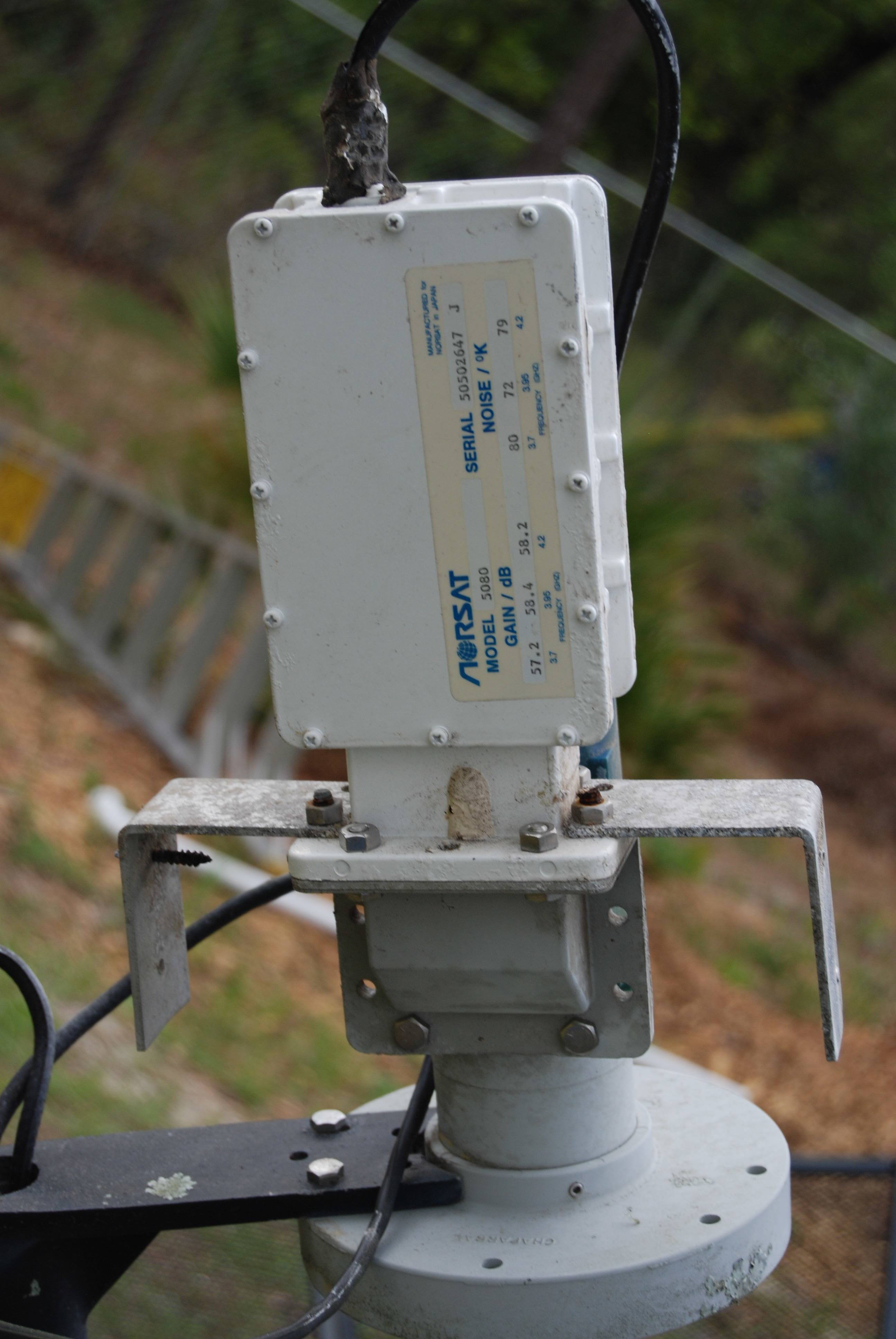

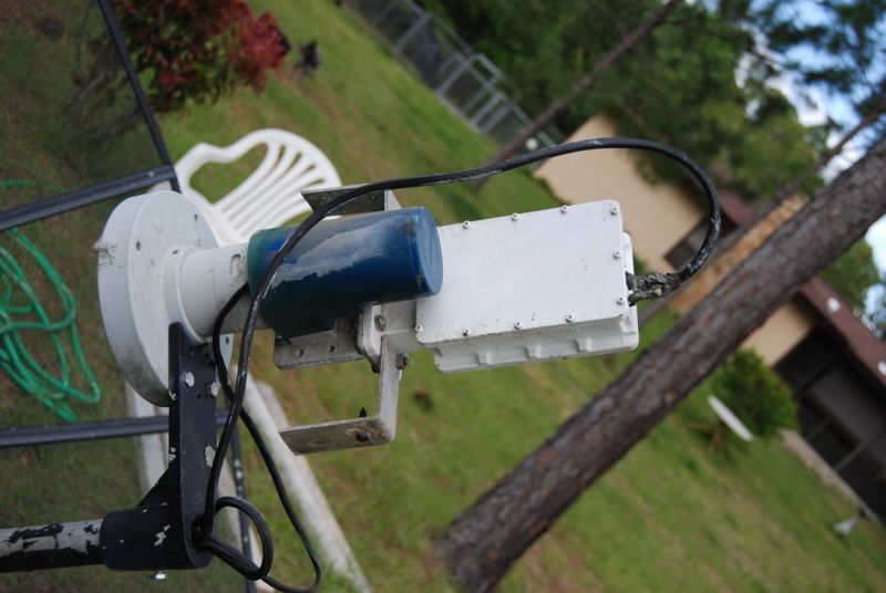

Pictures of the feedhorn's and the LNB's
Hello everyone,
Here are some pictures of the feedhorn's and the LNB's next to each other. Both look like they are C/Band only. The Unimesh Dish and the Janeil Dish both have on them Chaparral II LNB's.
Wondering which type of LNB's to get that will have the C/Band, KU/Band and Circular C. Although I don't know what Circular C is, I was told to get that??
Also need to know what brand of Receivers both Analog and Digital work best with the C/KU-Band and Circular C?
Unimesh Feedhorn
Janeil Feedhorn
Thanks,
Tom

feedhorns don't really wear out. Just be sure they are clean inside. No bugs or nests.
don't touch the probes with your fingers or anything oily.
C/Band Only
Tom, both of those feedhorns are C only. They are old, but I'm sure they will be fine.
Thanks AL. Yes I found out from Chefwan that they were C/Band only. At first I thought they might be also KU/Band was because I noticed two wires going into the feedhorn cover. Once I took it off I knew it was a C/Band only. Yes I'm sure that the Unimesh and the Janeil will be fine running as a C/Band only. My thoughts are as long as the both of the dishes are down...why not put on C/KU-Band on the both of them before putting them both up then I can get the best of both worlds. C and KU. Still need to know what Circular C is?
Thanks Truckracer. I didn't have such a problem with the Unimesh with Bug or nest. The Janeil had some Wasp nest and they were pretty mad about it being taken away. Thats over now. Not a big problem. I'm a little concerned about the wire going to the Janeil feedhorn. When you look at it it has a glob of goob and I don't know if its some kind of glue just to hold it in place as a temporary fix? I'm thinking of getting a Chaparral Corotor II +Wideband Feedhorn. If I get the Feedhorn are the LNB's already on them and are they sold together?

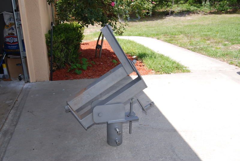

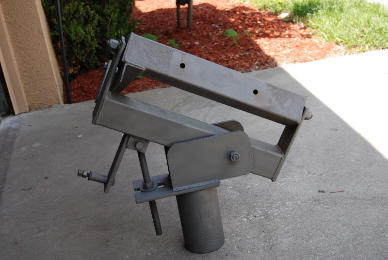

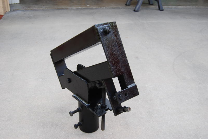

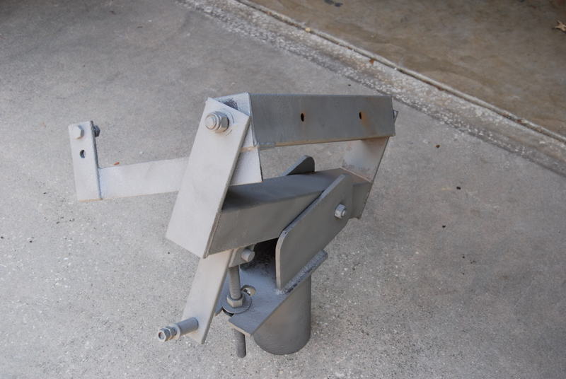

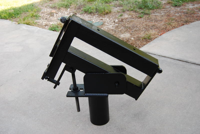

Janeil Mount - Before and After Photo's
Hello Everyone,
Here's my work in progress with the Janeil Dish. Just got it back from being Sand Blasted. I put on a fresh coat of paint or two and is ready to be put on the dish. I will be working on the dish too to remove loose paint. Repaint that and put on some new feedhorns to both dishes and some LNB's for the feedhorns as well. Getting closer now to the day I put both dishes up.
I have some "Before and After" shots of the mount. It was looking pretty rough. It looks pretty good now.
Then there are the photo's of it has it came back from the Sand Blaster.
And the last two are with a fresh coat of paint.:)
Thanks,
Tom
:D

Tom, that mount looks great!! it looked real bad before but you've gotten it looking brand new great job once again your going to have a nice setup soon!
now for the feedhorns ...from looking at the lnb's on those feedhorns the first one looks to be a gardener lnb. the 2nd looks to be a mantronic i believe thats what its called i had one on my paraclipse before i changed the lnb out. it's a real old one. but might still work. its worth a try?
Thanks Steve, It should do ok now. I hated looking at it all rusty and all. Wanted it to look the best that it could! Should last for a few years or more.
The LNB on the Janeil is a Norsat. Just thinking of going both C/KU-Band.
