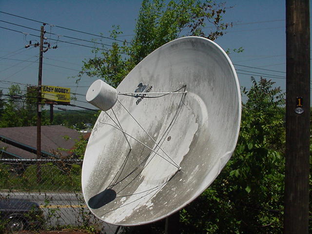

That button hook looks pretty strong. That dish looks like it could stand a world war. It has some heavy looking supports in the structure.
I have never had a button hook dish but many people tell me they sag down and cause the focal point to be off. I would say you could use some small gauge steel guy wires at four points of the dish with small bolt down type clamps and center it and hold it securely in the middle of the dish.
I would like to have that dish. It makes my sami 10' look like a piece of tin foil.

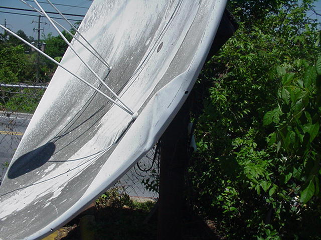

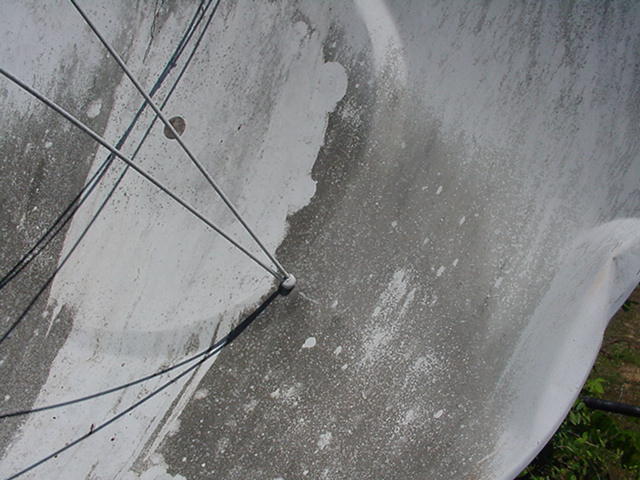

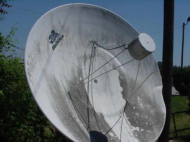

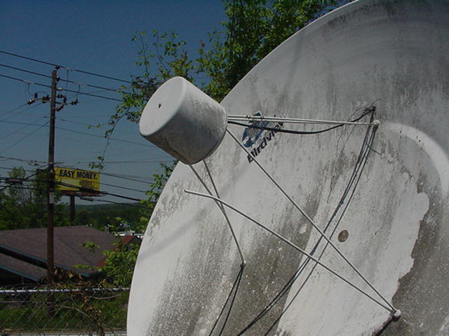

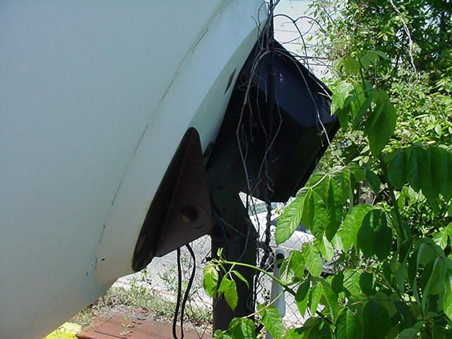

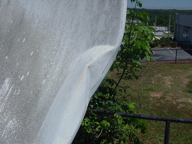

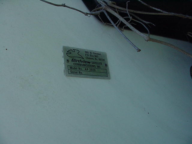

Hey Tom, I got off my butt yesterday and went out of my way and took some pictures of the Birdview for you. Actually I was close to Downtown and decided to take my camera and get some pictures while I was almost in the neighborhood. I went across the road 1st and that place is a Career Center, but they had signs everywhere going around back "Keep Out", "No Tresspassing", and "Employees Only Beyond This Point", so I didn't get out and turned around and left. I'm sure they won't want to get rid of it anyway? It's a 4 panel fiberglass 10' dish. Now back across the road and to the Birdview. After you see these, I'm sure you're not going to want to travel this far and get it? The dish is pushed in, on the side where the ding is, and where the mount ring from the back is at. You can see the indentations from the pictures. I got a hands on close-up look this time. Here is what I saw:
I'm sure the mount is worth getting, when I have more time, or I should say, when I'm in more of a mood, I will go and talk to the guy at the motel. I don't think I would pay what he wants or what you said you offered him? But you never know with me, I'm always subject to do not so bright things....
