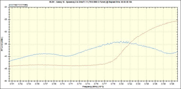

KRBK is horizontal polarity but there is another MUX that is vertical on almost the same frequency on the same bird with a fairly strong signal. maybe if you can adjust skew to null out the vertical signal might help peak the horizontal. At least that is what I am getting here...

KRBK2.jpg Latest scan shows the vertical TP is gone?? The second vertical TP at 3725 is also quite strong so makes sense that moving down 1-2MHz would help lock.
