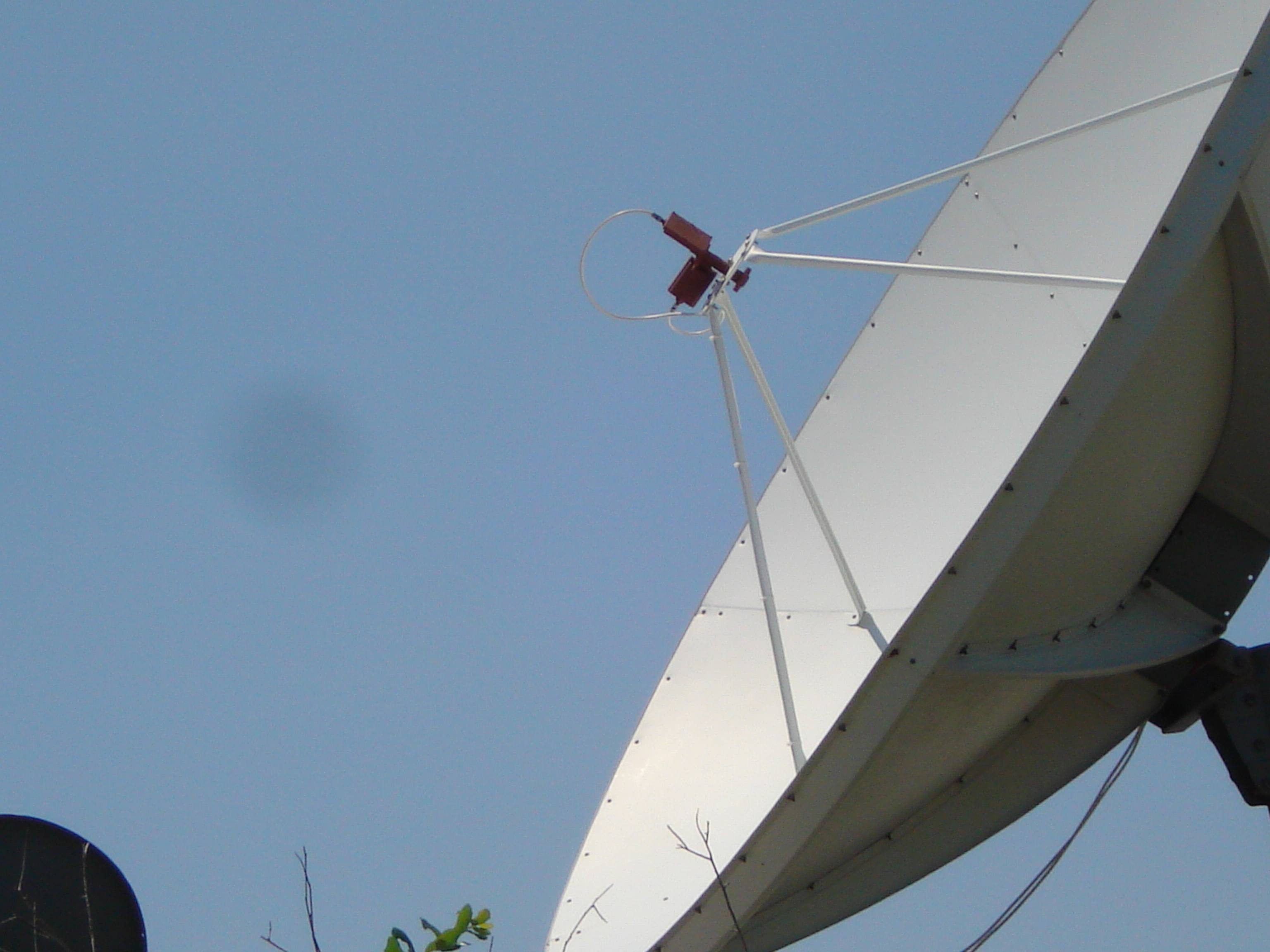

I know that is scrambled, but I already have the Sky receiver. the satellite as I know is Panamsat B6. PAS B6 at 43W, 60.26AZ, 39 EL, 51.42 Pol. Frequency 10722, Vert LNB 13V, Horiz LNB 18V , Symbol Rate 30000.
Position relative to Local Long 80.3, Lat 25.8.
There is the picture of the LNB that are been used here, but the guy that made the installation told me that he is ordering the LNB in the specific frequency, and charge me $35 hundred to get dish working, because he is the only one that know how to do.

which one Universal have this frequency, because all I've seen has 10950 to 12750. If you has the specification of this one that you are talking about, please let me know.
where have you been looking?
EVERY Universal LNB I've seen covers 10700-12750 MHZ
Iceberg is correct, as always. All I use are Universals---listen to Iceberg and you will learn. Chances are, if you disagree with him on these topics, you are wrong.
Do you mean he is charging you $3500.00 to do the installation???
Just what is he doing for that price?
