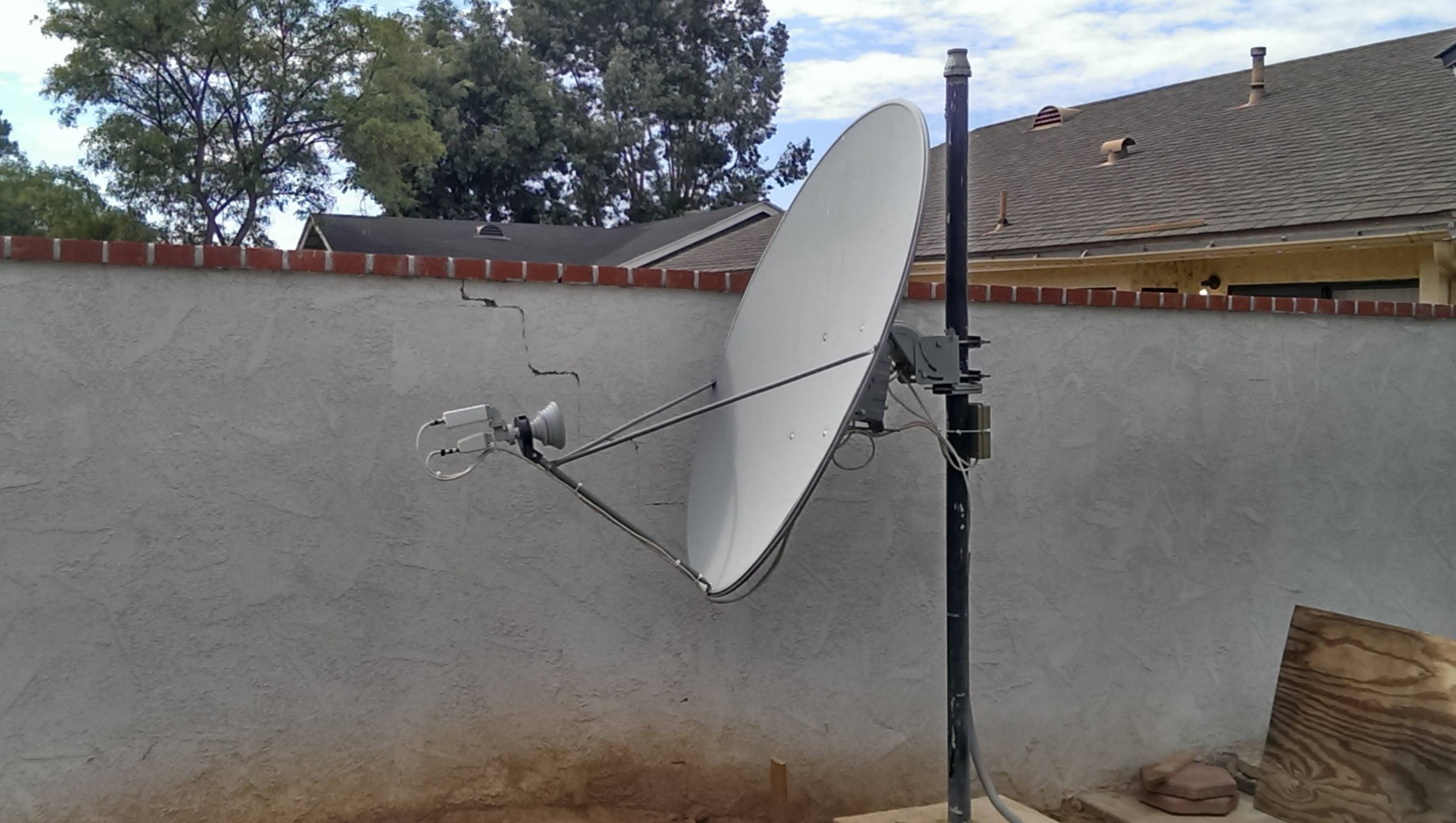

I got my multiswitch, It was installed in this sequence > Lnb's >multiswitch>motor> receiver, so far is working fine I can move the motor to any sat with no problems, the Q signal is better than the LNB I had in there.

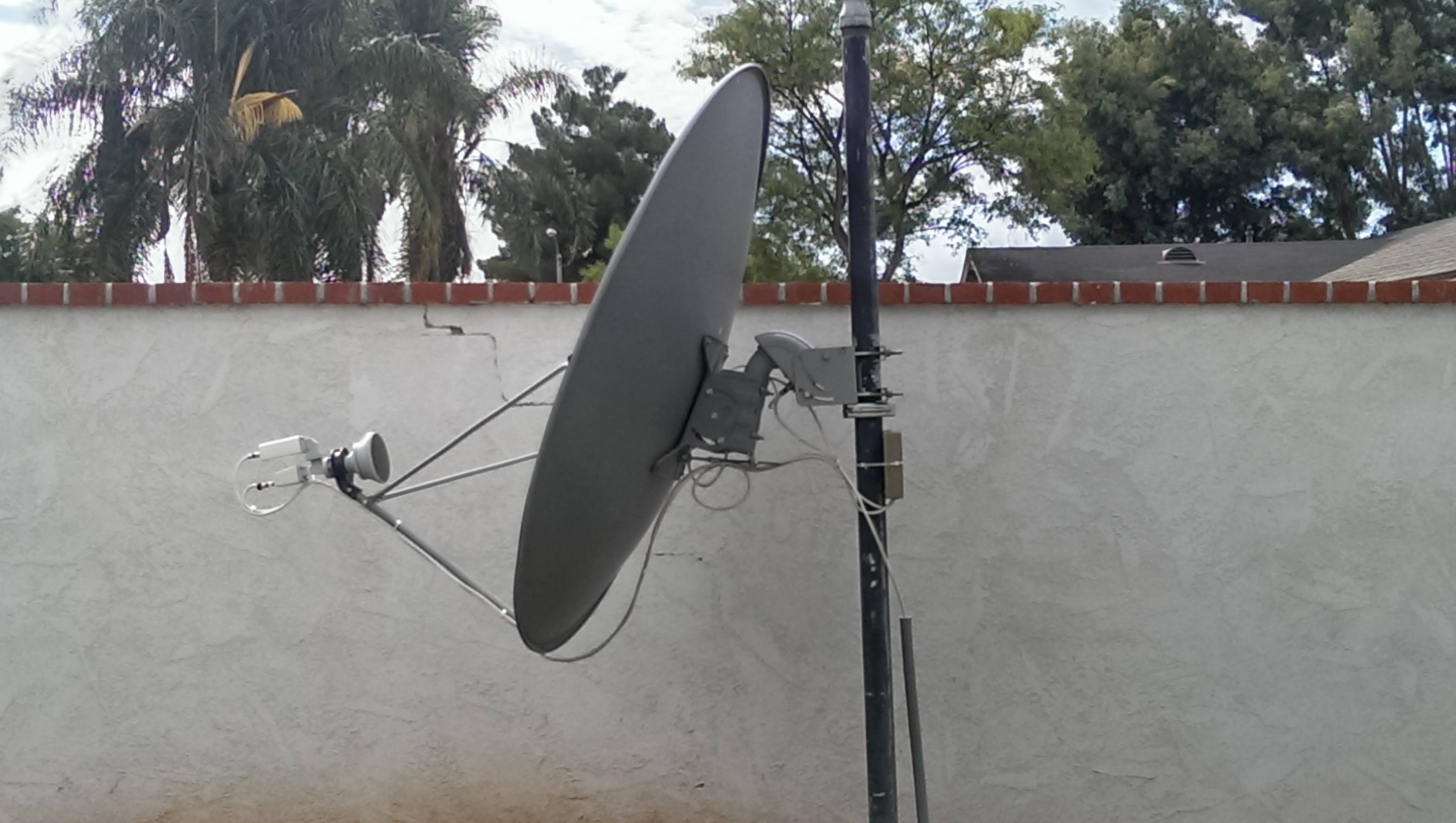

Here are some pictures of the final setup.
Thanks for all the comments.
Regards.
Chewie

In spite of all the distractions, it sounds like you got your original problem solved.
Great to hear it. Congratulations. :up
Just wire the motor in line between the master receiver and one of the outputs of your multiswitch, as described above. :up ;)

Well since we all talking about a few different things in this thread, I have a question, I want to buy the monster motor 6100 for the dish in the pictures that I posted, my dish is a GEOSATpro 1.2 Meter, now, the min. for motor tube is 55 mm for this dish, my question is, can I use 50 mm tube?
please let me know.
Regards.
Chewie
In the past, people have used shims.
Often made from a length of plastic pipe, slit up the side.
?I still think you'd be better off with a STAB HH-120 motor.
Thanks Mr. Anole
I believe the monster motor has a 50 mm tube for it, the STAB motor are hard to get here in the USA.
Regards.
Chewie
