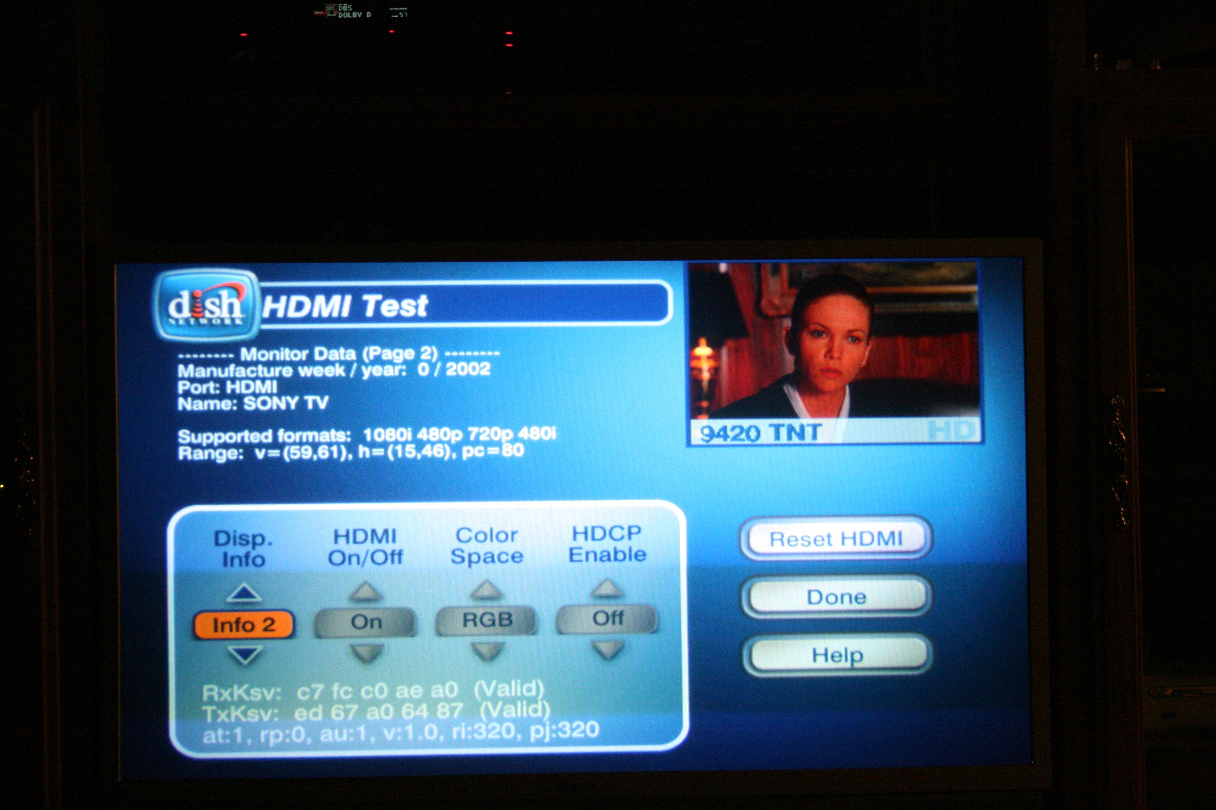

I just got the L 349 update. Has anyone seen this screen.
attachment.php
Check it out. You can reset the HDMI
You can get there by menu 6- 2 and than Analysis
attachment.php

Havent seen that screen. Boneman......have you had any problems with snow when you got L3.49 using HDMI ?
Did not check this morning to see if my snow was back. After I did a reboot last night the picture was fine. Thanks to this forum I was aware of what MIGHT happen with i got 3.49 and sure enough i did have snow until i rebooted.
