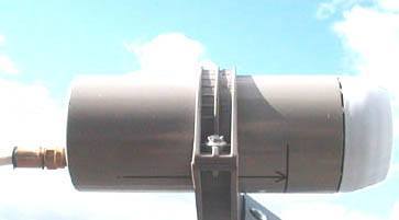

ahh yes the flashlight LNB holder
Sadoun has a LNB that would fit it
Tele-Comm T-1500 Standard Linear Offset LNBF LNB
Otherwise you could get a regular lNB and wrap duct tape around the throat to fit the LNB in the holder
That holder was used for a stacked LNB (aka the flashlight model)
The stacked LNBF (the second picture... the one with only one coax connector i.e. Beer Can) is larger diameter than the dual flashlight LNBF (first picture with 2 coax connectors).
