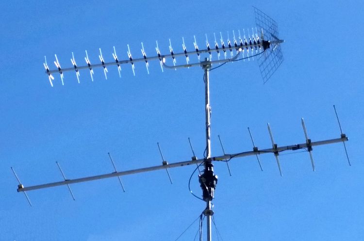

I'm coming late to this thread, but thought I'd show you what I use. At the top is the Antennas Direct XG91 for UHF and below it the Antennacraft Y-10-7-13 for high VHF. I can receive several stations, both VHF and UHF, from Walnut Grove, the transmitter site for the Sacramento/Stockton stations, located 65 miles away. There's a 1000 foot high hill about 10 miles away between the transmitter site and my home.
The antennas also work for a low VHF station that transmits on channel 4 from a mountain top 14 miles away.
I have logged a total of 134 sub-channels with these antennas.
I cannot use a preamp, as there are 12 full power stations transmitting from Sutro Tower just 3/4 mile away, but in the opposite direction from Walnut Grove.

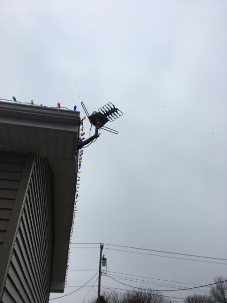

I bought a $35 one on Amazon.com. I am in Northeast NE which is approx 75 miles SE of Sioux City,IA where there is the Big Four Networks. With a cheaper antenna I could get all but ABC which broadcasts on VHF HI. So I thought I'd try the Amazon one and it comes in GREAT! I mounted it on a piece of 3/4" on my old DISH NETWORK mount on my antenna and used the existing RG6Q coax. I was really surprised when I found 6 more channels. I did notice the new antenna found duplicate channels.
Reactions: comfortably_numb
I see that KCAU is a VHF-HI station. How well does your antenna pull it in? Can you receive any of the stations due South of you?
I can get it quite well. That was the one station I was lacking before. Haven't tried south channels yet. The mast isn't secured enough for rotor to spin the antenna. Just sitting in dish mount. Hoping to try this week with some better weather.
I'm surprised at that antenna's VHF performance. Be sure to let us know your rotor results!
