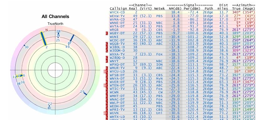

First start off with checking with tvfool web site to see what you have a chance of getting.(but remember the channels may change in the future with the repack)
Most of my channels are 60+ miles.
Any recommendations for an antenna in the $50 range?

You must live near Keene NH in SW NH or SE VT. You're going to need to spend more than $50.
Years ago before Digital Transition I lived in Leyden, MA. and no matter how strong an antenna I used CH3 out of Hartford was it. The valley I was in blocked other local channels..

Honestly look around and see what antennas you see in your immediate neighborhood. Where you live, I wouldn't expect much more than PBS from NH and VT, maybe NBC or ABC (WNNE and WMUR, respectively) but you never know. You're in the void between Burlington, Boston, and Albany. Springfield MA is mostly low power. Look at your specific address on the TVFool maps and see what the patterns are. You know exactly where you live and the broadcast coverage maps are pretty accurate. Maybe you can fiddle with the exact position to improve the numbers.
If you want an ABC, you're probably not going to get it OTA. A big antenna with a pre-amp may get you CBS but it will probably have to be on a rotor so you can adjust the aim for CBS (since it is off in an entirely different direction).
Weather dependency is a huge issue in a situation such as the tvfool table illustrates. I'd pretty much write off any of the two edge stations in terms of reliability.
