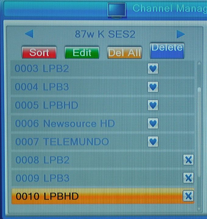

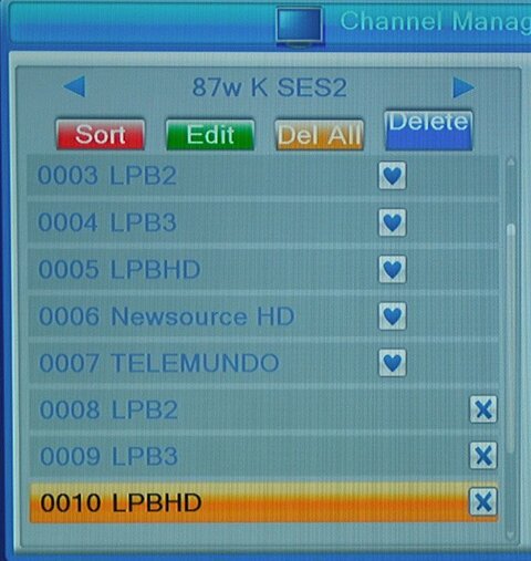

What I asked for is apparently is not a much wanted feature :D. So could I maybe at least get a way to select all but my favorited channels in the channel manager? So I can end up with a screen like this:
From there I can nuke 'em.
Notice how LPB channels repeat. I don't need multiple LPB or anything else that continually scans in.
You will not have duplicates if the TP list is correct. I suspect that there are two TPs scanned for any channel that duplicates during a scan. These TPs will be very close in the parameters. This could be happening if multiple Blind scans are performed on an LNBF with a drifting LO frequency.
Back to the original request....
To delete all but a few channels: Select "Delete All". Confirm the OK to Delete, but instead of exiting, select Delete and deselect the channels that you wish to save. Exit and save changes.
