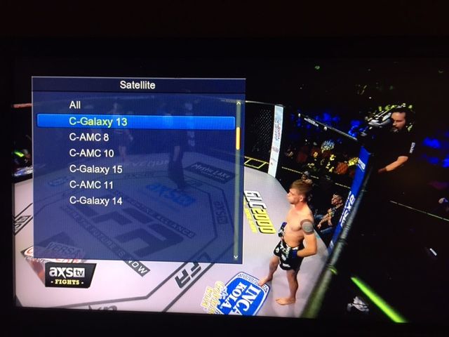

Without having done a backup before V0104/V0105 update had to go back and start over. Started at 139W C-band and worked east up to 125W for a trial. After scanning in these satellites, got out of the setup menus.
The channel select menus didn't appear changed. However, whenever the 'Yellow' button on the remote control is pushed - it brought up the screen in the photo below.
This screen is similar to whenever the 'SAT' button is selected on other receivers. The desired satellite can be selected from this screen, press 'OK' and then the dish mover activates (Satellite names and not positions are pre-programmed in receiver). This function was not observed prior to this update.
The main setup menus in the receiver appear to be the same as previous. Diseqc positions still automatic by sequence programmed, instead of inputting the position number. Picture clarity, even viewed on an old Sony, is still great.
