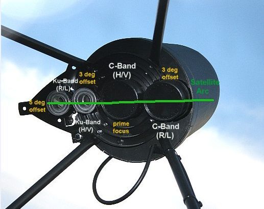

On another forum, tek2000 posted his feed system for picking up both C and Ku signals (both linear and circular).
I am sure something like that would work amazing, but who has the expertise to make their own?
The good news is that he said a commercial solution will be available very soon!
I like tek2000's feed system. I will plan on something similar, but all I will need is a KU (H/V) LNBF tacked on to side of the C Band LNBF.
