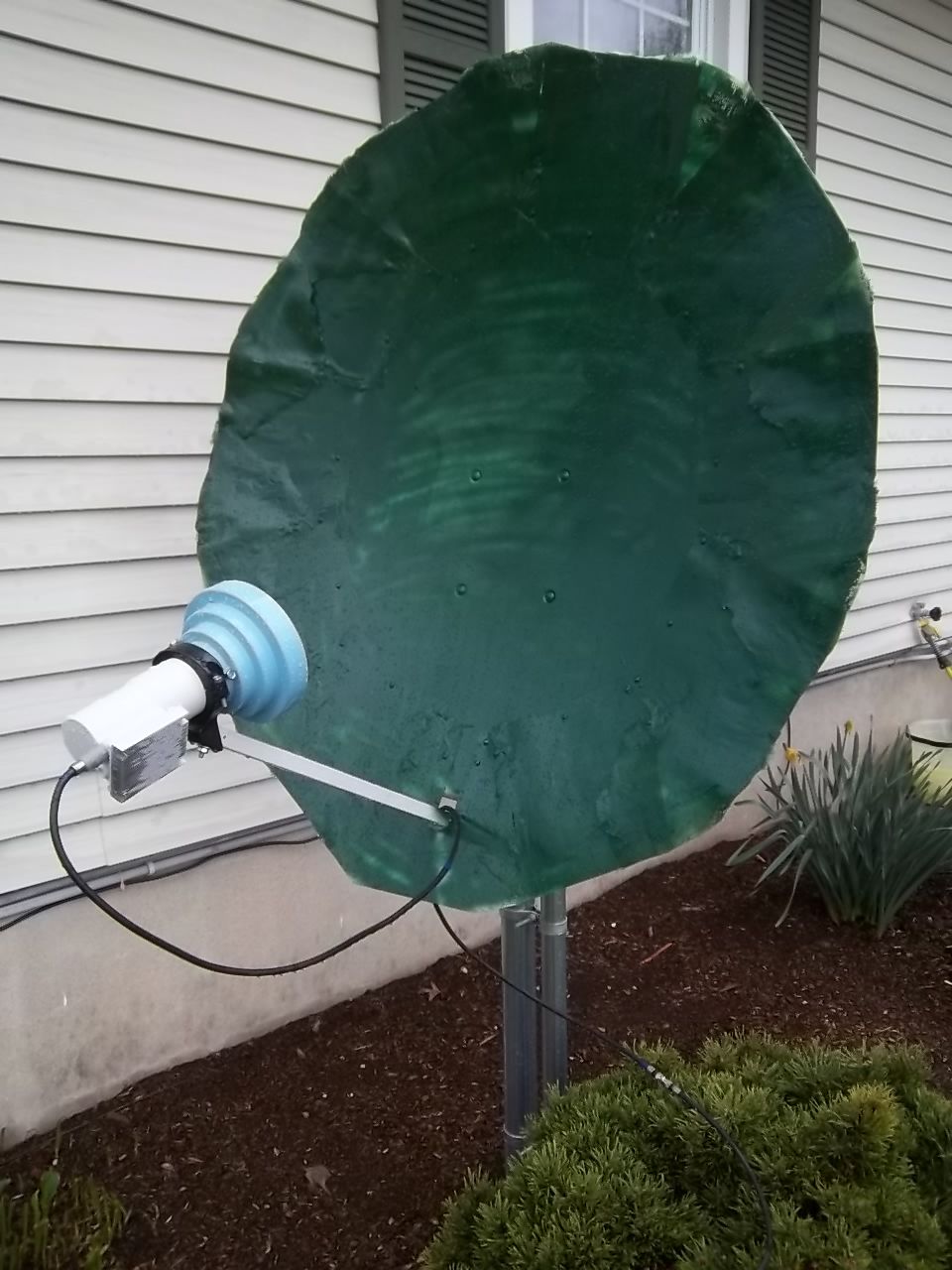

Final version of the ugly duckling 3-footer-to-4-footer C band dish. Works slightly better on C band than a 1m dish. Forgot to sand the sheet metal so fiberglass starting to separate in large fish-like scales. Non- smooth surface guarantees signal scattering. Painted an ugly green for aesthetics. Edges of dish are sharp, causing serious wounds. Cumbersome and flimsy design ensures difficult installation. Wear Tyvek suit, facemask, safety glasses and leather gloves when installing. Designed to ensure constant warpage thereby requiring many adjustments and trips to the dish, especially on cold dark nights.
Fantastic results can be had...see example of recent program received using this product below.
So step right up folks, taking orders now if anyone interested, hi hi. Comes with fantastic one day "no money back" guarantee..... if it makes it to your house in one piece. Free First-Aid kit included for the first four hundred customers.
Fun project though. Using it for Ku stationary.

Finally had time to compare the original 36 inch dish versus the home brew retrofitted 48 inch dish. In short, the 48 inch adaptation worked better for C band than the original 36 inch dish it was made from, but not by much. Here is a little table of results. Keep in mind that this was a home brew retrofit made from a 36 inch offset dish, not a factory-made 4 foot dish, so the results will not be comparable with a quality made factory product. Results are also specific to this location (Central NJ) so others may fare better/worse depending on terrain and obstructions.
To be sure I was tracking the Clarke Belt, I first fitted a Ku LNB and made sure the dish was optimized, then I put on a Titanium C band LNB & scalar ring, and did a final fine tuning even though it was pretty much on. Used the new AMIKO from NC-Electronics. Motor was a Stab 90.
The AMIKO was picking up a good number of TP's on a blind scan, but most "Failed". Understandable since this dish is at least 1/2 the size of a regular C band dish.
I scanned satellites from 20W to 131 W, including circular transmissions.
Satellite / Station/ 36 inch dish results/ 48 inch dish results
40.5 W - Christovision & Canal 21 /Not received/ Received well
55.5W - Bolivision /Received well/ Received well
58 W - RTPi /Not received/ Received well
58W -NHK World /Pixielated/ Received well
97W -AMG /Received well/ Received well
99W - Shepherd's Chapel /Received well/ Received well
99W- GDMX channels / Pixlielated/ Received well
99W -LESEA channels / Pixielated/ Received well
99W -NBC Affiliates - these were hard to evaluate since they were on then off, back and forth. Did receive them when on 48 inch dish when they were transmitting programs.
107.3 W- NWT Legis /Received well/ Received well
113W - UDGTV /Not received/ Intermittent reception
121W,- HITN channels /Pixielated/ Received well.
Interesting to note that AMG-TV on 97W occasionally was received when pointed to 99W. Bolivision also coming in pixielated when pointed to 58W. Normal for undersized dish to pick up sidesplatter from nearby satellite.
Fun experiment.

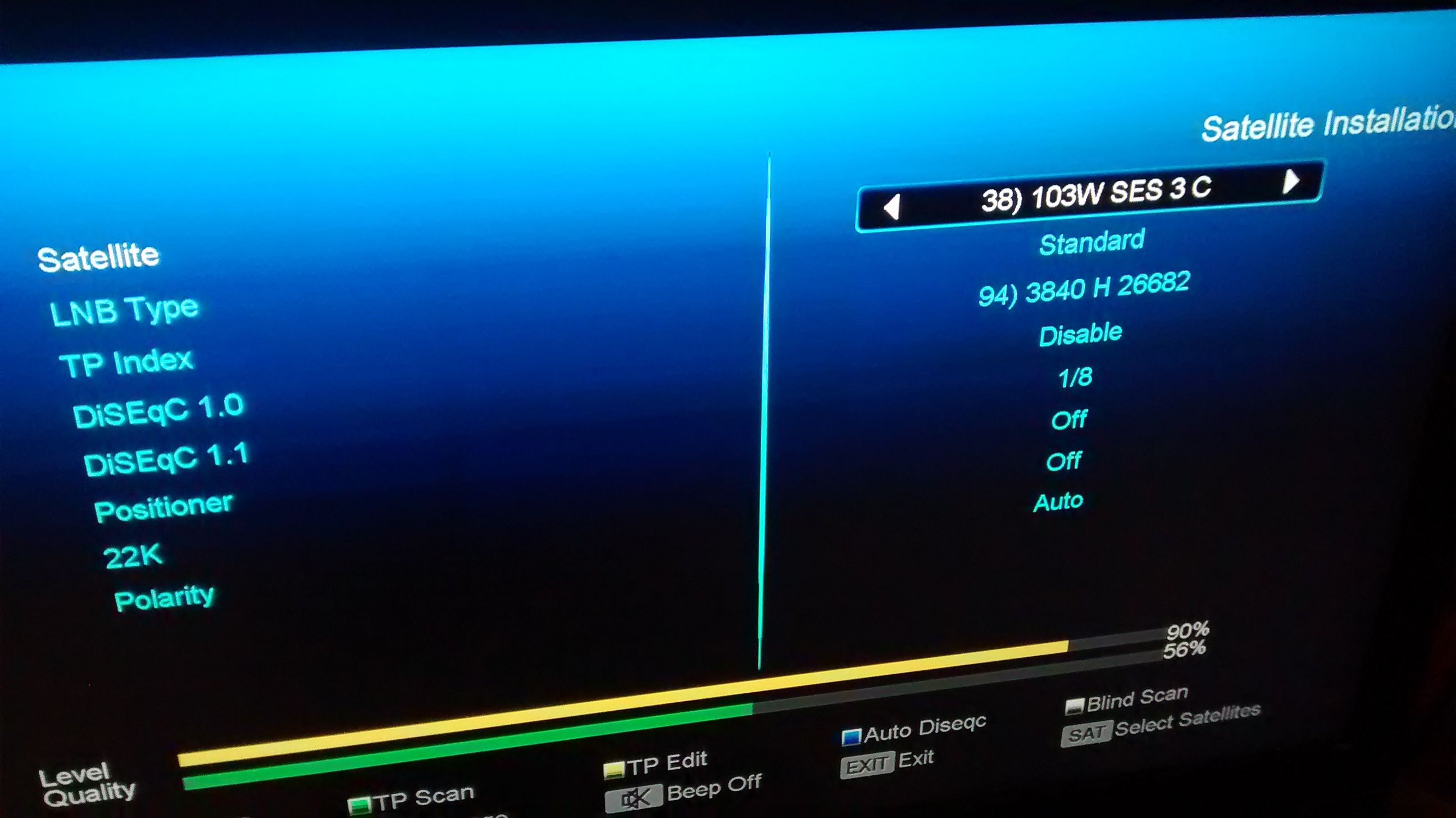

Have an update here ses 3 c band up to 3 transponders pbs, el Salvador and ion mux.
