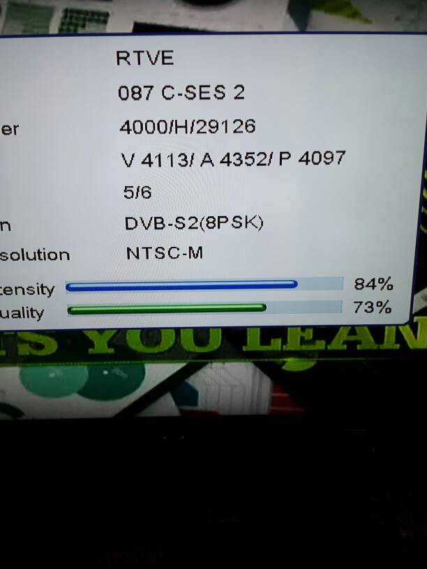

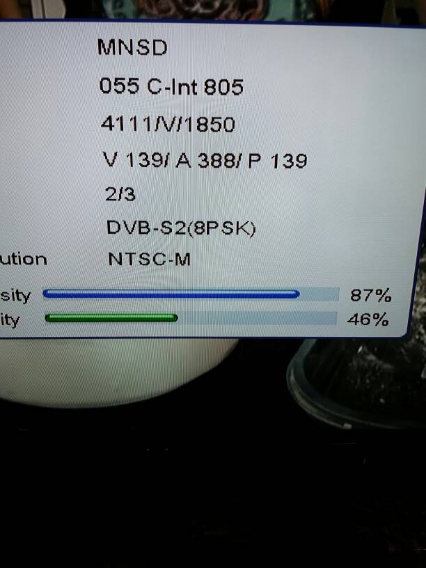

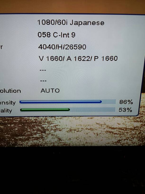

Hey Spongella, like Titaium (Bian) mentioned, you might get a handful of channels with the 36" dish, but it will get you by until you can locate a 1.2M dish. You asked about channels on 55.5W C-Band and a few others, I have more insiration for you! I spent most of yesterday working with my motorized 1.2 C-Band dish trying to get it fine tuned/aligned the best I could and managed to be within 1 degree off target; which I am able to compensate for. The Stab 120 motor developed 1 degree of play, but I am able to correct it. Anyway, using the Titanium PLL LNBF with matching conical scaler, I pulled in a good handful or so channels off of 55.5W C-Band; which I wasn't expecting to get. That got me interested to see what else I could get, and wowed myself by pulling in 34 channels off of 87W C-Band as well as one channel from 43W C-Band. I am using my old Manhattan 1933 reciever for testing until the newer Manhattan 1997 reciever comes in. So far I can't get anything east of 40W because of the trees and house next door blocking signals. I haven't been able to scan in all of the other satellites yet, but right now I can pull in 45 channels off of 58W C-Band including NHK World from Japan. I am getting about 84-86% intensity and around 67-72% quality among the C-Band satellites I have looked at. I am also able to pull in everything off of 99W C-Band. I do live in Kentucky, but with a 1.2M Geosatpro dish it is possible for you to pull in alot of the same stuff I am bringing in, even though your living in Jersey. I was always told my C-Band setup wouldn't work too good, but I wanted to try it anyway after studying the satellite footprints. I hope you can find a Geosatpro dish soon! With the C-Band channels I can bring in off of the satellites, I will gladly take it! Originally I figured I would only get 3 satellites, but went on ahead with experimenting, and glad I did!
Here's a few screen shots of the C-Band signal strength. The signals will always fluctuate depending on the time of day and other factors, but a clear picture and sound none the less. If I wasn't using the Titanium PLL LNBF, I wouldn't be able to bring in half of this stuff. :-)

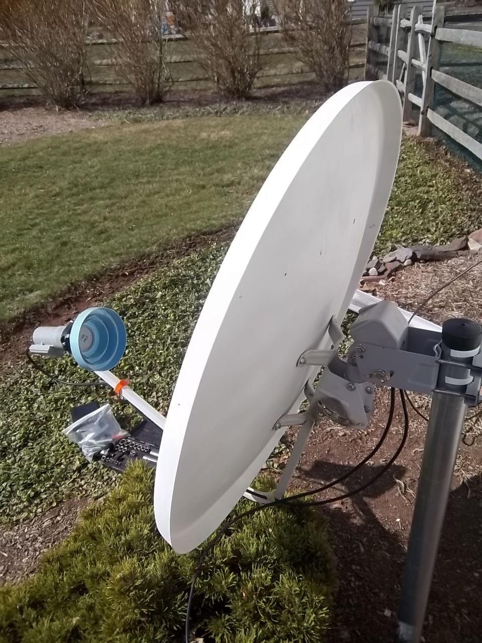

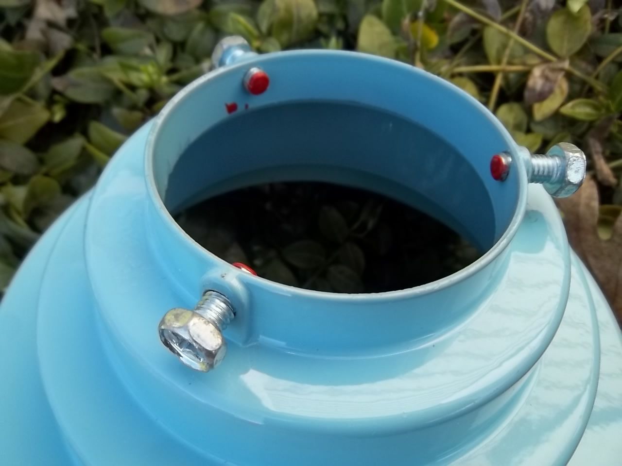

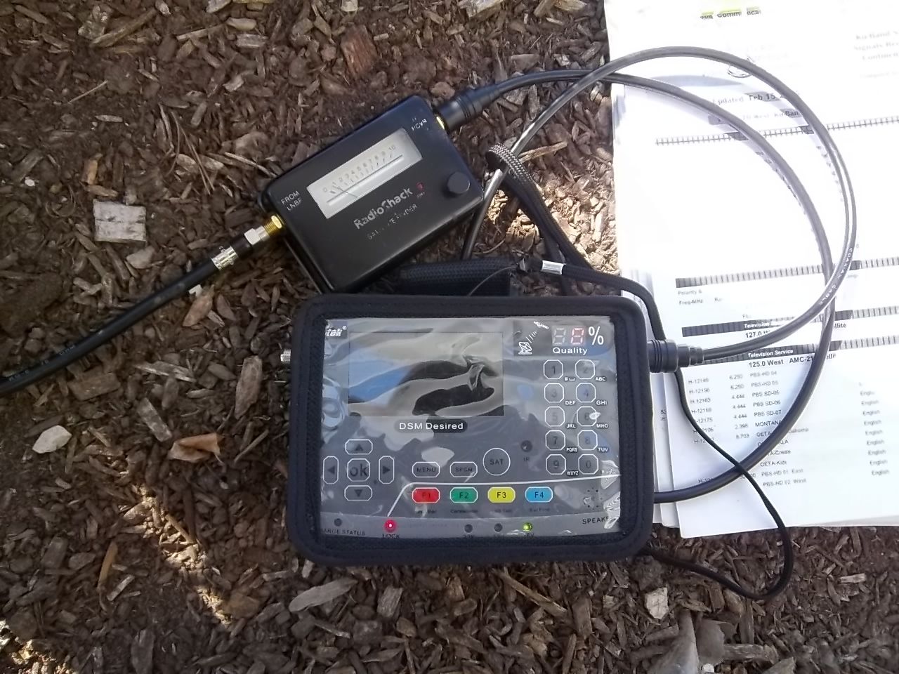

Thank you for all the helpful and encouraging comments. Earlier in the week I sunk a 2 and 3/4 inch metal fence pole into the ground a couple of feet, used no cement since the clay dries rock hard. Let it settle a few days. Also put a large spike through the bottom to keep it from twisting. Installed the Stab motor yesterday. Was too windy yesterday so waited until today to put on the dish. Hooked up an old BSC421 Cband LNB with a conical scalar to an old Sadoun 36 inch dish. I put a drop of Plasti-Dip on the end of the scalar tightening screws (see pic) to hold the thing in place better. Set the H-H motor to reference (0 deg) then pointed the dish magnetic South, then using a combo of the RS meter and new 8dtek Desired, turned the dish to 99W using USALS and adjusted the el/az for a meter swing peak. Did a scan and got 3 TP's, two failed, other one was a feed, I don't know where I am yet in the Clarke belt. Dropped everything around noon for Easter lunch, will revisit this later.
Note: The 8dtek meter doesn't receive MPEG IV but it is real handy for setting up a dish.It also calculates the skew (shows minus when it should be plus) and the azimuth too but incorrectly. I've let the manufacturer know about this. Should be an easy software fix.

You got a few transponders tuned in, sounds like a good start in the right direction. :-) As soon as you get a 1.2M dish, even more transponders will be within reach! :-)
Reactions: spongella
Maximize the SN without the conical attached, then add and maximize. Move the LNBF fore/aft to maximize then adjust the scalar again. You may have to repeat several times to optimize the combination of the settings for both the LNBF and the scalar positioning.
BTW... You likely will have better results with a different LNBF... Wink, wink, nod, nod, hint, hint... :)

Hint taken, hi hi. Yes, the LNBF and scalar ring were tweaked. Tried this C band thing on a 3 foot dish a couple of years ago. Also, found out that rotating the scalar makes a difference, don't know why.
The dish is pretty much on as far as accuracy, determined that by doing several scans of different sats. I used 99W as a reference since it has some strong TPs. GDMX is my "marker" that shows I am on 99w. I do see some bleed over of one station in the 97 - 99- 101W orbital slot, a religious program, probably due to the small dish.
Have a dual Ku/C LNBF laying around that was tried years ago with a mini-BUD, will try that again somewhere over the next few weeks. The advantage of the dualie is that you can optimize the dish on Ku, making sure it is tracking the belt correctly, then switch over to the C band. However there are some who maintain that a dualie does not work as well as a C-band only LNBF.
Thank you all for the comments.

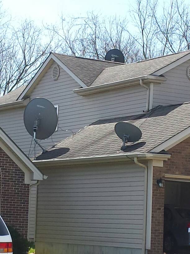

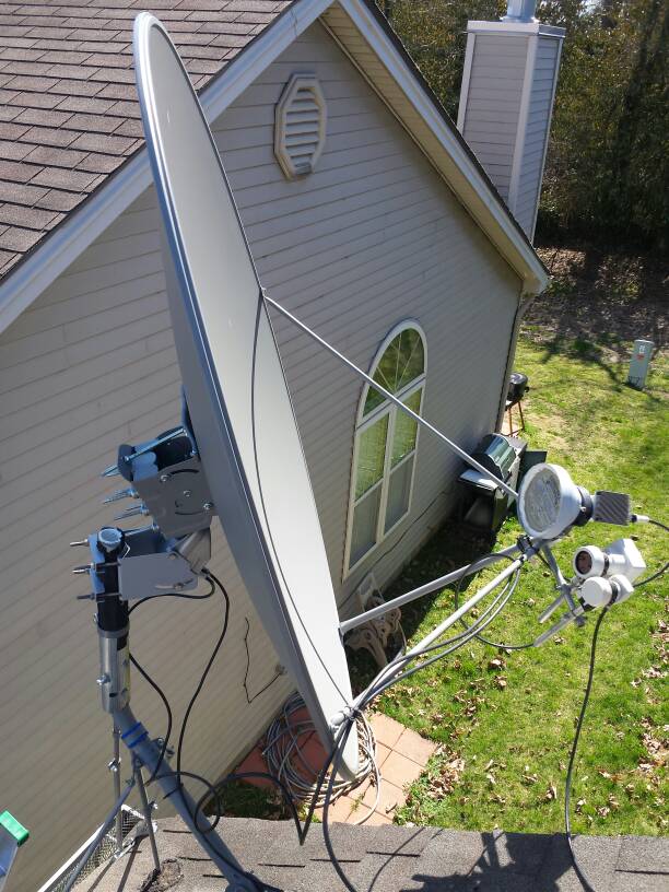

Hey Spongella, here are a few new pics of my motorized 1.2M C-Band Dish. I pretty much have it done, I just need to add a brace, swap out the already excellent Titanium LNBF for an even better updated Titanium dual output LNBF, run some cable, and start bringing in channels with the new reciever! Brian's (Titanium) LNBF is a very popular C-Band LNBF, you will have great results with it. I almost bought the combo C/Ku LNB last year, but I read they don't usually work very good, so I went with something else. The combo LNB's aren't made anymore, I don't think. Keep up the great work! :-)
