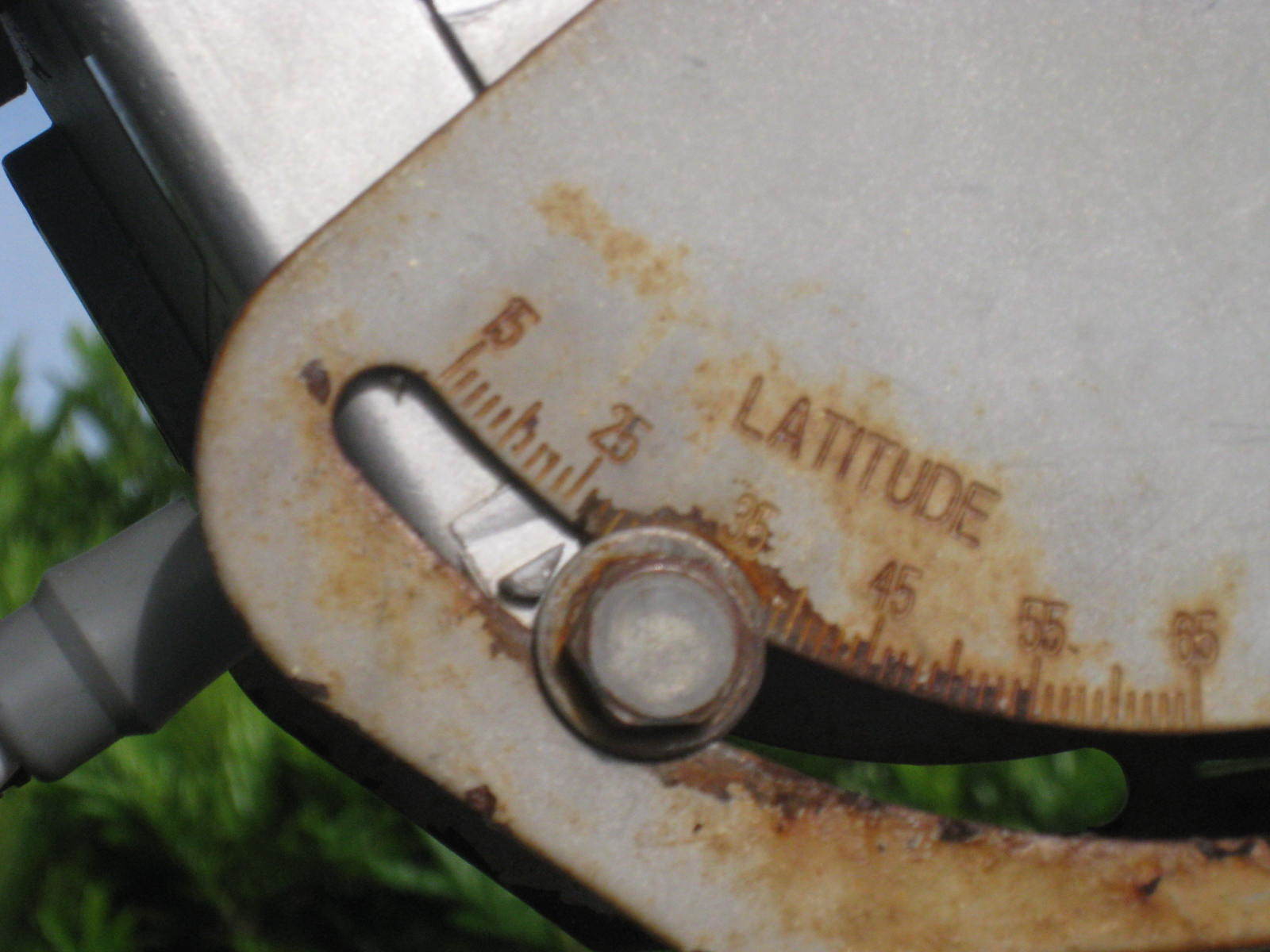

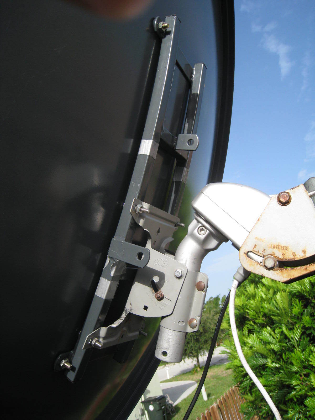

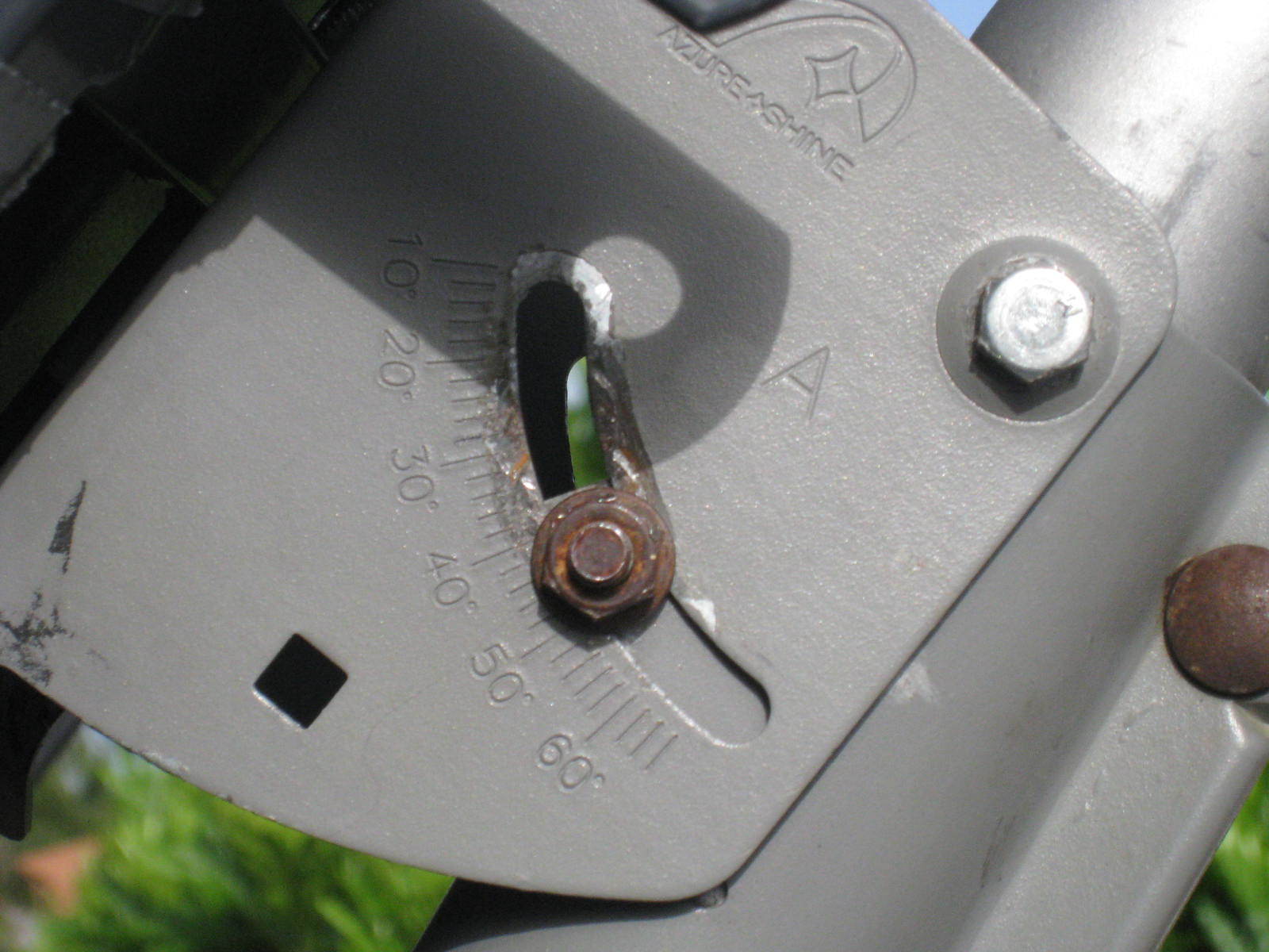

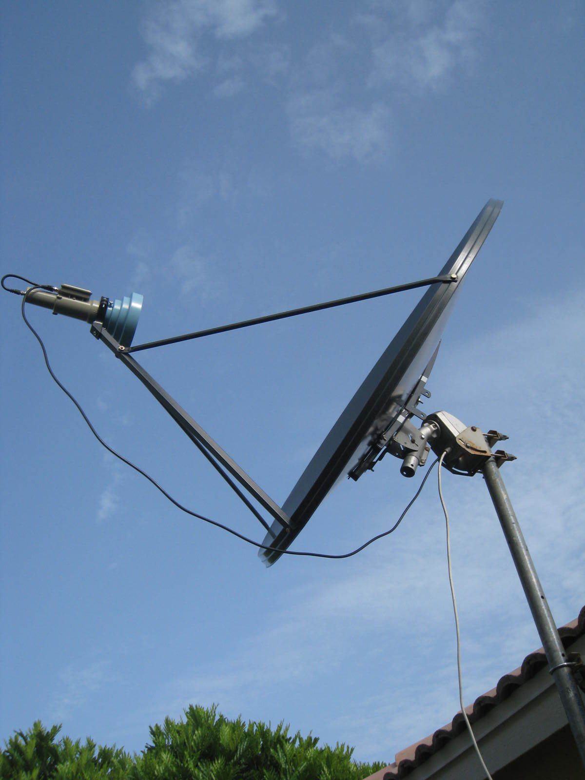

Since I posted those pictures I have changed the location of the dish bracket. Actually I went about 4" lower than the original setup. I lined up the motor with the two outside loop holes on the original dish Bracket. I also re-aligned the LNBF. It wasn't center. Until I have a chance to check the Arc and see where I stand I'm just going to leave it along for now.
Here are some pictures of my almost final setup. I'm getting some decent ku signals around the top of the Arc (72,74,79 and 83) the rest of the Arc is pot luck. Right now I'm not to concern about it. my big issue is C band. I'm not sure what I'm doing wrong. For example when I'm doing a blind scan on 89W I also pickup 91W. I get 121W SportsTime Ohio when I scan SatMex 6. Is this problem with this particular setup or is it me? By the way I had the same issue when I was using the 1mand the DMX 741U.
