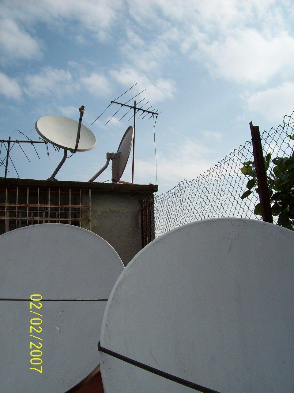

O.k. You guys have me intrigued with this sat. I have a spare 39" that I would love to fix on 30w. I've got a pretty clear view that direction, I just need to verify the elevation needed. My dish needs to be at 15.9° but if I recall correctly the signal comes in from more of an angle than that. What angle should I be checking to make sure I get a clear LOS? I need to take the green laser out there tonight and see if I can put a dish over that way.
ynnedibanez is in Greenville TN, he recently posted some pics for his dish aimed at this bird and it does look pretty vertical,
I know the "elevation" is tricky for this sat.
In my case the dish is looking down (upper right corner)

O.k. thanks! I got confused on that. It was that the dish doesn't appear to be at the elevation of the sat. O.k. I'll have to check on this tonight.

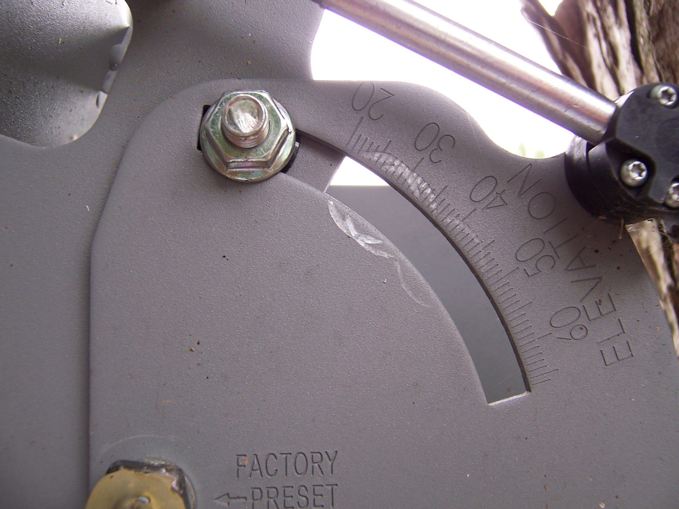

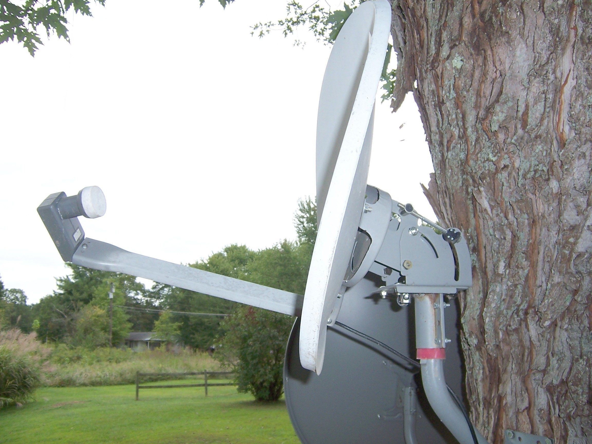

SpiffWilkie,
Here are some pics of my dish aimed at 30w. I'm near Crossville, TN(lat. 35.9 N and long. 85.1 W) and using a DTV Slimline dish measuring approx. 32x23 inches. Had to set the elevation at 20 degrees and skew at about -45R facing the dish. Locked it on the first try with a 70 to 75 SQ on the coolsat 6000. Memphis is about 300 miles west of Crossville and I am on the Cumberland Plateau at about 2500 feet elevation, so you might have to make some adjustments to your dish elevation. Have a good day and good luck!:)
