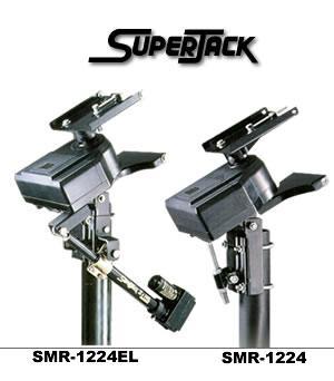

Apparently this is valuable for very large dishes which are more sensitive to a satellite's minute deviations from the clarke belt.
lol leave it to harold to find one yep its not like to contraption i've seen but this is one that works the axis & elevation .....

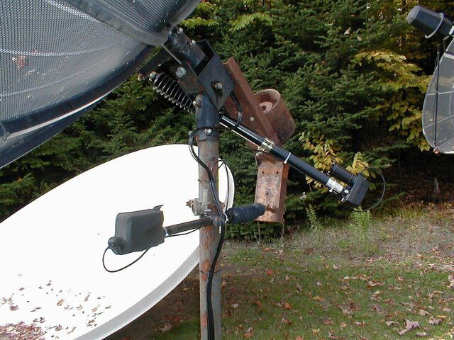

Is this not the kind of setup (two actuators, vertical and horizontal, computer controlled) not used in applications such as tracking the sun (power generation) and non-geostationary orbits?
I rigged my Unimesh dish with an actuator to adjust the elevation back in the 80's when I wanted to maintain signal on certain inclined orbit birds.
Here is a picture of the dual-actuator setup I'm using. The receiver is a Chaparral Monterey 140 and has connections for both actuators. The receiver can also automatically track the elevation by using the AGC circuit.

Hey that is awsome,I knew they had some out there somewhere,Or it could be made.I had one back in the 80's Thanks alot .
