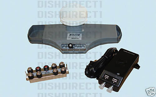

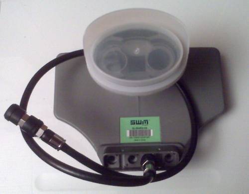

Just to intervene here for a second. Nobody has mentioned lnb or switch. They both have to match, not just any swm lnb or swm switch will work, no mix matching. I do not know the correct terminology but the lnb & switch both will have a green dot on them which indicates mrv capability.

Here is the difference with lnbs for the h24 receivers. The same applies with switches, did not take time to download pics of switches. Pic of lnb on right is the 1 compatible with the h24 receivers for mrv.
