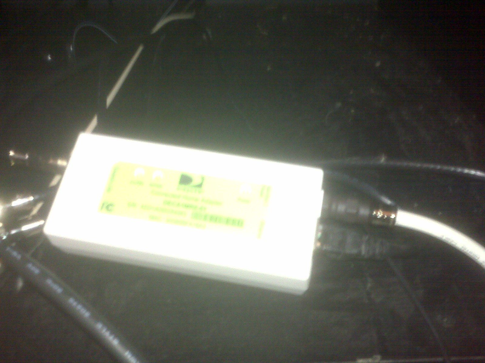

Can't you just plug a Ethernet cable into the white box with the green lights and it spreads to the other receivers?

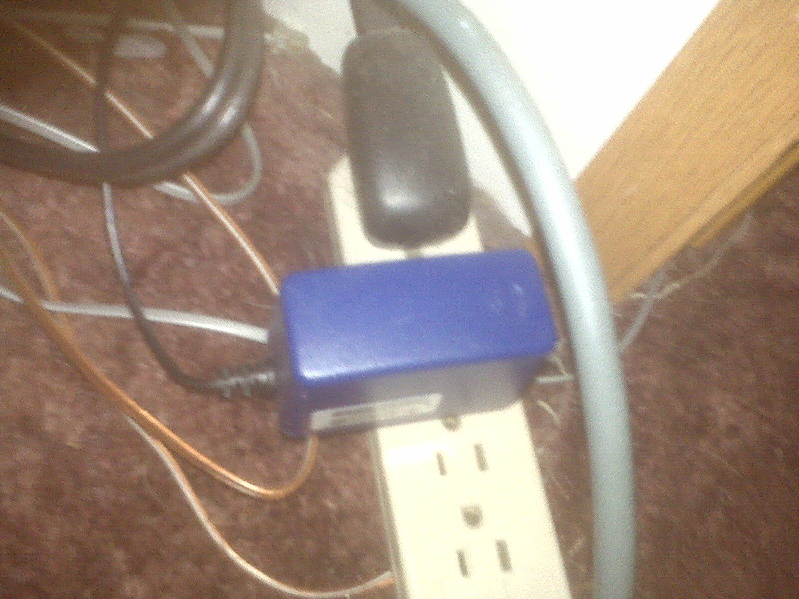

you need a coax cable from your swm splitter to a deca unit. Deca unit needs to be powered. and the ethernet cable from the deca needs to be plugged into your router.
<deca power supply.
<deca power supply.

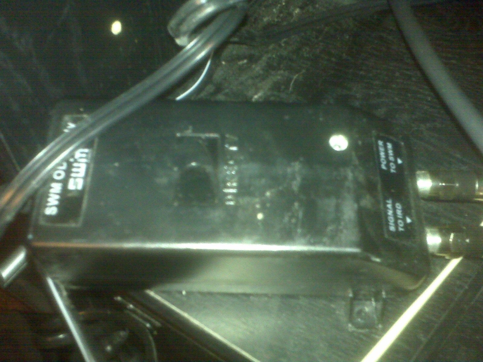

Yeah I have one of those on my 24
Sorry for the bad PQ, the wife has the camera so I had to use my BlackBerry, not a good camera.
Maybe I was wrong but I saw the blue plug and thought that is the one they used on mine.
The installer said it was needed to get MRV to work.
