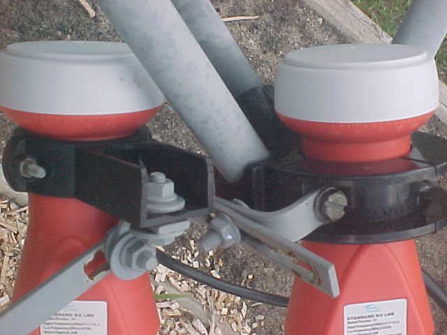

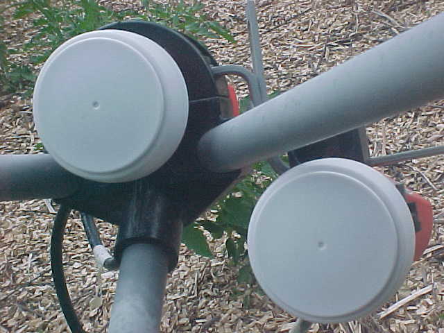

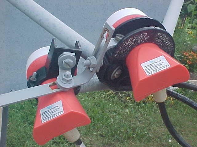

Here's my redneck rig for 123/129. Going to try to add 125 when I get the time. Just made from 1/2 x 1/8 mild steel and some scrap bolts and an extra lnb holder.
