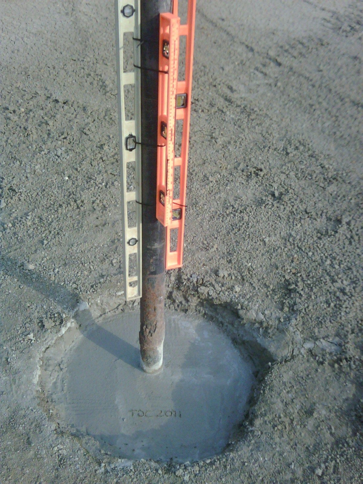

Congrats on getting the bud. You will love this hobby. Yep start with your true south satellite and work from there. Yeah you could play around with it a little without the polar rotor hooked up. Just get it turned to horizontal or vertical and look at lyngsat for a hot transponder on the polatiy you have it on for your true south sat and see if you can find it. If you have never set one up before, it can be a little bit of a pain until you start understanding everything. So don't get discouraged and read, read, read, and ask questions. You will figure it out.
This is of course if the one on it is working. So don't drive your self to drink if you don't get anywhere until you get the new one.

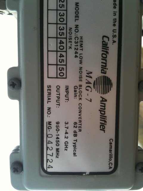

If I use the existing LNB, do I need to use the old receiver for the polorator?
If you want both polaraties, yes.
Or can I pick up some channels without the polorator wired up?
Yes, but only the polarity that the feed is on. It depends on the position of the probe in the feehorn. If your "south satellite is directly south, it will be perfectly vertical, for vertical polarity and horixontal for, well, horizontal polarities.
Note: the new FTA receivers control a new style LNBF polarity selection via the voltage supplied to the LNBF. 13v for vertical polarity and 18v for horizontal. That can pose a problem with most LNB's designed for use on a servo polarity controlled feed. Most LNB's don't work that well, or at all, with only 13v. They are most happy with 18 to 24v. So for this to work, the FTA receiver has to have horizontal polarity selected. but the feed(servo) can be adjusted for either polarity.
Should I initially set this up pointing true South and then work on setting up the motor?
That's the first step. adjusting the elevation, on your "south satellite" With the actuator, move the dish so it's at it's highest, and measure the angles of the polar mount and that of the dish. The difference in angles is the "declination". use the modified "declination ofset" angle on the second chart on this page. Footprints by Dish Size - Latitude Declination Chart - C/Ku-Band Satellite Listing and adjust as necessary.
Set your polar angle to your latitude + a fraction, as shown on the same chart and rotate the mount on the pole to get Q on your south sat, then adjust, fine tune, the latitude angle for Max Q reading on the receiver. (you must be monitoring an active transponder)
The azimuth is adjusted away from there, towards the sides of the "arc".

blx, if the dish you found was operating in the past, and it wasn't very far away from your location, you might not have to worry with making too many changes. If you took the dish down off the mounting ring, and removed the mount from the old pole, the mount probably will be close to what it should be for your place. I've moved a couple that were within 10-15miles from my place and only had to re-assemble the dish to the mount, then locate the north/south axis (by rotating the dish&mount on the pole). Won't know until you try! Of course if you bought the dish in pieces, it will be a good experience to do a ground-up install, you'll gain information on just how it all works. It's really not that difficult to do.

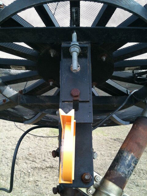

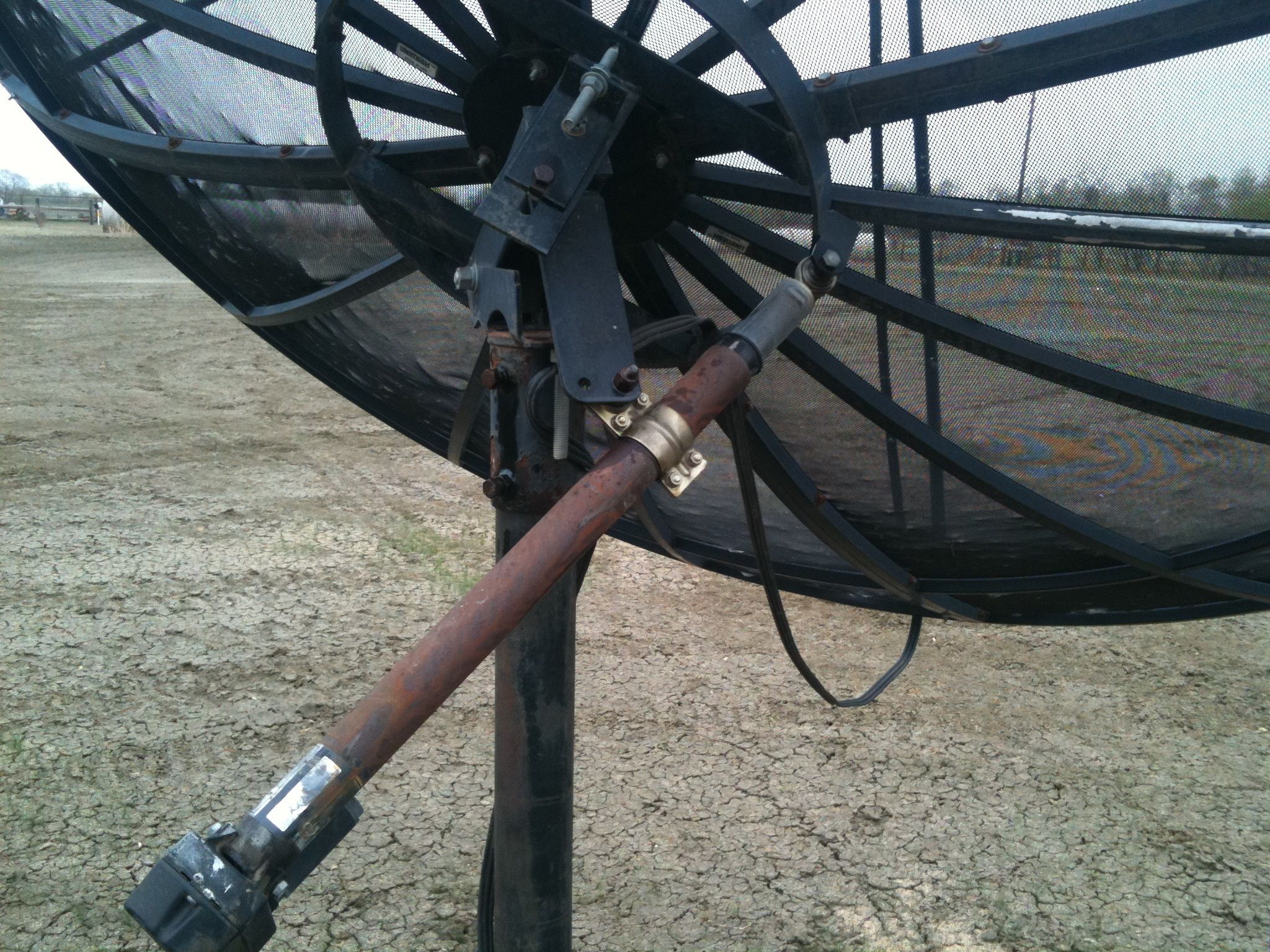

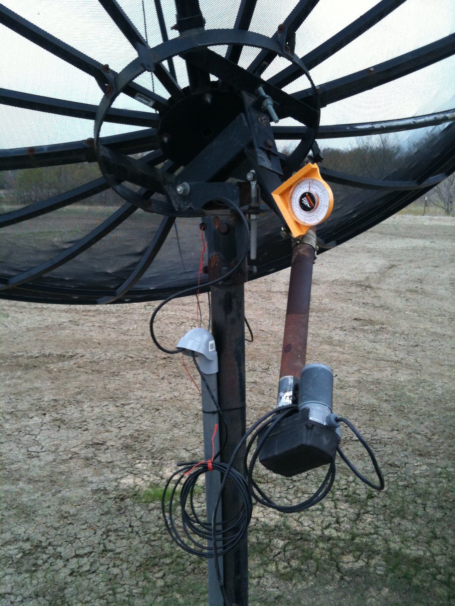

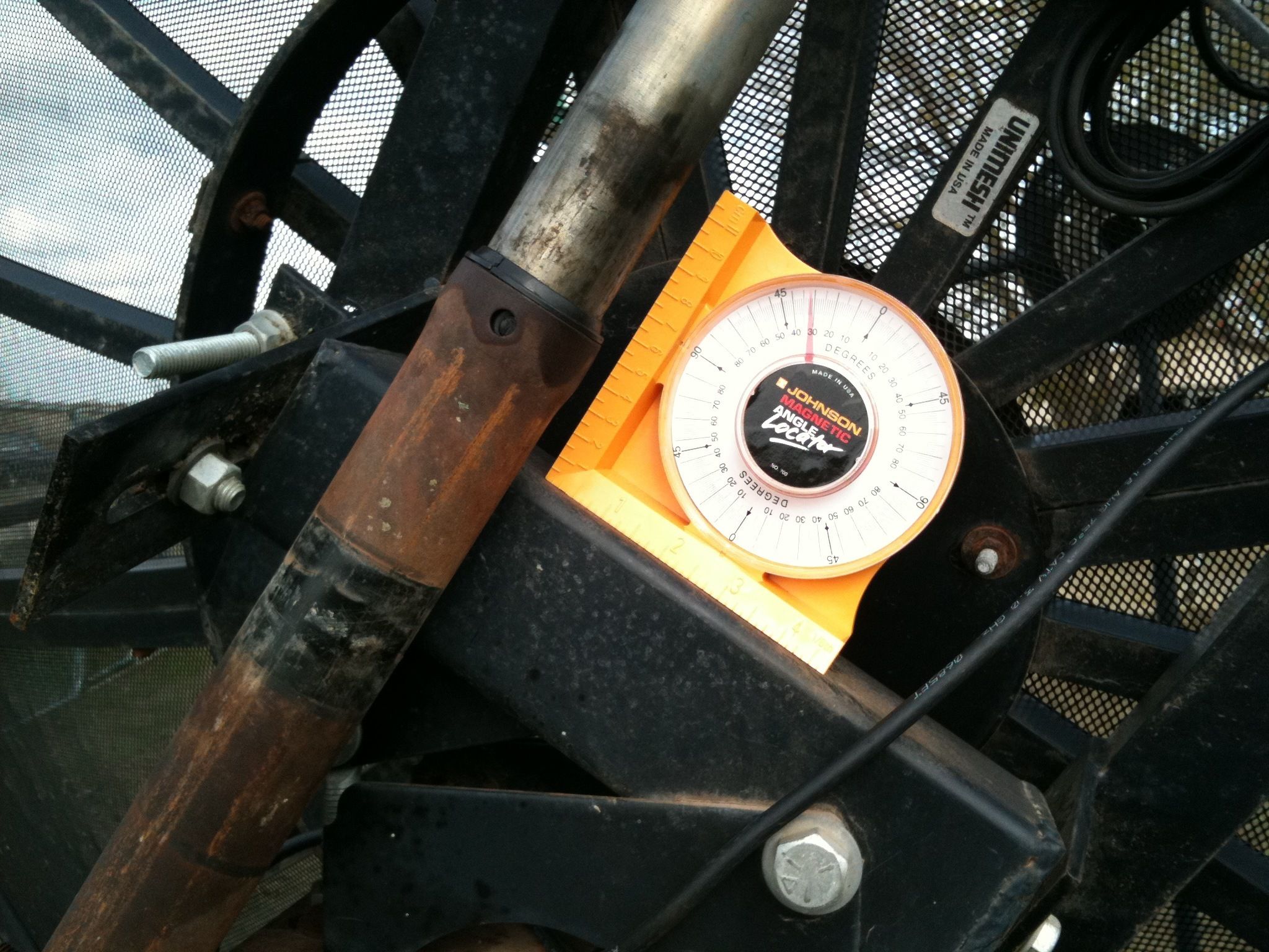

Just a tip: in the 3rd pic your actuator motor is down. It should be in the up position to keep water from collecting inside. :)
Thanks for all the replies. I picked the dish up about 120 miles from where I live. I am in North Texas and we are pretty flat up here, so I thought the angles would be about the same. I looked at dishpointer and swung it into what I thought was the true South position.
I then got way ahead of myself yesterday bringing the receiver and a tv out to the dish and trying to find a sat. Didn't get anywhere and wasted a bunch of daylight. I'll see if I can make better progress today.
I noticed that last night when I was looking at the the pics I took before I removed the dish. Thanks for catching that.

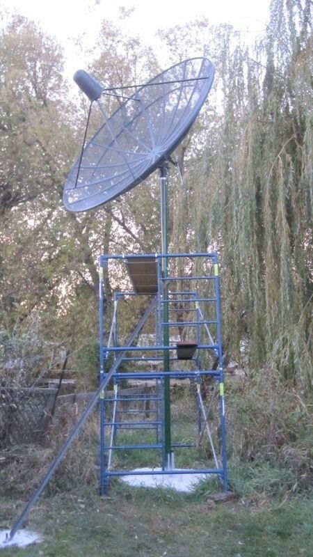

I am in the same situation as you with the exact same dish except that I already have a farm of ku dishes. On the BUD I was frustrated with not getting any signal until I went through and checked all the dimensions. I found that the previous owner was a full inch out on the focal depth. I made the change and it was a rewarding moment when that quality bar red-lined when it hit its first signal. My motor also worked, but I pulled it all apart and cleaned a lot of rust and dirt off the long threaded shaft. Had I left it I am sure that those white nylon gears at the end would be stripped in no time.
As mentioned up the page, I wouldn't fool with any adjustments on elevation or declination until you get your "stuff" together.
FYI, when I moved my 10ft dish from my old house to the new one, all I did was park the dish on the west limit, moved it and connected the receiver back up to it then went to my most west satellite. Then went out to the dish and moved it on the post (left and right) until I peaked the signal and believe or not it stayed that way for about 9 years before I went to tweaking on it further. And to be honest, it wasn't "that" far off! Of course your 150 mile move may be different but still I wouldn't expect it to be too far off.

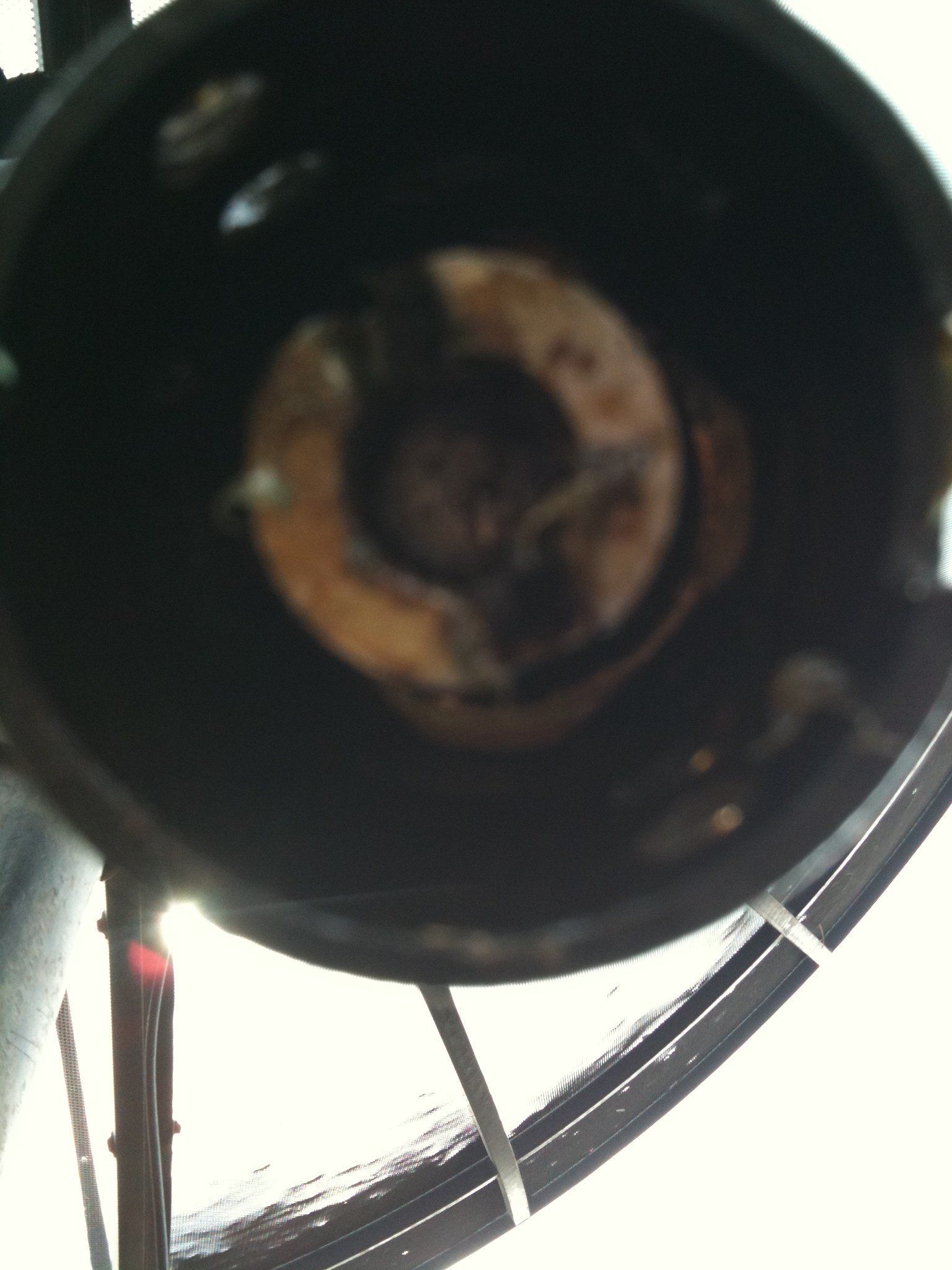

Got the cables pulled, got the motor turned around right, got some pics and more questions. I went out to dishpointer.com to try again and see if I was pointed in the right direction. I have a stupid question. On dishpointer for a motorized system, there is a true south. So I am trying to aim at true south not a specific sat, right?
Cleaned up the actuator a little, took the motor off and cleaned the rust and crud out of the bottom. However, I can only get it to extend about 6 - 8", then it stops. It should extend out close to 24" right? I need it to extend all the way out before I can line up on the south, right?

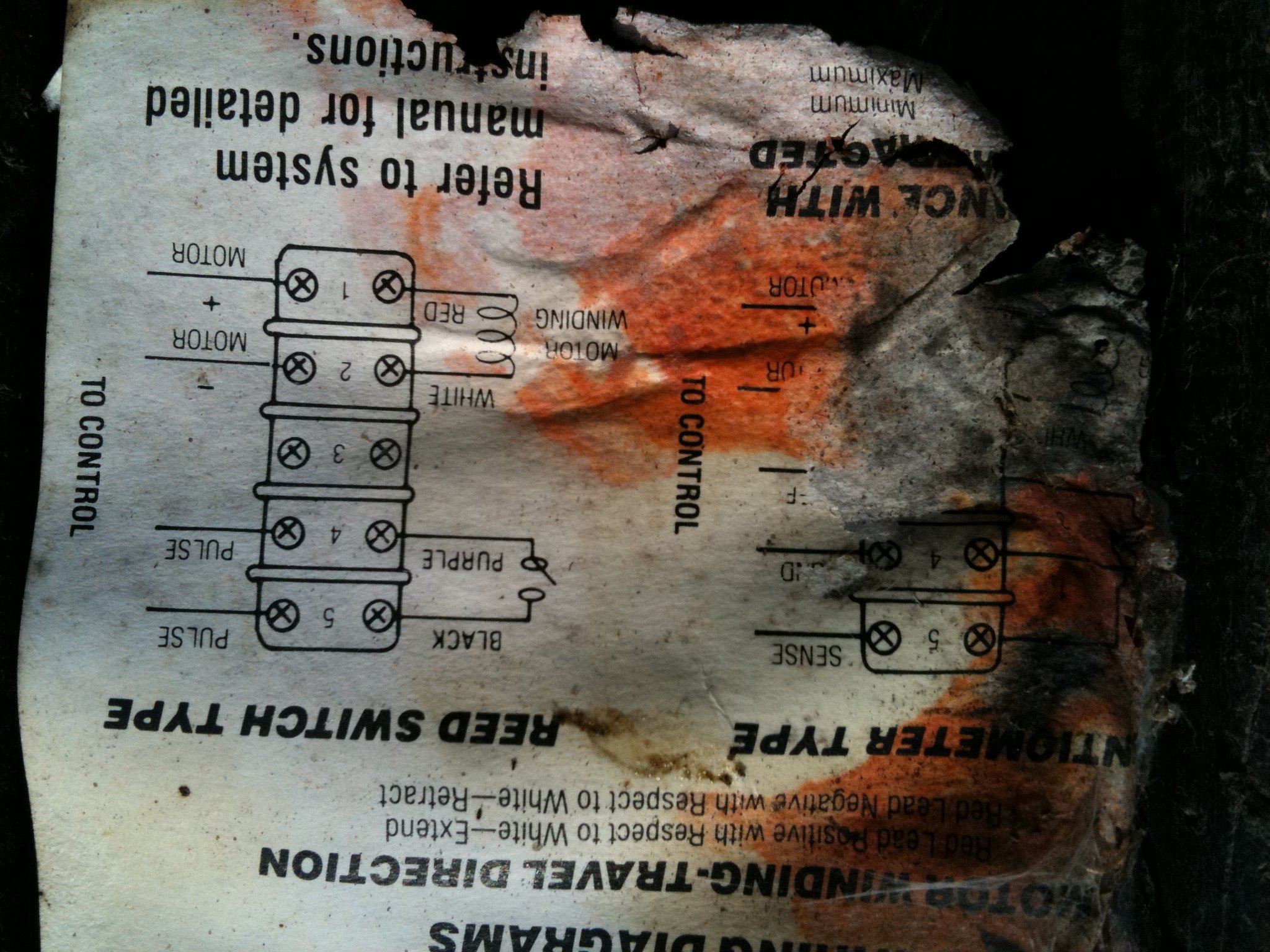

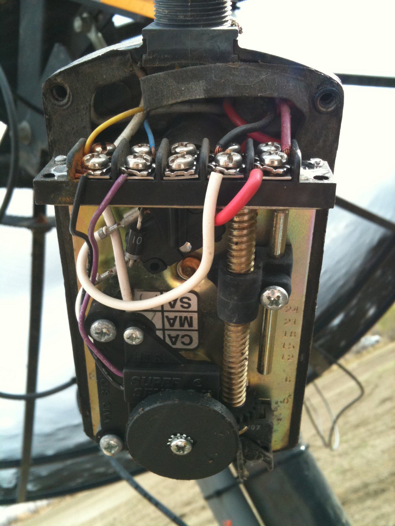

Took the cover off the motor and there was a scrap of paper in there. So am I reading it right, do I have a reed switch?

Yeah that thing underneath the round magnet is your reed switch. The motor is a Venture/HTS & parts are very available.

You probably have some dirt or rust in the threads. Take the three short bolts out at the base of the long cylindrical chrome cover. Mine are tamper-proof bolts. Rotate that cover off until the full threaded rod is exposed. You then will be able to see if you need to take a wire brush to the threaded rod. I used a wire brush on a grinding tool.
Having no wire on terminal 3 confirms you have a reed switch. It is a "normally open contact" (dry contacts) that provides a pulse signal. The same technology is now used in the new gas and electric meters to send the consumption readings over the internet.
Yeah, I hope it something simple like built up crud. I've got to take a better look and see if I have those bolts. I emailed Venture Manufacturing (in case it was one of theirs) and they sent me the following instructions:
Check limit switch to see if the extend switch is activated. This could be cause for not fully extending. If not see attached. To disassemble actuator remove pin #6 and actuator will come apart. Align pin with knockout holes. Remove 1/4" pin with punch. Check screw for rust. Clean and lube.
Not sure if I can post the parts diagram here, but they sent me one that shows the pin they are referring to. I should have enough daylight on Friday to take everything apart.

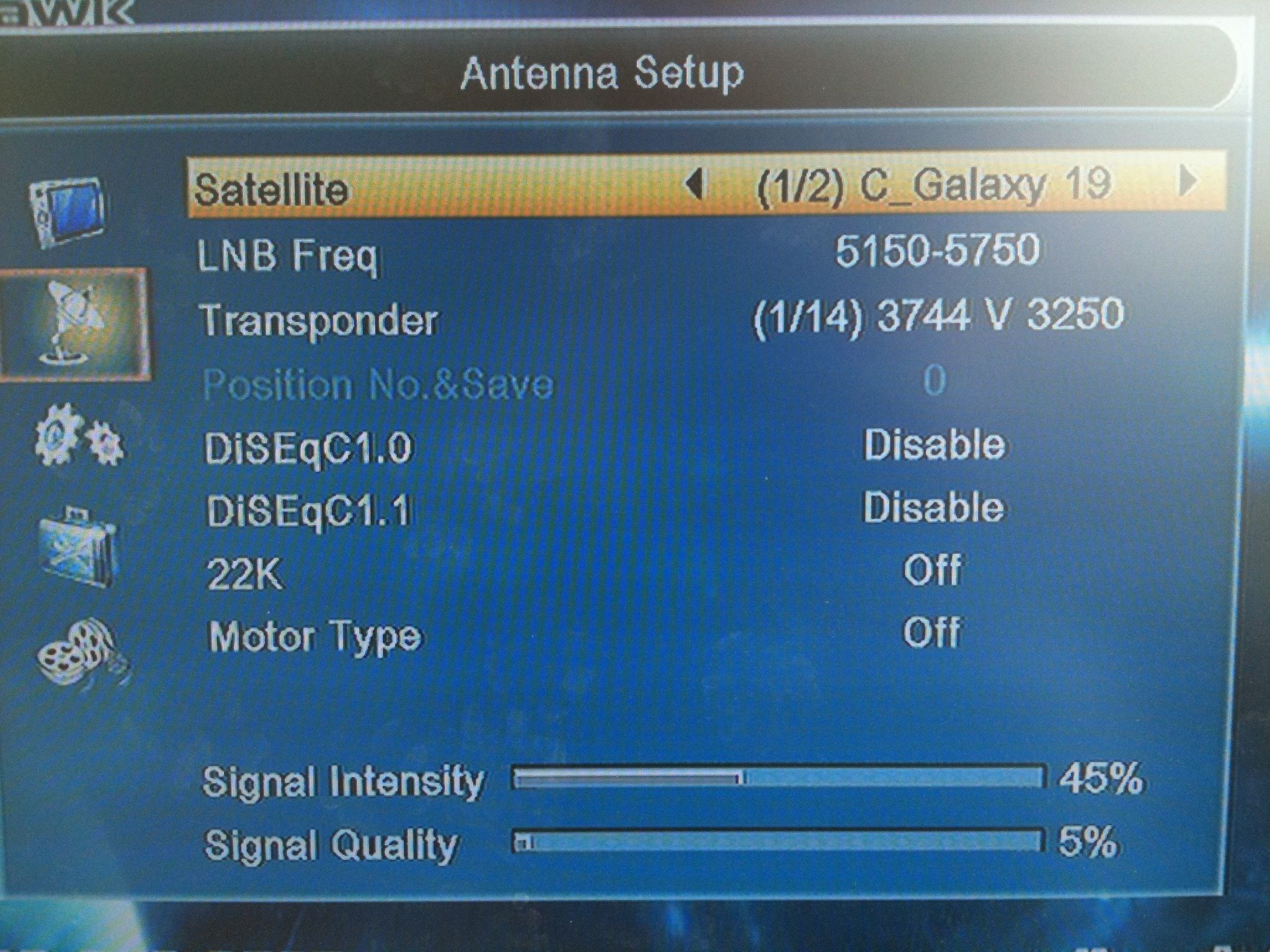

I'm also not sure if I have my openbox set wrong, see pic 3. It shows 36% signal, even without coax connected. With the coax connected and LNB power on, it shows 45%. But the strength doesn't change regardless of where I move the dish. I'm not sure what TP info I should be putting in here, but I have tried several and nothing changes.

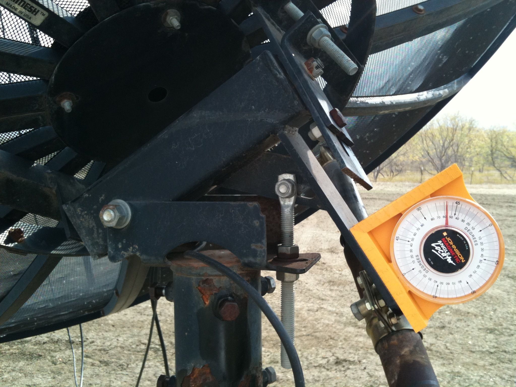

I think pic 4 shows my declination angle. And now that I am posting and thinking back, I didn't check this angle.

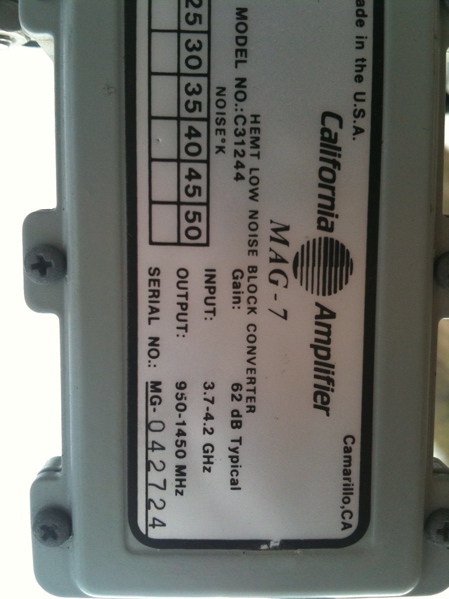

That's normal. Signal will increase as soon as Q is locked.
Best I can tell, I have the dish pointed between 177° and 178°. My elevation is set to 53°
But the satellite your trying to get is at 181.3°. (think you have to twist the mount on the pole to the west a bit) Are you sure the elevation is 53°?
That is your Latitude angle, set to your latitude. (32.6°) SEE picture I attached in my first post. The dish should be declination angle different. Set to the "Modified" declination angle on the secong chart here>>Footprints by Dish Size - Latitude Declination Chart - C/Ku-Band Satellite Listing Study the picture I posted earlier. Those are the angles to start with, with the dish at it's highest, to locate the "south sat".
NOTE_ It may be easier to measure the dish face with a straight edge vertical across it. Be aware that you may be measuring the angle opposite, I.E: satellite/dish elevation 90° from the dish face(extreme) angle.
These angles are set with the dish pushed to it's highest with the actuator, (as shown in your pic 1)
Then, pan the sky by slowly moving the mount and dish. (don't adjust the actuator) If you don't get a Q reading, slightly adjust the latitude angle, and repeat and align for max Q reading.
From this point on - never adjust the latitude angle again. It is ONLY adjusted at "true south"
Then use the actuator to find satelllites away from south. and adjust the mount "twist" (Azimuth adjustment) and actuator for max Q

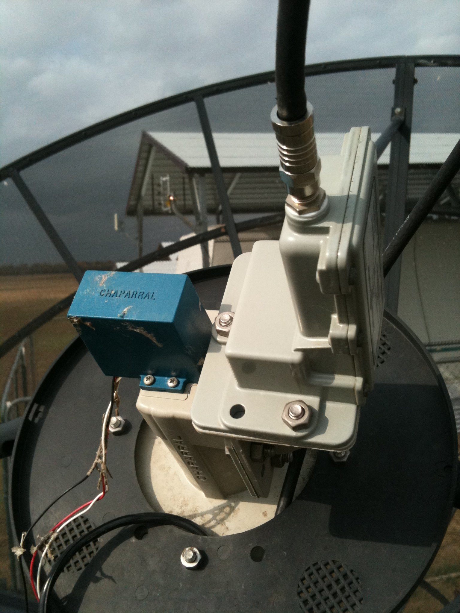

In the 3rd pic your LNB LO frequency is 5150-5750. Change it to 5150. Then go into your TP menu & add this strong TP: 3920H26000 if its not already there. That should help the peaking for due south satellite.
