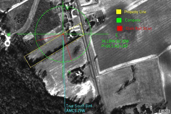

I used USGS to find out where the best place to mount would be.
